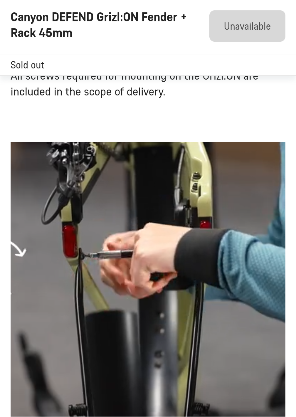

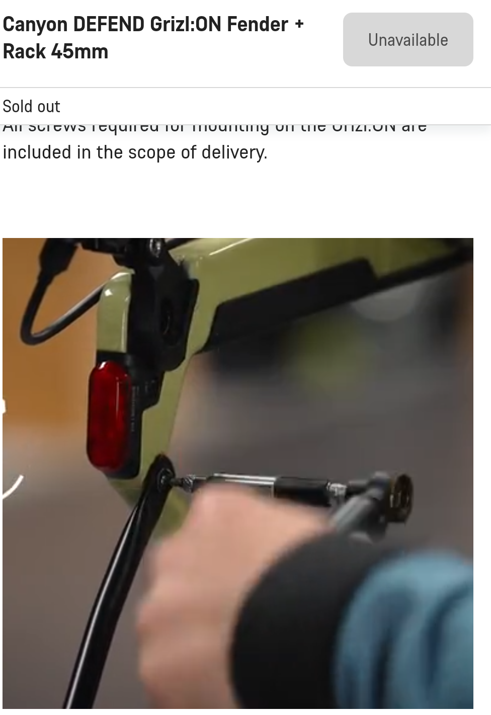

  • When shopping I kind of forgot to look at mount points. It's missing a key one: A rack mount point above the rear axle. If you want a rack, you will have to get one which uses a special replacement axle, because nothing that clamps on the frame will be allowed on carbon.
The mount points are on the inside surface of the seat stays. You can see it in the installation video for the unavailable fender/rack from Canyon.
Wow, thanks for that. I had to go straight to the garage to see. It's so obvious now that I know.
