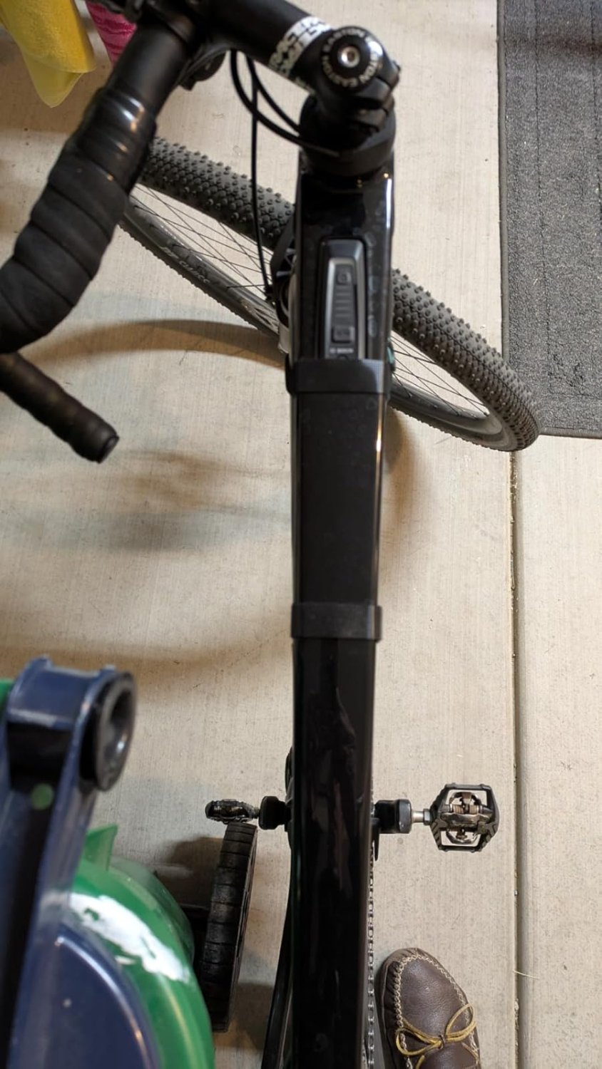

  • The top tube control is a big weakness of this system. It's just a power button and an assist button (with long press to reduce assist) plus a bar graph power display. Assist level is indicated by color. Adjusting power while riding is impractical. If you use multiple power levels during a ride, I think the mini remote (see below) is required. Compared to something like a Turbo Levo, it is absolutely primitive.

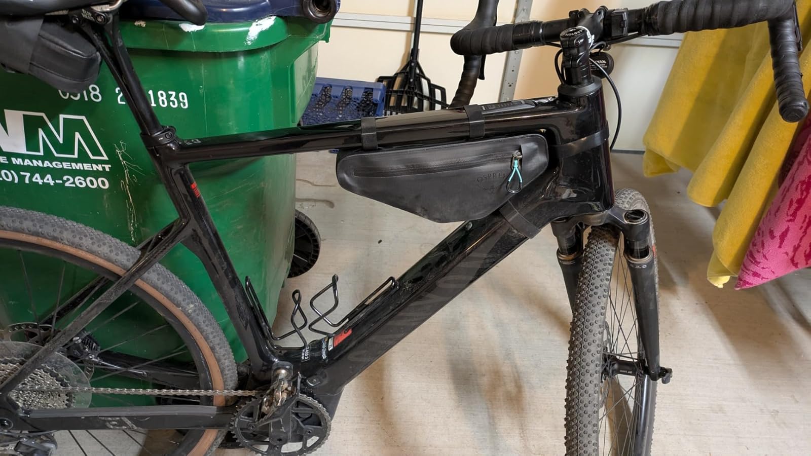

Perfect frame bag fit on a XL Grizl:On e-gravel bike.​
Osprey Escapist On-Bike Wedge Bag, Black, $60 on Amazon
I did a lot of looking for a medium size frame bag. This one is perfect for my needs.
