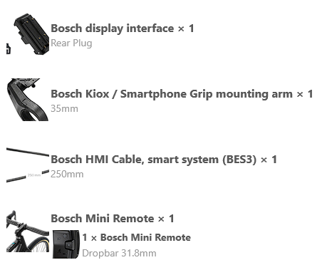

If anyone interested this is what I have on order. List of added items below.
Canyon Grizl CF9 (meduim)
Bosch 300 Kiox Display
Bosch Display interface
Bosch Kiox Mount
Bosch HMI Cable
Bosch Mini Remote

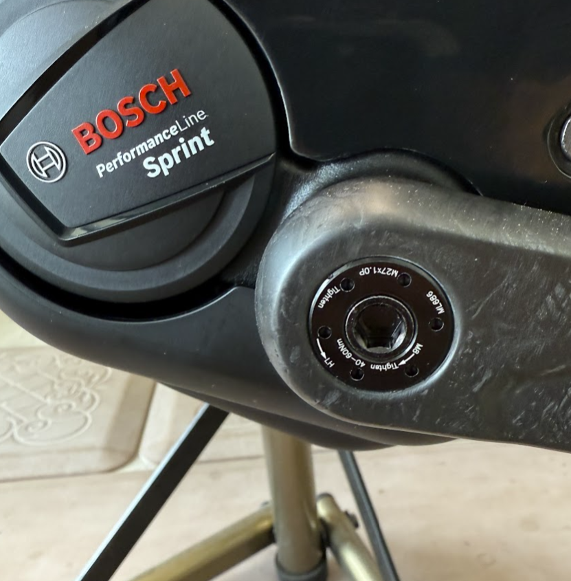

Need help to remove the crank arm. Bike shop did the first one and I am doing the swap on this bike. The cover has 6 pin holes I cannot find the tool to remove. What tool do I need to remove the FSA CRANK ARM. Part ML686
It is a long 8 mm hex wrench. You just insert the end into the socket and slowly turn it counterclockwise. It requires some force at first.
This sort of crankarms is specific to good mid-drive motors and these are called "self-extracting" cranks. To tighten, you rotate the wrench clockwise, with some effort, until the thing stops. Or, use an automotive torque wrench and tighten at 40 Nm. Please inspect the marking near to the socket (M8. Tighten in this direction. 40 Nm).

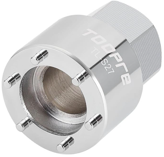

Stefan, Thanks. I found the part it was a 6 pin tool. I purchased it off Amazon. Did not need it but good to have in my tool box.

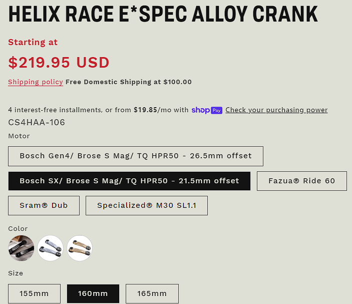

I want to share my experience with sizing and Canyon Grizl CF9. My wife is 5ft 2in (158cm) Inseam 29in (73cm) and I am 5ft 10in (178cm) Inseam 31in (79cm) tall. Smallest CF9 in US was a size XS which is her bike. I got the Medium size but I was between a Small and Medium. I adjusted both fit with crank arm length. XS Crank Arm 170mm to 155mm for her and Med 175mm to 160mm for me. We have the AXS seat droppers 50mm on the XS and 75mm on the Medium. Both fit us perfectly. Both seat posts are slammed to the frame. Touching the ground we both are on our toes when the seats are dropped. Raising the seats has our saddle heights just right.
Changing the setup 1 more time. Switching out the 75mm AXS dropper for a 50mm AXS dropper post. Swapping back to 175mm cranks. This lowered my center of gravity and the bike feels more stable. Last week did 32 miles of mostly flat pavement riding. Switching the modes and settled on Sprint mode for most of the ride. Battery was 2% at the end of the ride. Will need to get the extender for anything longer.

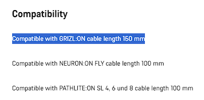

OK Canyon does not sell the Bosch PowerMore 250Wh Range Extender in the US. But it looks like I can get it from other resellers of Bosch ebikes. I don't know if the Grizl comes configured to allow the range extender in US. Will have to contact Canyon.
OK parts are ordered.
Bosch PowerMore 250 (BBP3620)
Bosch PowerMore cable (BCH3923 150mm length)
It shouldn't need to - since they advertise it as an option (but dont sell it in this market) - that indicates the flag is set to allow it in the factory config.
