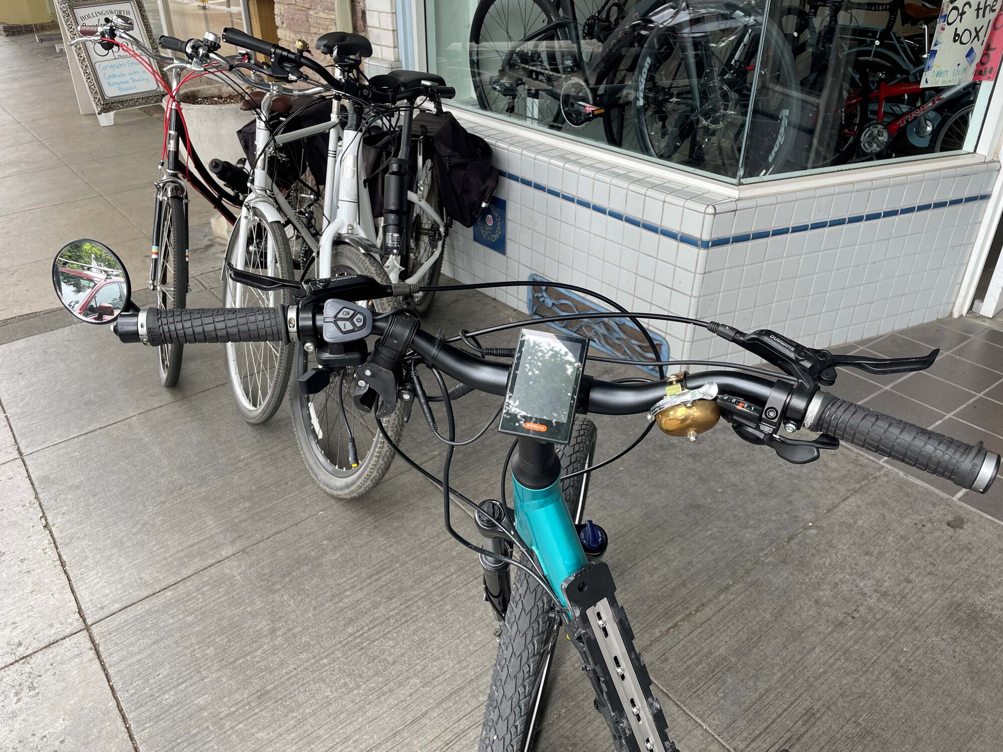

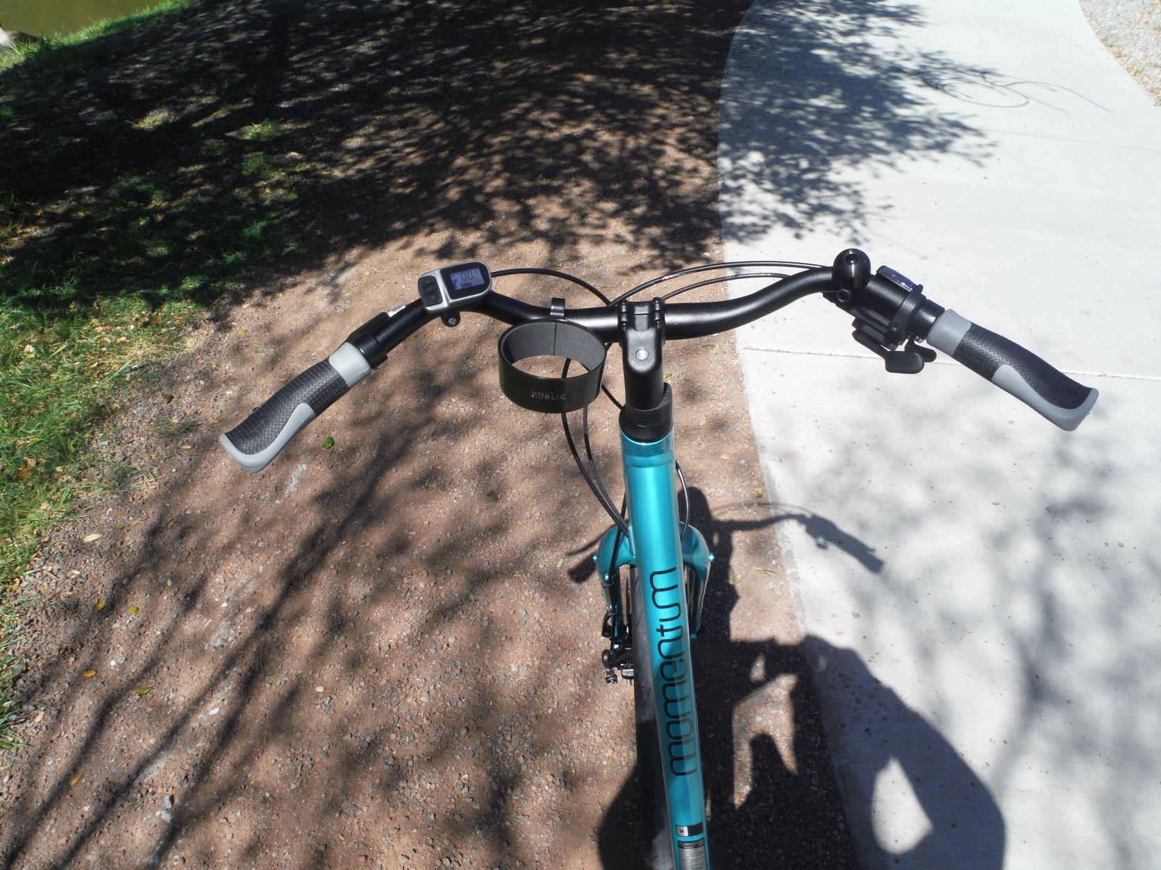

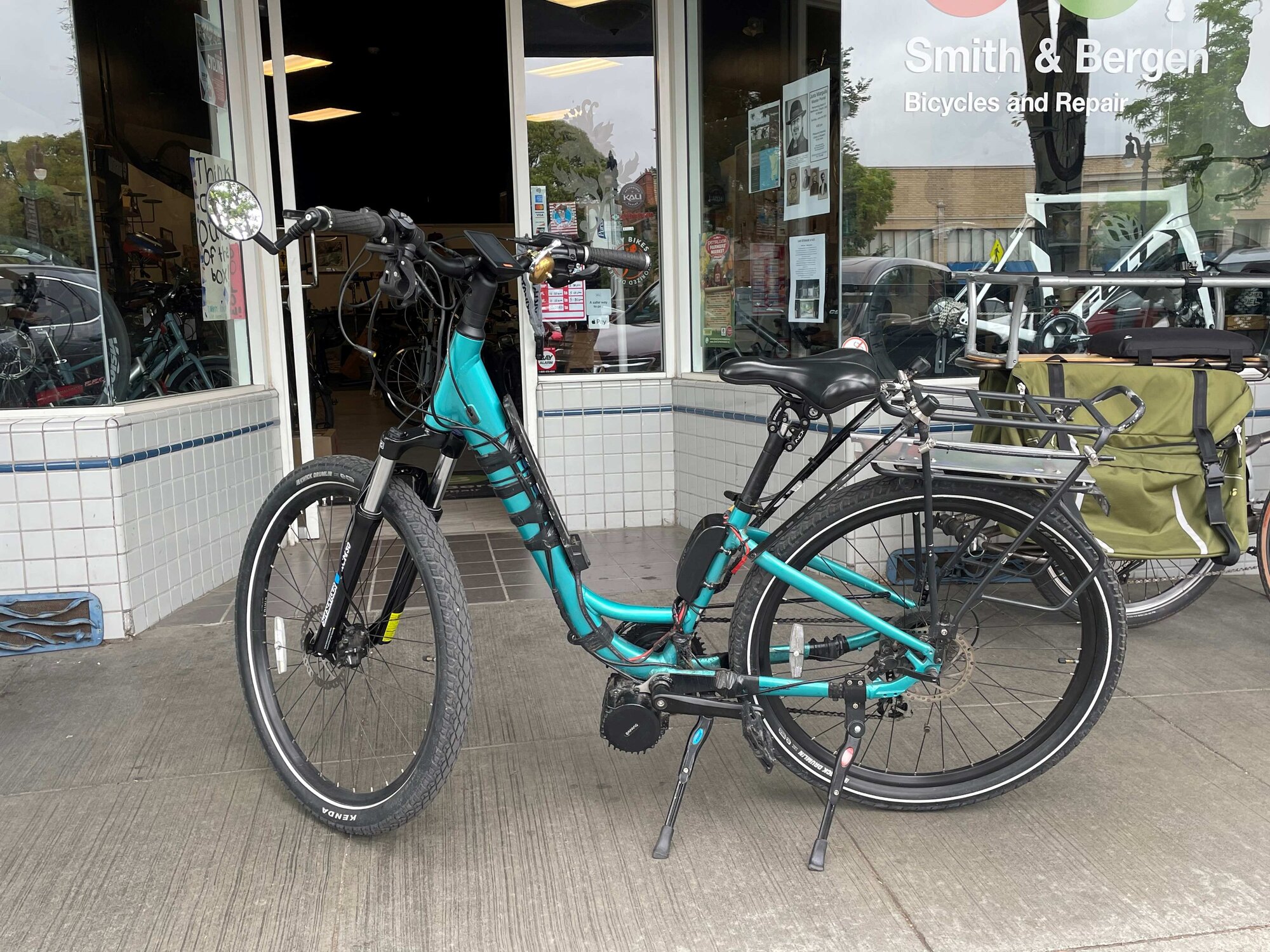

These bikes could almost work as a compact cargo. I like the 27.5 wheels for a smooth ride and stability. Zoom the wires. They are both conversions of S/M teal Giant Vidas.

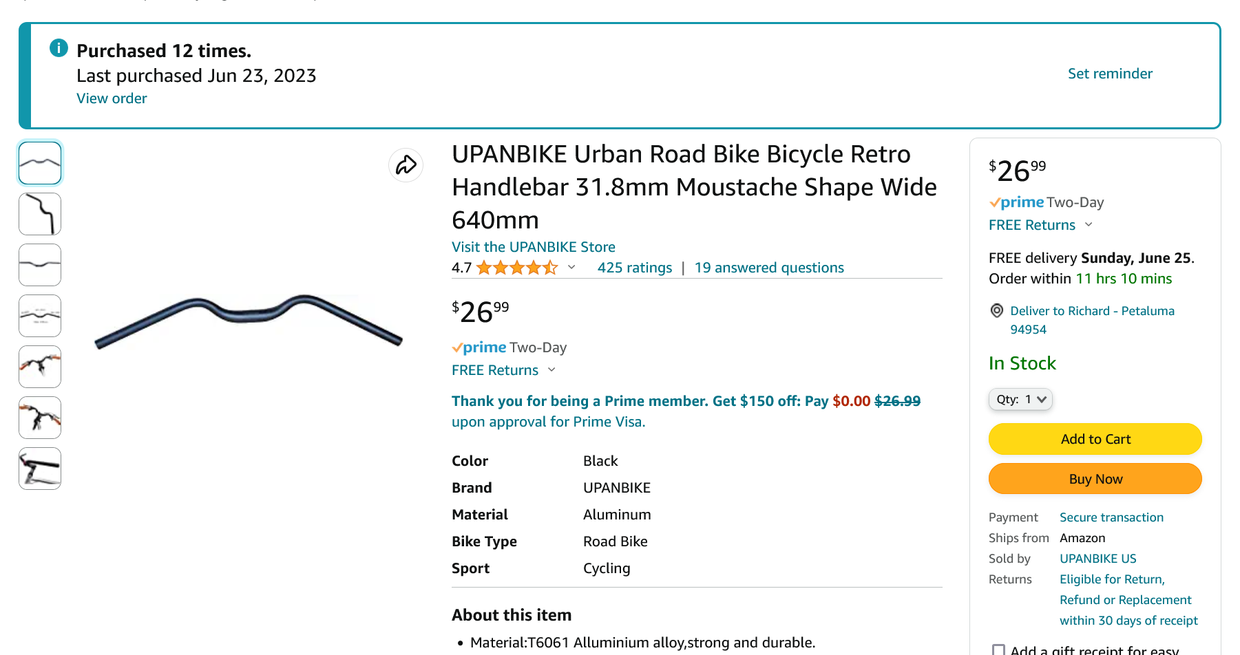

1) Handlebar- its a nearly straight mtn bike handlebar and 28" long. Way too wide for me. Hard to find a black 31.8mm clamp diameter swept back handlebar that is around 540mm wide. Found 1 black and 1 chrome that are 25.4mm and ordered spacers.
2) Can't raise(or lower) the height of the handlebars- Its fixed! This was the biggest surprise as all my other bikes were adjustable. There are very few Short Haul reviews/videos but none mention that the handlebar height is fixed, even on the Tern site. Is it better to replace the fixed stem with an adjustable stem or use a stem riser? I just learned about stem risers, can I use a stem riser on this bike?
Since you're getting new handlebars I would start with bars that have more lift. I would hope that risers would work on the Tern and so would an adjustable stem, though it would be prefered to use a fixed stem with a higher angle. Maybe a rise in the handlebar bend would be high enough to make you comfortable. How high do you want to go?

Yes, I think swept back handlebars with a bit of lift might be high enough but again, I was just surprised. This is my first bike where the handlebar height is not adjustable.
