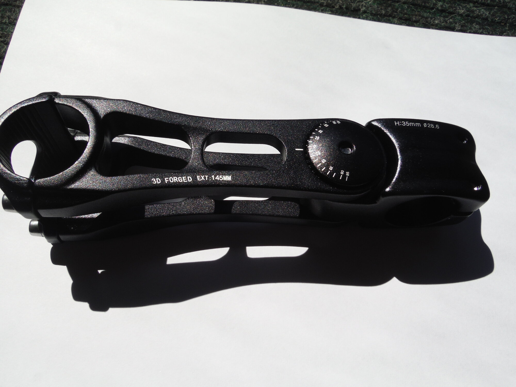

I had an adjustment stem on my ebike and it started creaking, so I replaced it with riser bars and an angled stem.
If you don't need to be adjusting your angle once it is set, a stem riser is a stronger option.
The only advantage to adjustable is if you are not sure about the best geometry for you. And so you want to try different configurations to see what works best. Some are better than others.
That's true.

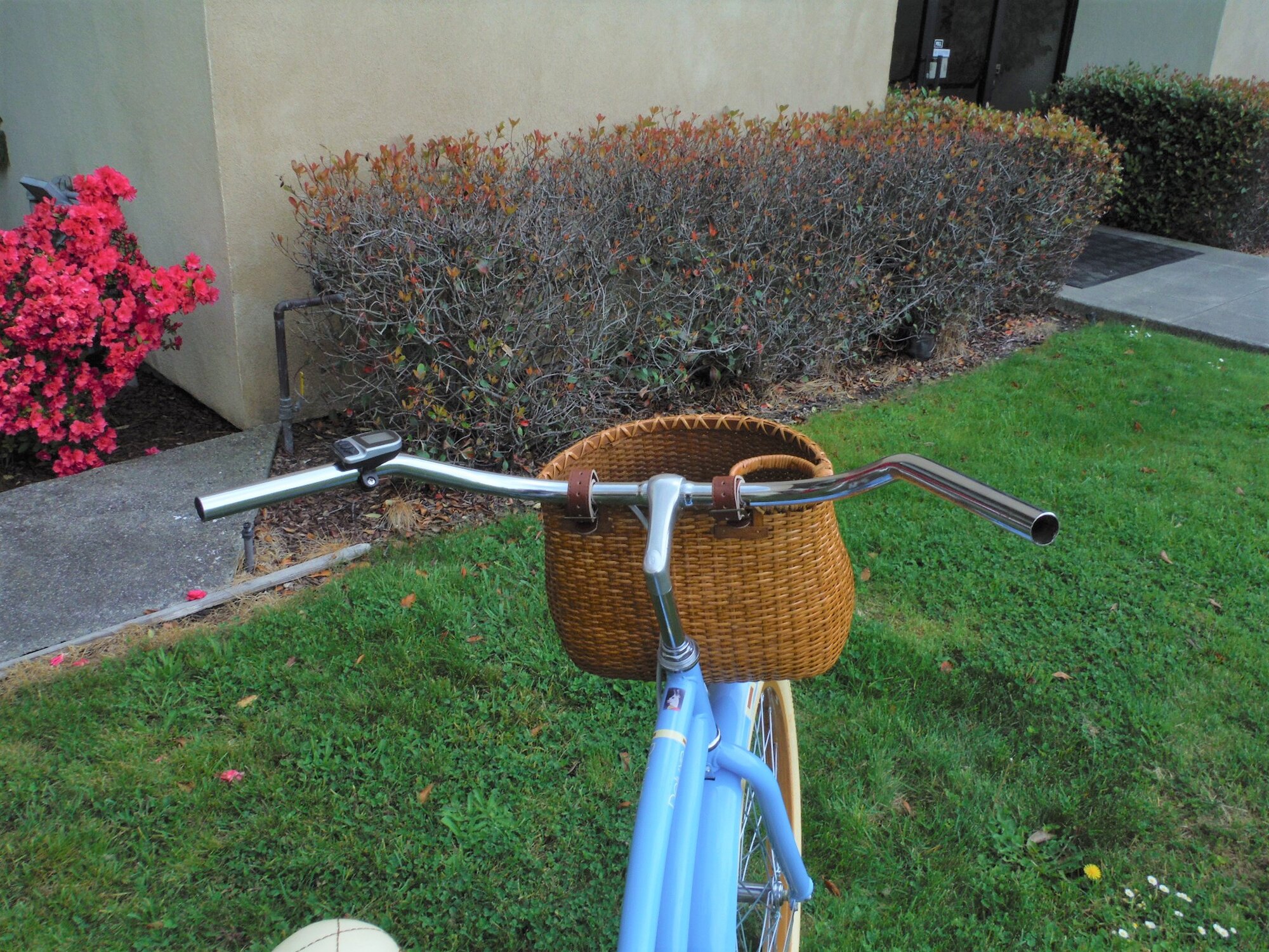

When I bought my new handlebars and stem, I sat on my ebike and held my hands out in front of me to where it thought that I'd like my grips to be.
Then I got out the tape measure and tried to measure everything which was pretty difficult with all the angles going on. 😂
It worked out good for me though and I'm sitting up perfectly straight.
I did everything bass ackwards though and my e-bike looks kinda stupid.
I should have went with a stem riser and those handlebars that you posted.

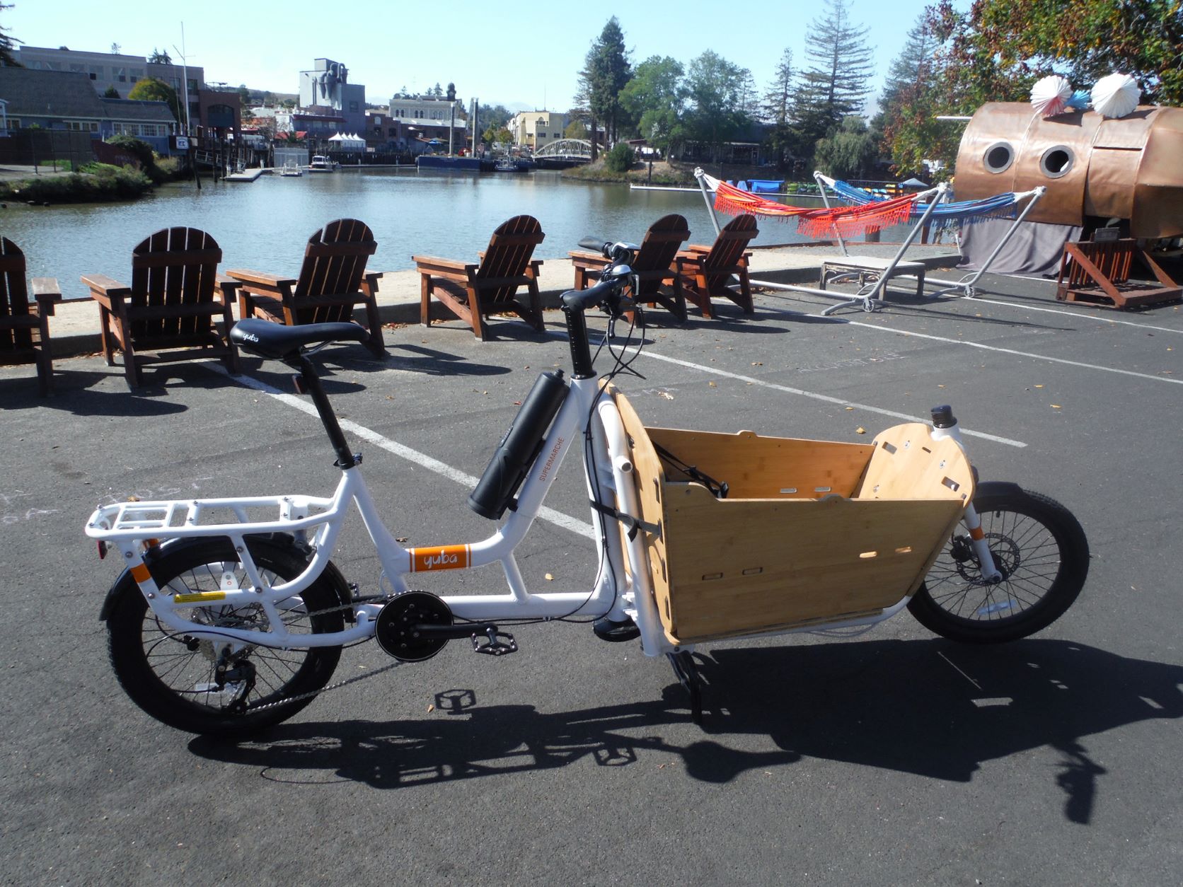

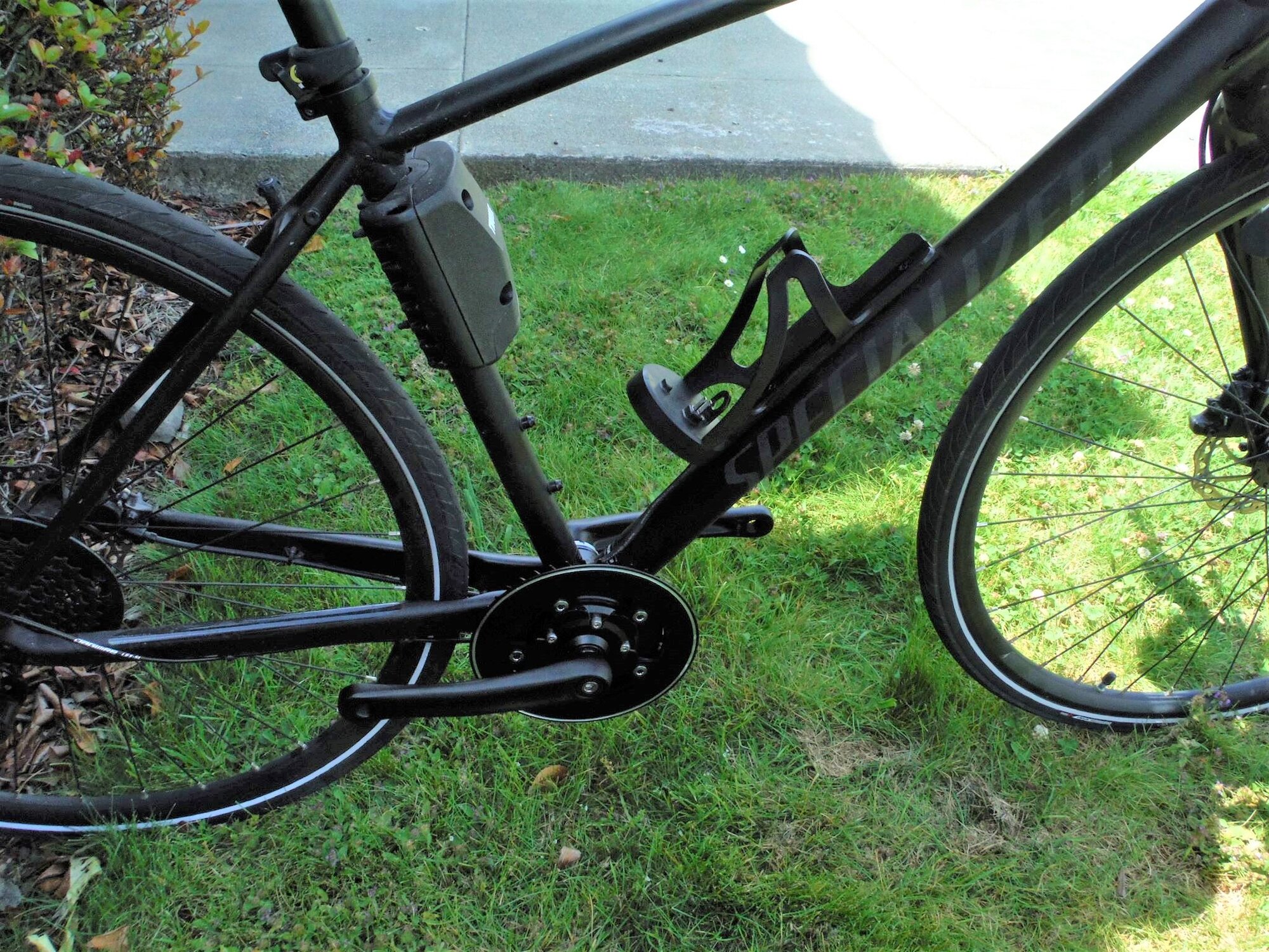

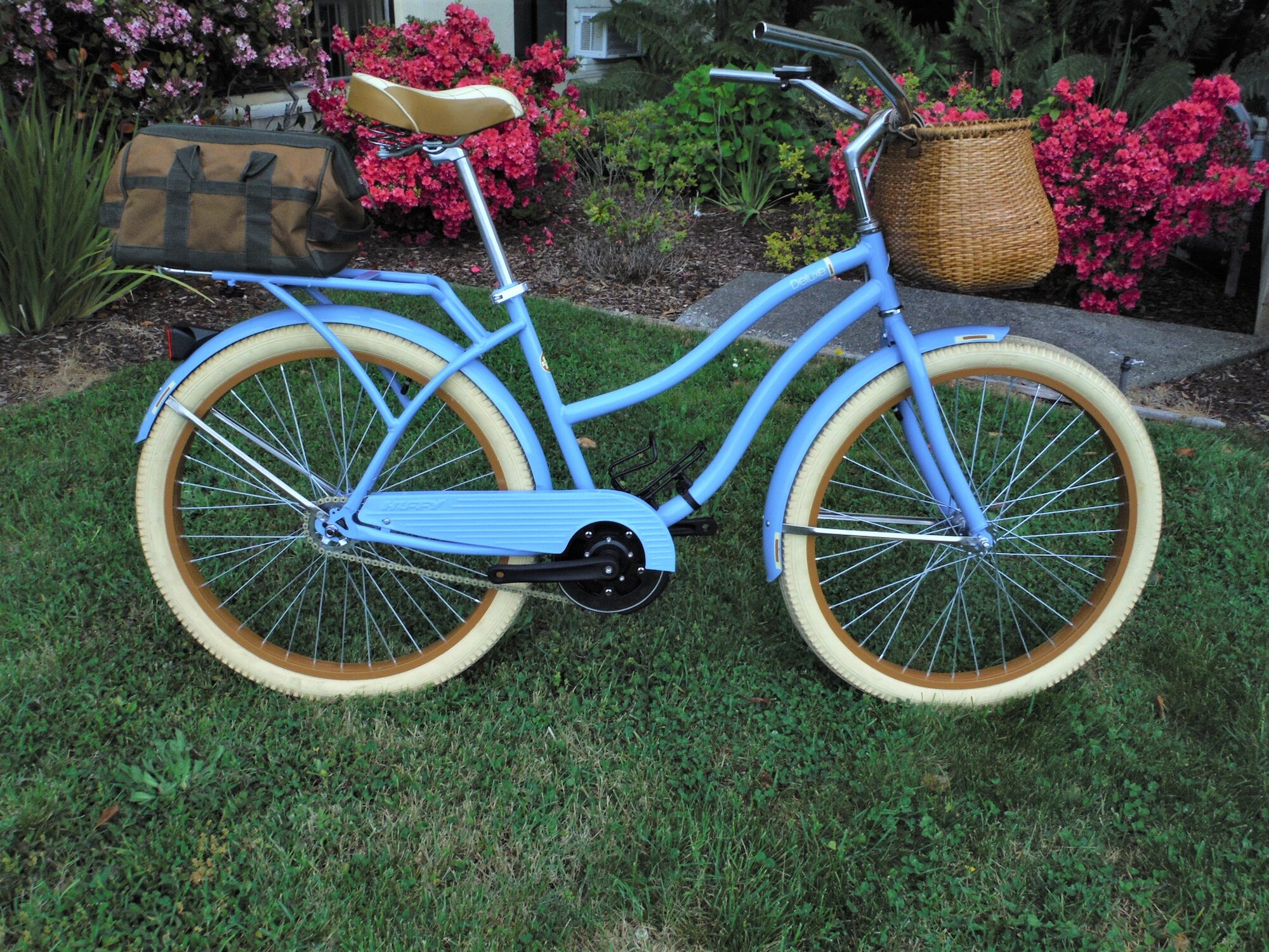

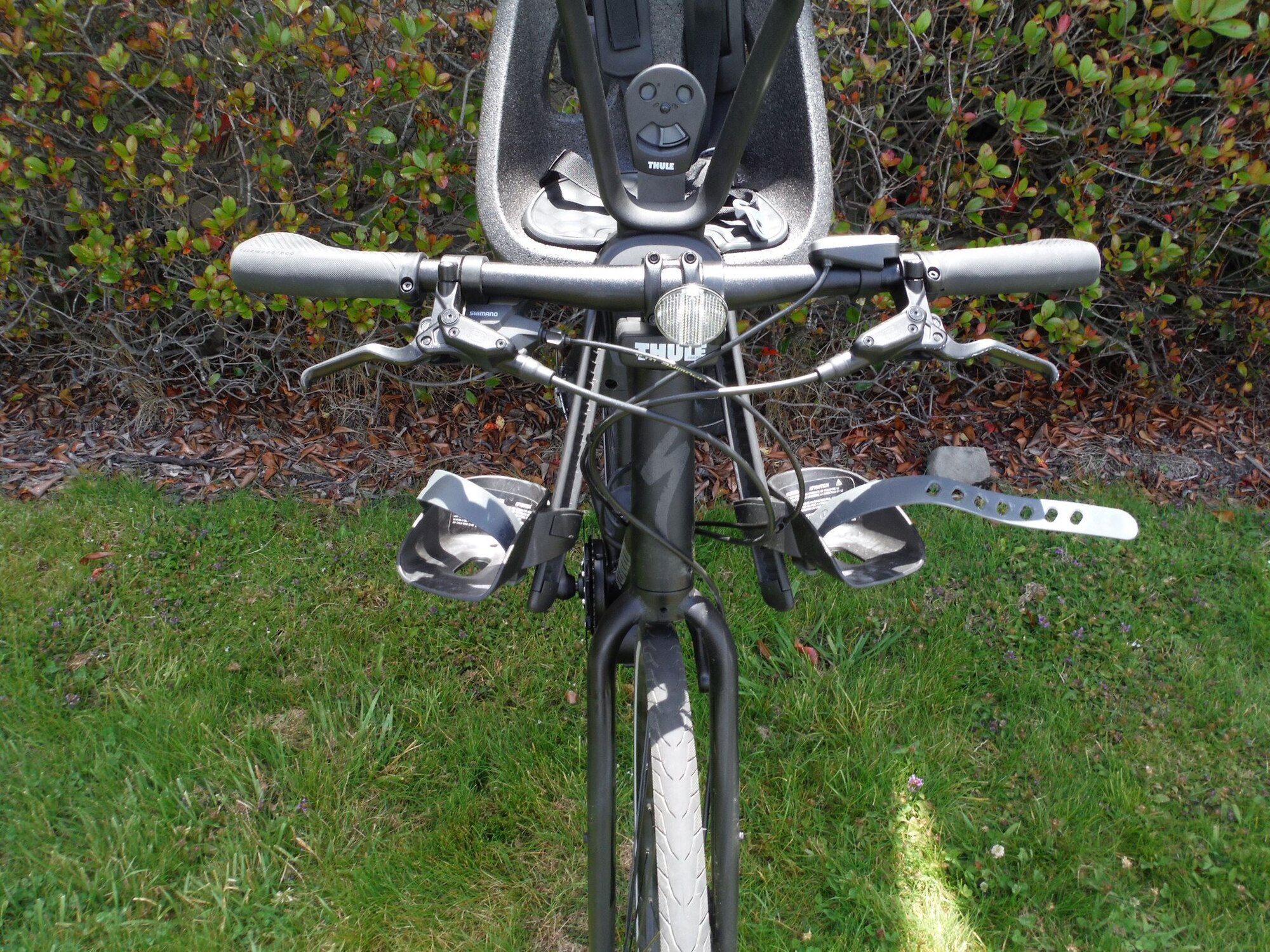

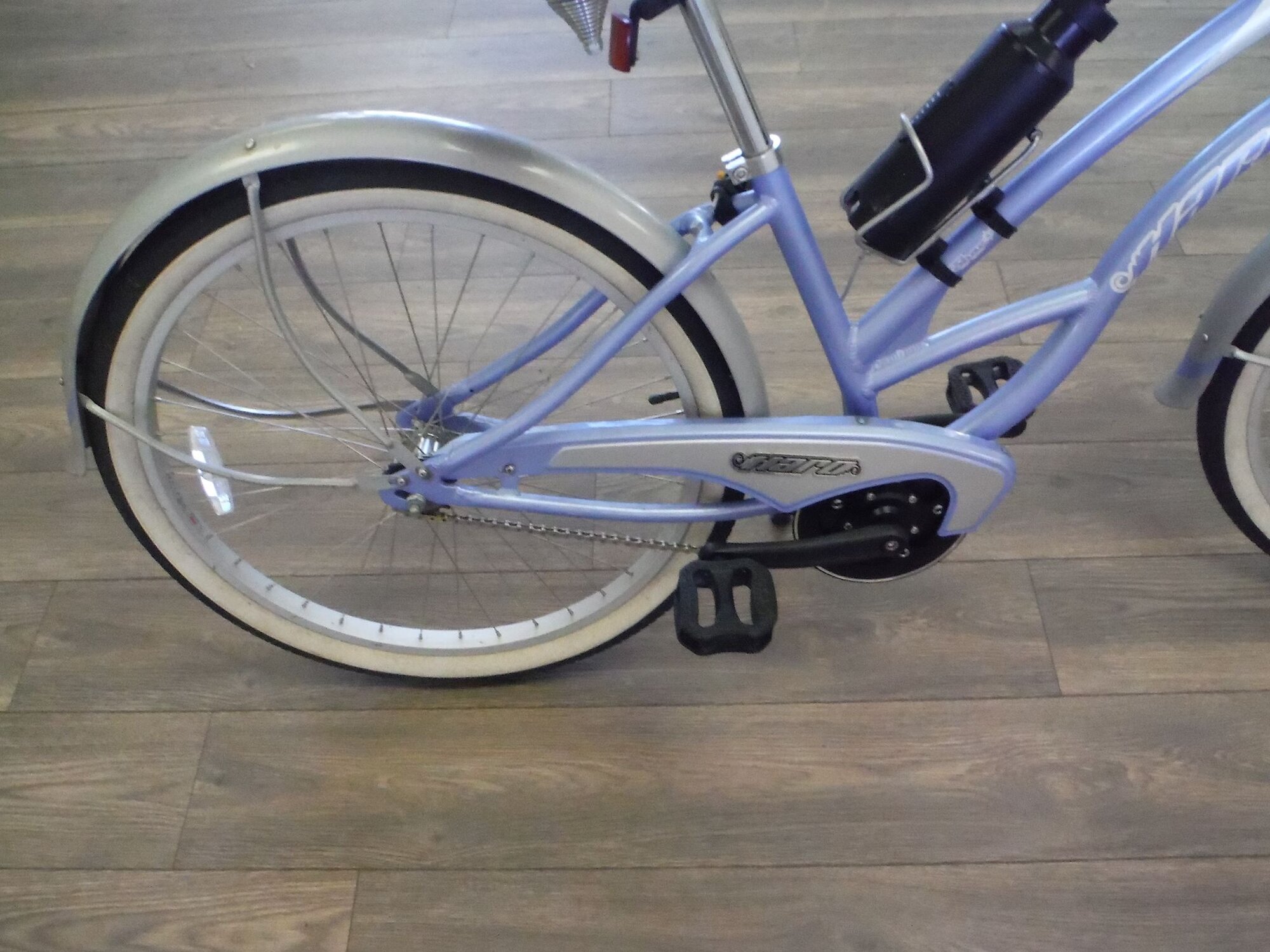

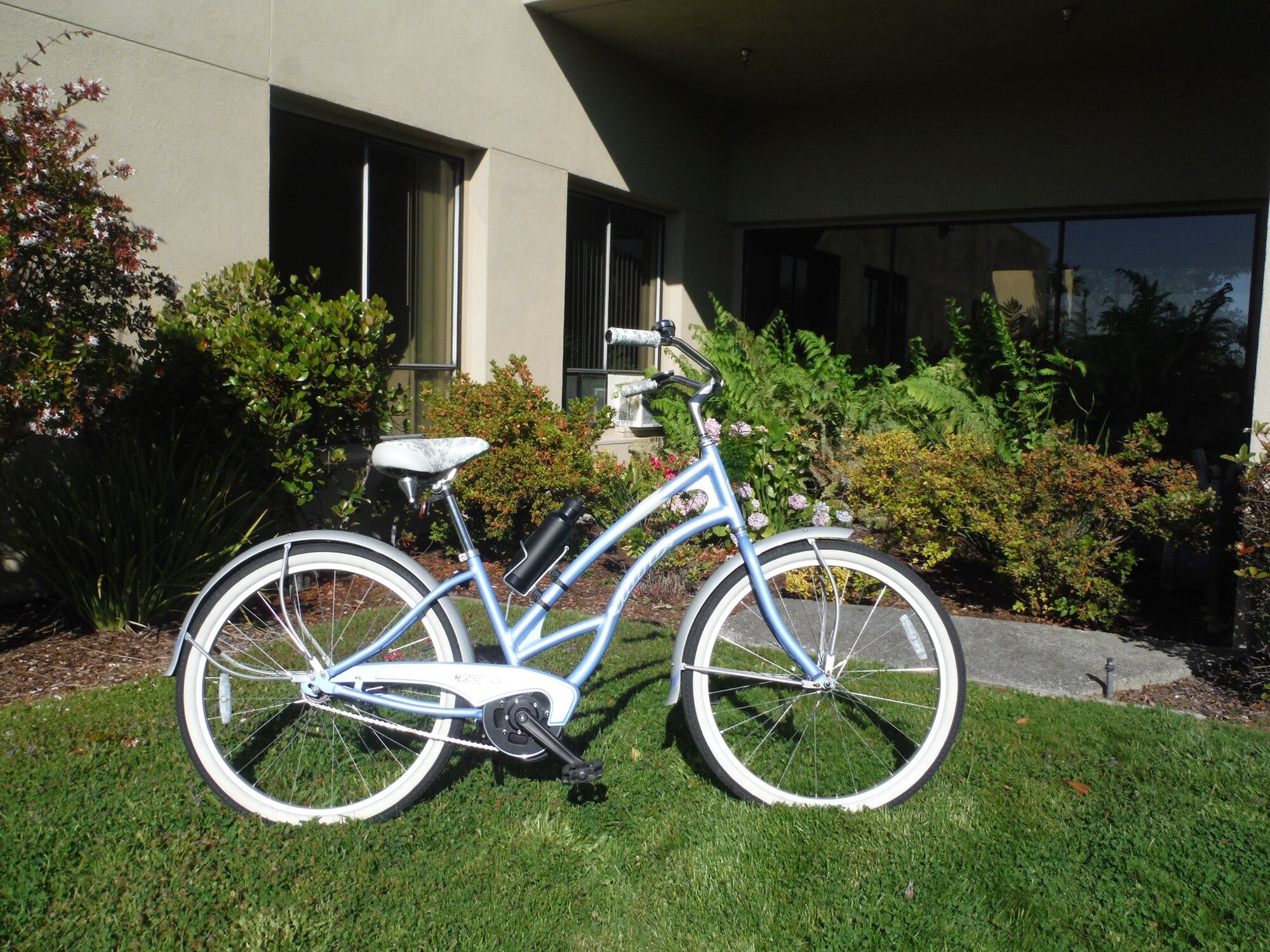

Since we are posting photos here is the bike I made electric yesterday. And then the review she wrote this morning. She was an avid cyclist in the Sacramento (flat) area. She married a CHP officer after he graduated the academy there. And he was transferred here where we have big hills. Then she had two babies in a row. For now she can take the kids on her bike but soon she will need a trailer. That is why I used a powerful cargo motor. The odd blob on the seat tube is for the rear kid seat. Her battery goes in the water bottle cage. Zip tie free is like skinny dipping.

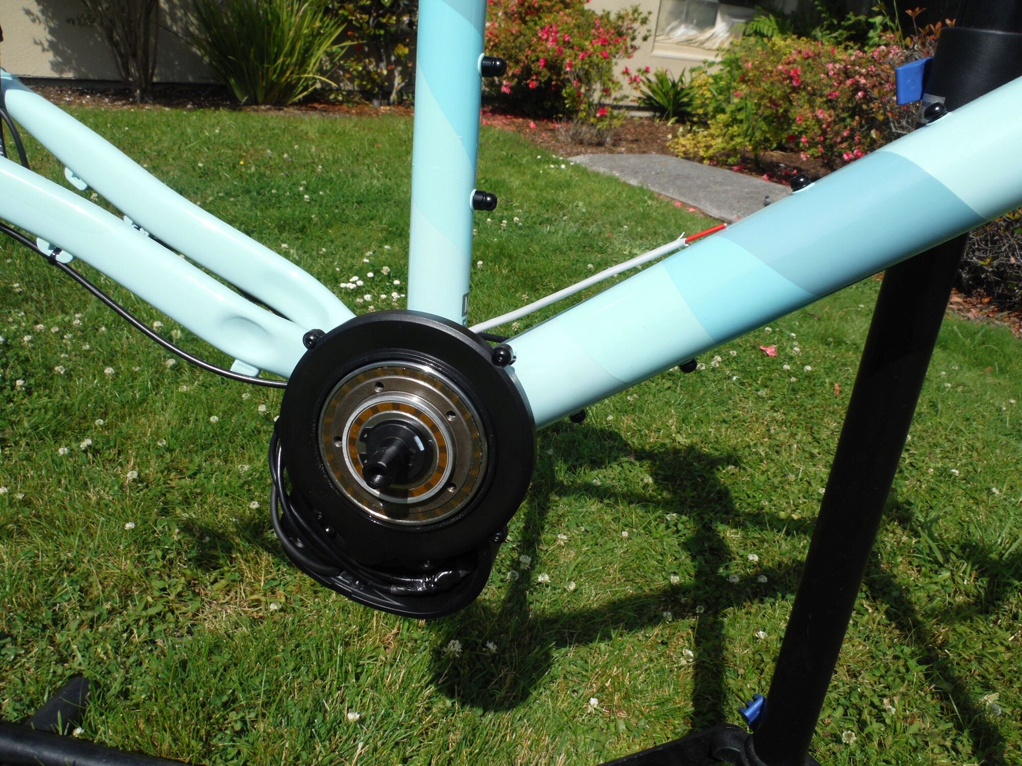

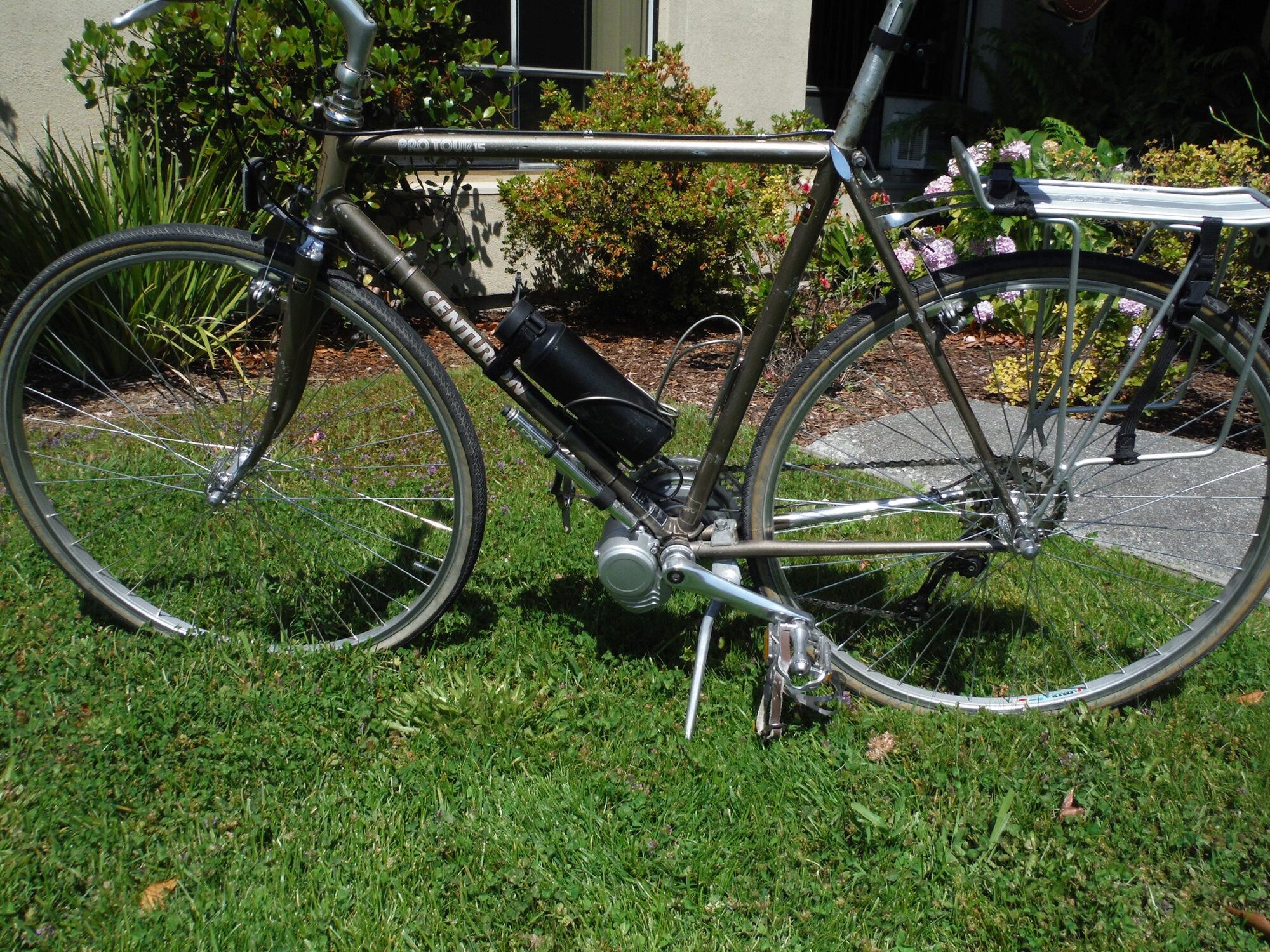

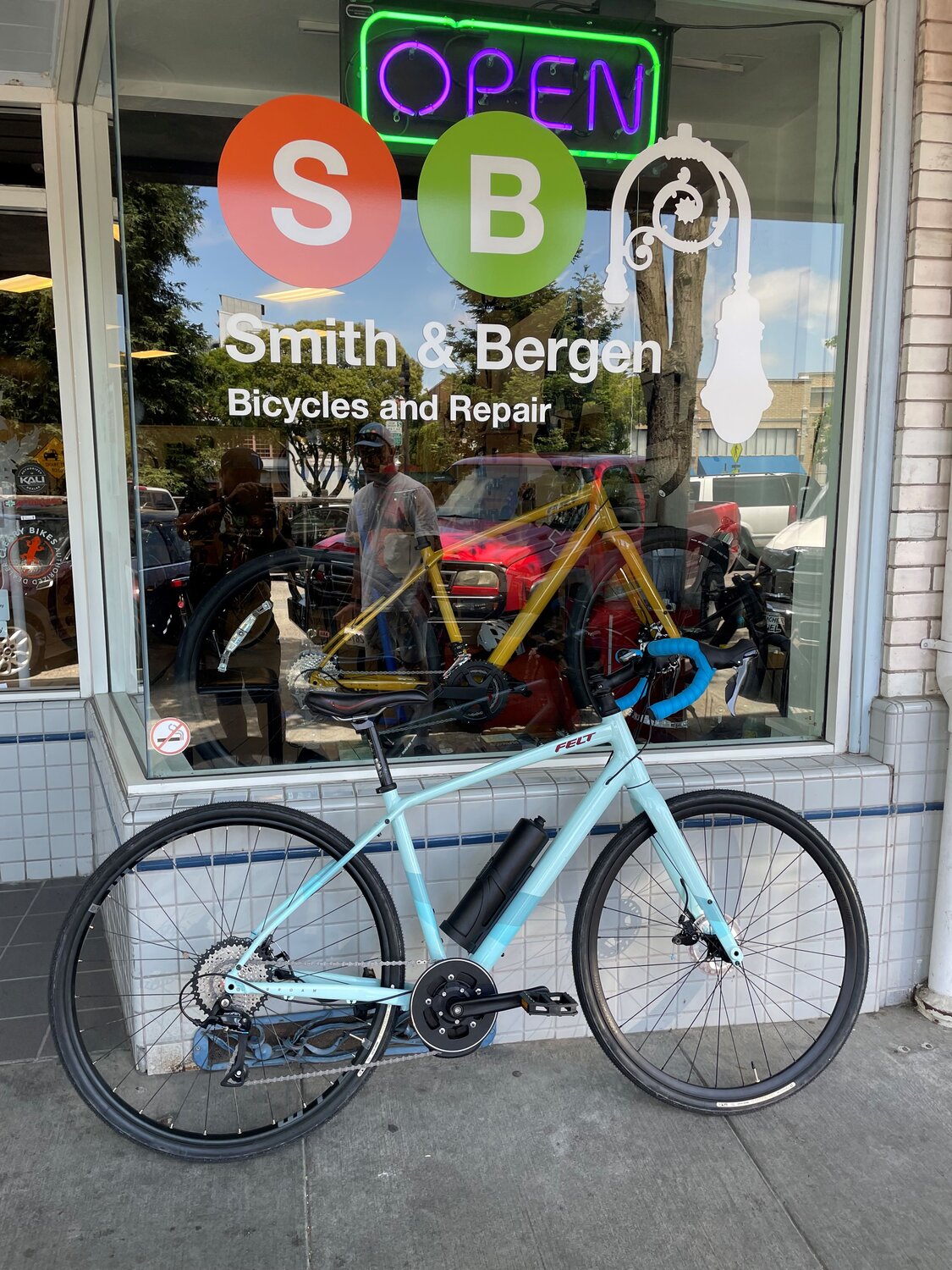

What is the cargo motor you installed?
TSDZ2-B. Like this one that I rode for the first time today. 90Nm. This one has the torque sensor and a throttle but with no ugly connections or extra wires and it has a throttle. It is the only bike like it. That is a clean handlebar. I soldered thru-frame.

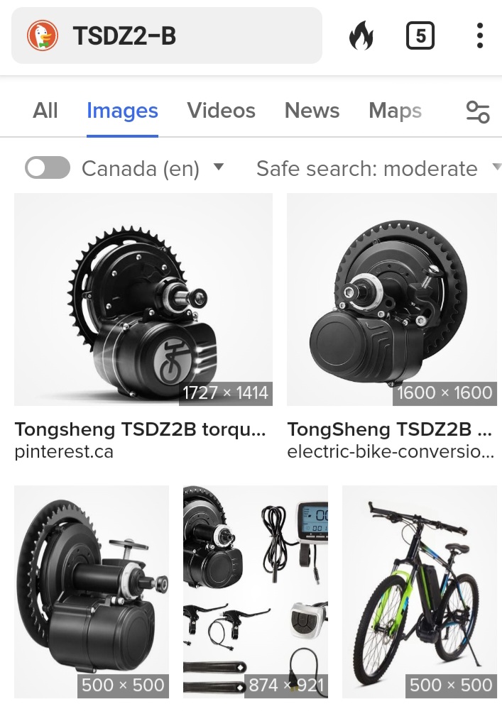

You're cheating !!!
I see no motor on that bike ?
I had to Google it.
I want to see that picture with the right handlebar leaning against the window. 😂

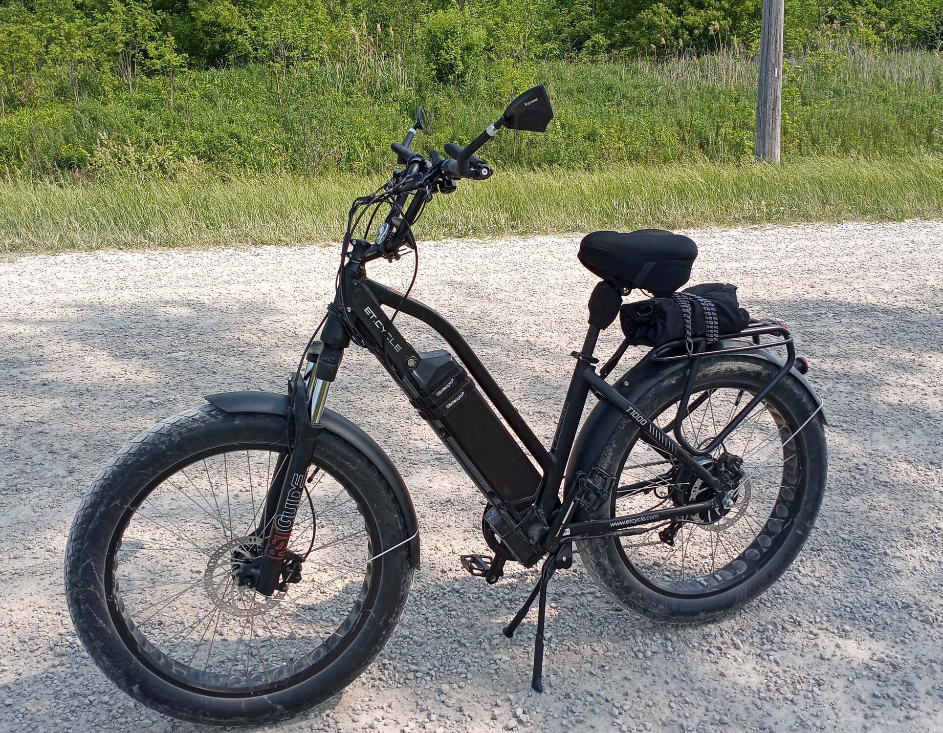

Interestingly,.. my bike has only 60 NM and weighs 90 pounds with the accessories and tools.
I wonder how our bikes compare?
We should trade bikes for a week.
I dunno??
That motor sounds a little delicate to me?
If you're OK with me breaking your Tongsheng motor, I'm OK with you breaking my Das-Kit motor.
The older versions have problems when you don't lube the tranny. That gray wire is in the process of being run to the battery. The light gray blends in nicely with the frame color. That wire is actually two tone because it is black on the underside and where it enters the motor housing. Because these motors pull chain thru the gears they are highly efficient.

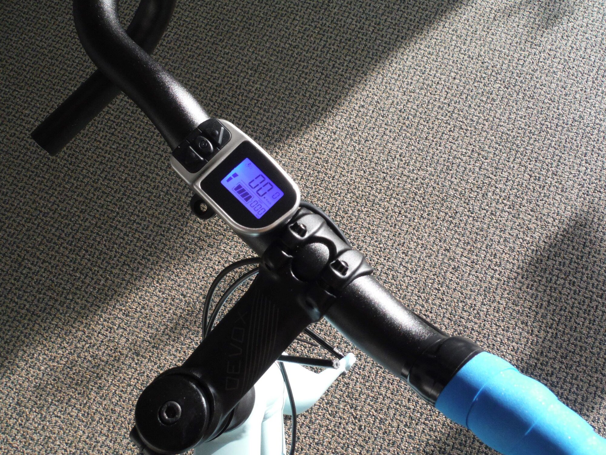

I am a big fat cheater. I admit it. In that last picture, if you zoom to the middle of the handlebar you will see a gray wire headed inside the handlebar to the display on the left. I can only be so sneaky. But I still mostly get away with it. It is so fun to blast past guys in spandex shorts on a bike that does not look electric. Come visit the alternate CA and we will go for a ride. At 4 PM today I had to dress for Canadian Thanksgiving. A 10C fog bank rolled in. The nights are too cold for mosquitos. They don't stand a chance.

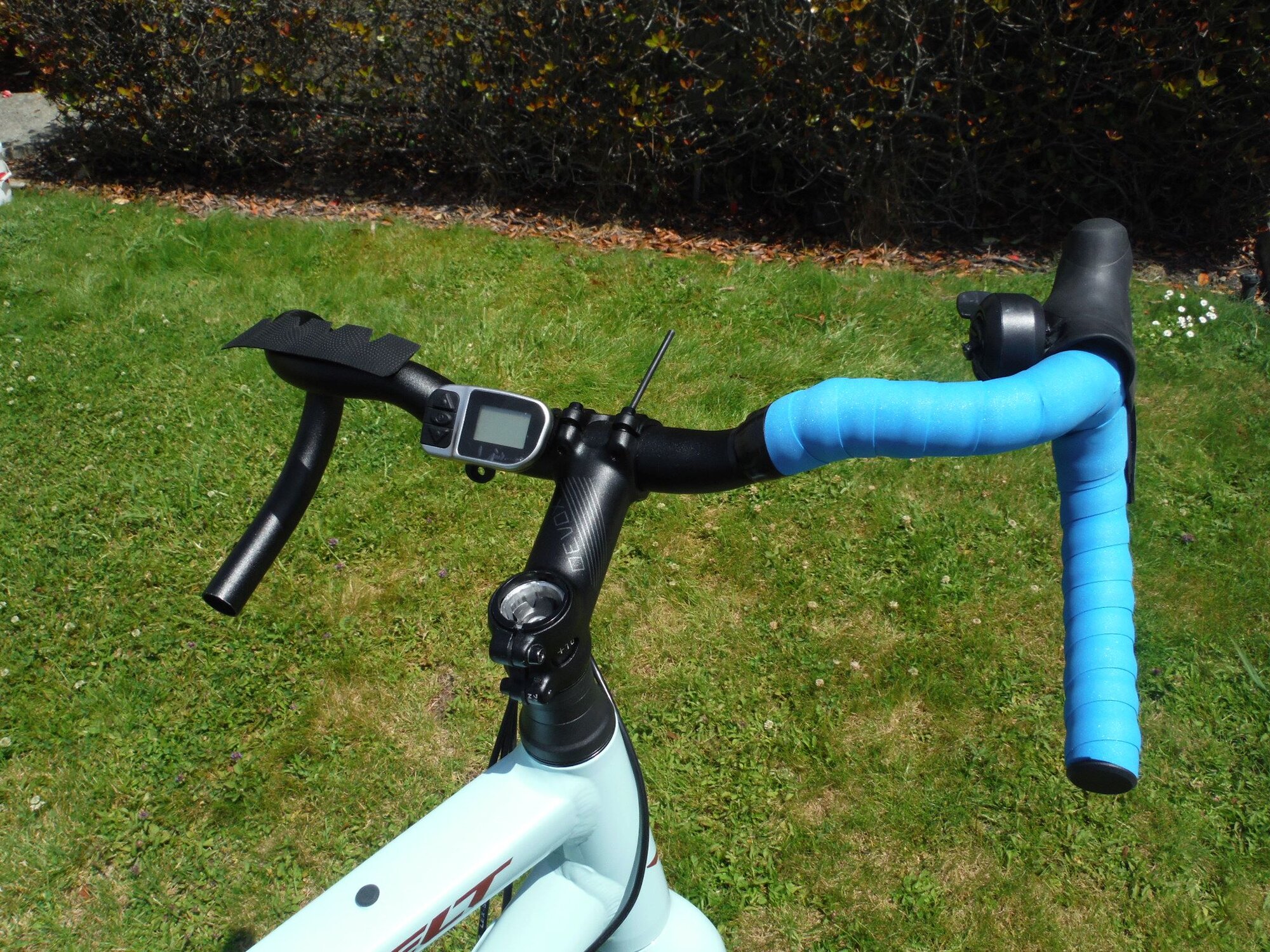

Wow! Where is the throttle? And what size battery is that?
The throttle is on the inside of the right shift hood. That is a custom made battery in an aluminum housing. It has super premium cells and a super premium battery management chip that talks to the charger and can charge to 90% for long service live. It is 48V 7Ah or can get a 48V 10.5 for longer rides. Some opt for two batteries of different sizes depending on the ride of the day.

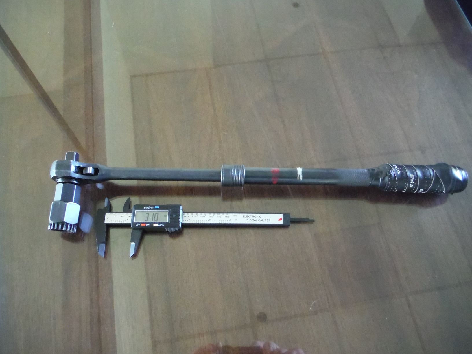

You will need a bottom bracket socket. I use an 18 inch extendable breaker bar ratchet from Tractor Supply. It was cheap to buy and I have used it every day for 6 years. One important item is blue thread lock. Put it on everything that fastens. But not on the square taper.
Please forgive my ignorance but is the bottom bracket socket the same as bottom bracket tool or bottom bracket remover? Can you link or recommend a specific bottom bracket socket? I will check my local Harbor Freight for an extendable breaker bar. 3/8" or 1/2" breaker bar?
