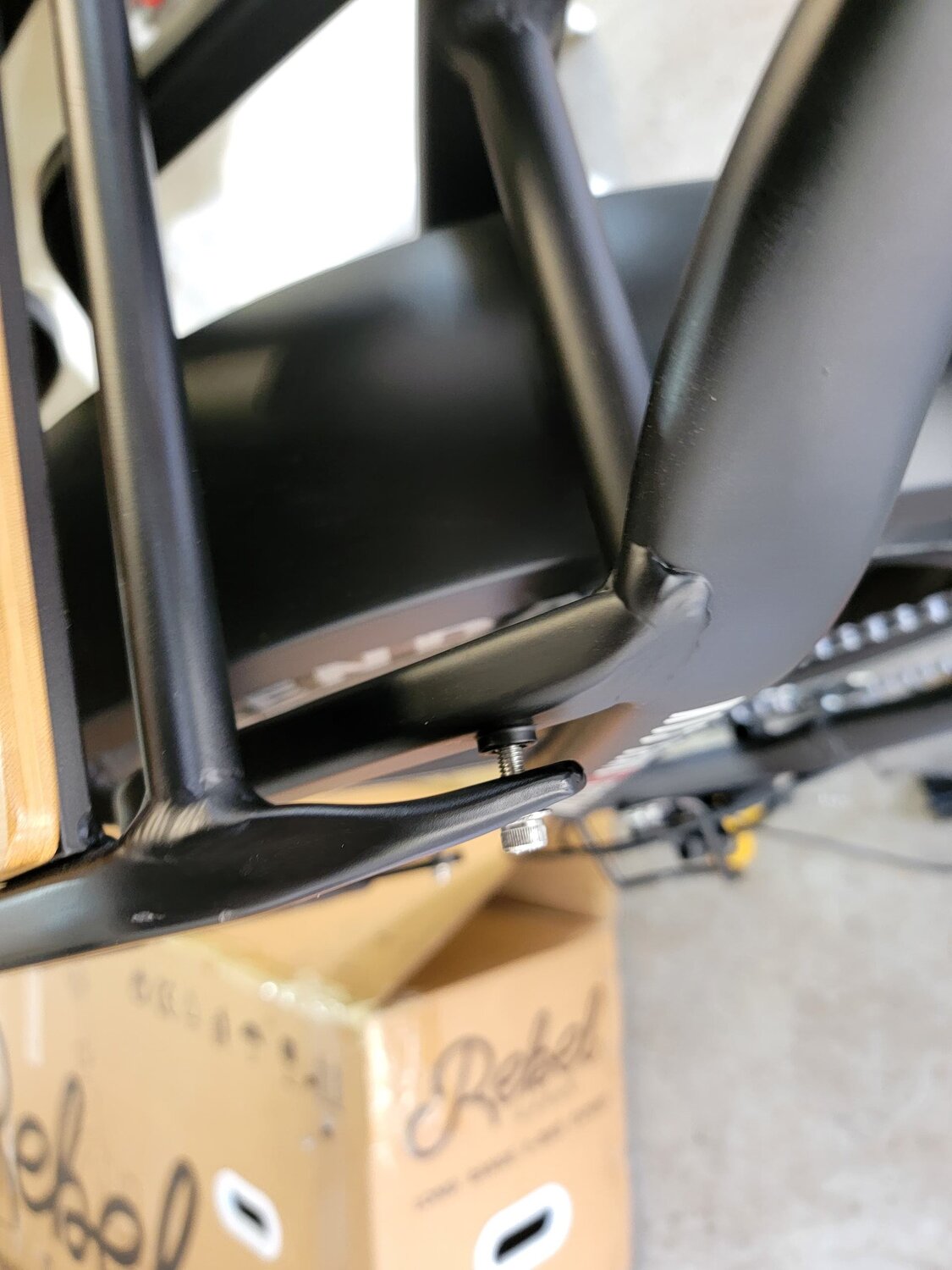

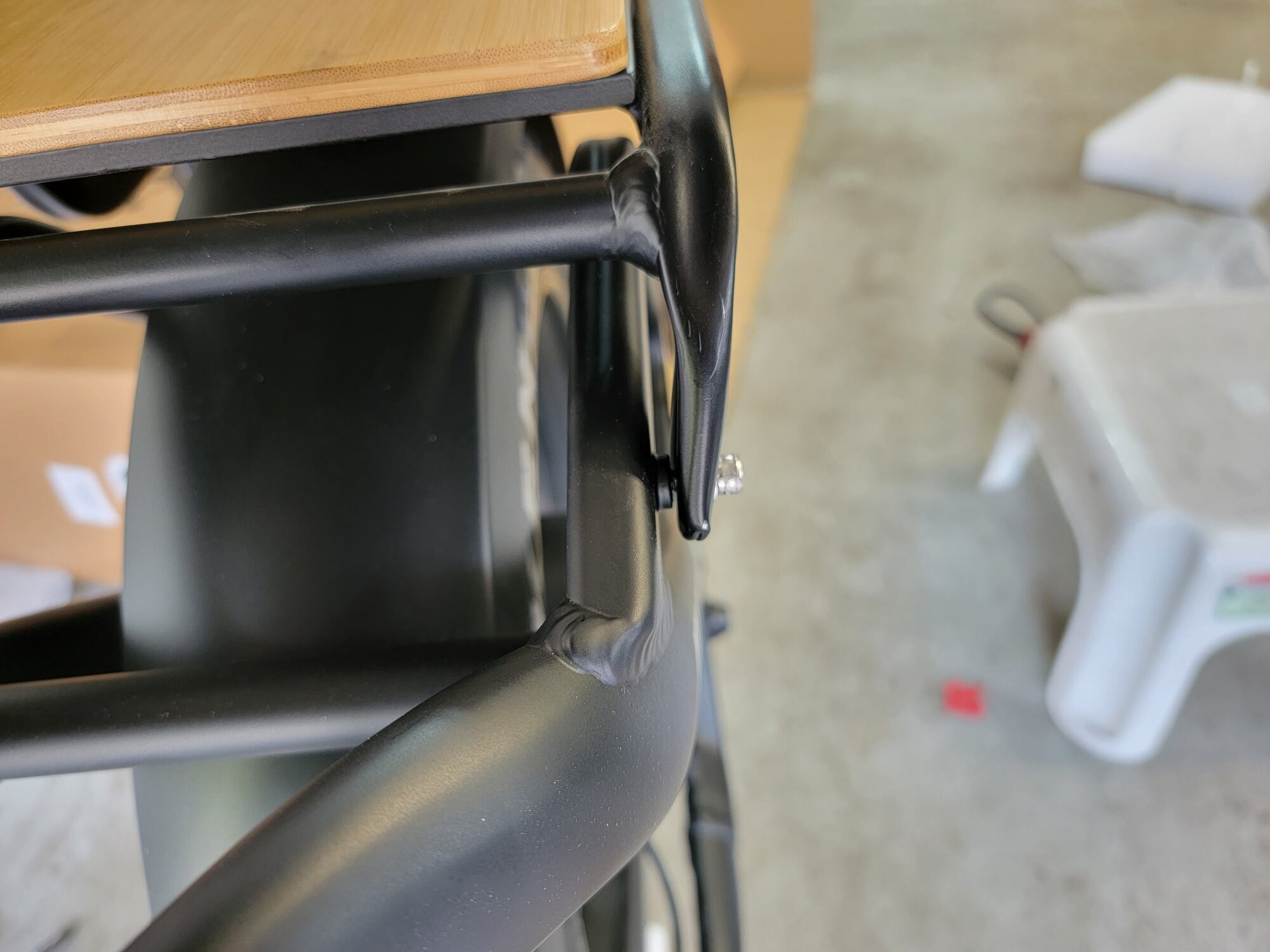

  • Cargo rack mounts were misaligned - the top mount was off by 6-7mm from the mount. This rack is VERY stiff and you will strip the threads in the aluminum frame if you try to just torque it in from one side.(See photos)
    • a. Was told this was normal and it's a "self-assembly related" issue
    • I managed to torque the bolts in after loosening both sides and repeatedly alternated between torquing both sides in. I was very uncomfortable with how much torque I was subjecting the aluminum frame threads to...this rack is NOT coming off anytime soon.

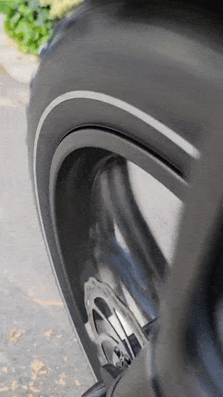

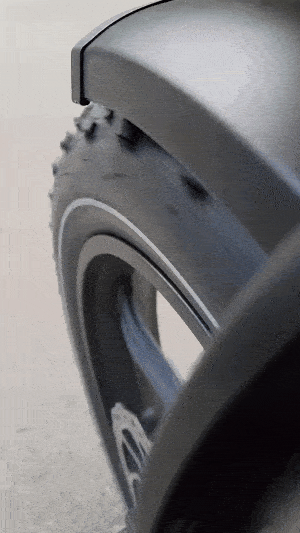

  • The tire was out of round (improperly mounted) on the rim. At higher speeds the bike would start shaking.
    • a. Was told to re-seat the tire which I was already planning on doing
    • Took a couple of tries and finally reseated the tires with minimal wobble - seems to me like the tire bead is just so ever slightly bigger than where it seats to the rim - This is the first fat tire I've dealt with so I don't know if this would be normal. The tire reseat worked and the high speed shake that the bike had is now gone – thank goodness!
