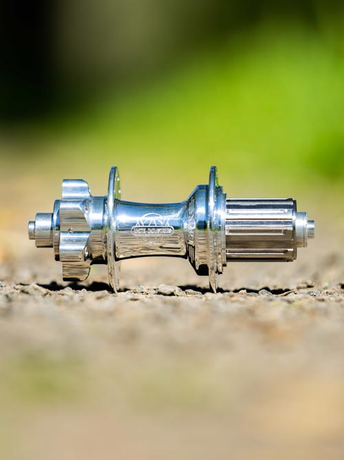

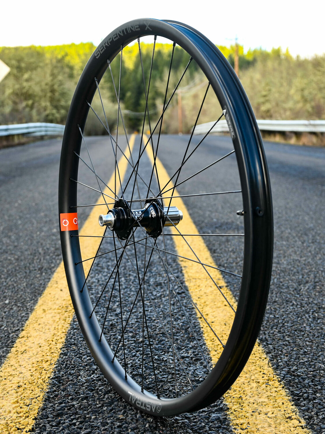

- First, you need a good hub. Ordering a DT Swiss 350, 12x148 mm, IS (6 bolts) mount for disk brake rotor and a freehub for a 11-speed Shimano cassette was the easiest thing. Even the price I got was good!

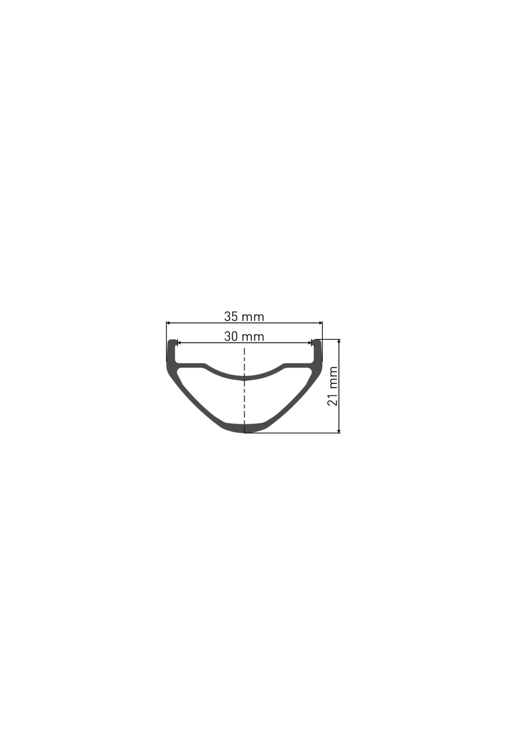

- Second, I needed the rim. Yes, DT Swiss make a 32-hole, 622 mm nominal, 150 kg system weight, ASTM 4 rated rim of the outer width of 35 mm and of inner width of 25 (not 27!) mm that could be found. Do you think it is easy to actually order such a rim? It is not.

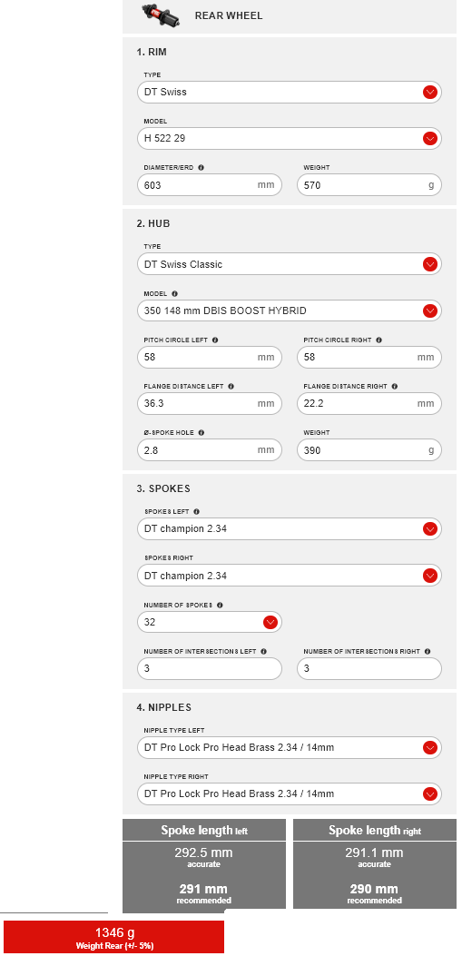

- Then, there are the spokes and the nipples. There are at least 3 different calculators for the spoke length, including the DT Swiss own. Having determined the correct spoke length (and knowing the model from the mechanic) as well as selecting the nipples in advance (!!!), I could start ordering spokes and nipples. What a bad surprise! DT Swiss sells spokes by one hundred pack, and as you need two different lengths, you need as many as two packs for a single wheel! (The cost is growing exponentially...) Sapim sells spokes in smaller quantities. Anyway, you need to become a spoke & nipple expert...
