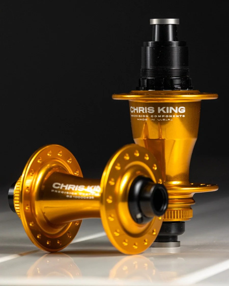

450.00 hub
You could put it on a gold chain around your neck when you rap. Its rockin' that bling thing.
not sure what that is the hub is twice that cost
I think that is just the pretty outside and not the actual hub.

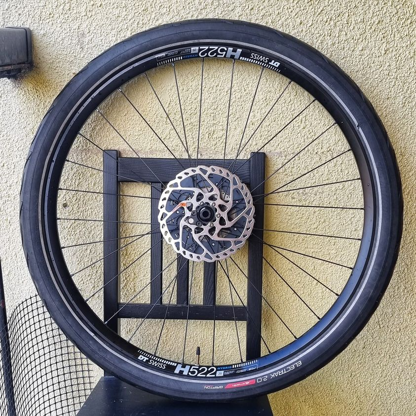

I could see my DT Swiss rear wheel built by the local mechanic. How beautifully it looked! The mechanic used 2.0 mm DT Swiss spokes (I regret I did not take any picture). Now, my Vado is in the shop for moving the brake rotor and the cassette onto the new wheel, and for the final dishing and trueing. I will report how it went when I get my e-bike back!

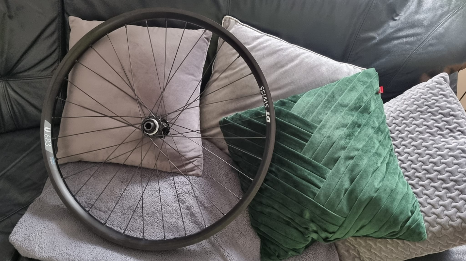

Meanwhile, my brother has built both DT Swiss wheels for his Giant Trance E+ himself and now is transferring them to an professional MTB shop for dishing and trueing.
One of the wheels my brother has built himself.
I seem to have forgotten to report how the story ended.
The parts used:
  • DT Swiss 350 rear hub, BOOST 12x148 mm, 6-holes for the disk brake, 32 spoke holes, Shimano/SRAM freehub body
  • DT Swiss H522 rim, 25 mm inner width, 32 spoke holes, 150 kg total system weight, ASTM 4
  • Spokes and nipples: at the wheel builder discretion (2.0 mm spokes)
  • Freehub body: the original DT Swiss freehub body did not match the existing Shimano cassette and was replaced by the wheel builder with their own part
  • I also provided a new brake rotor later.
The new wheel as built: No issues since.
The estimated total cost of the new wheel: USD500.
