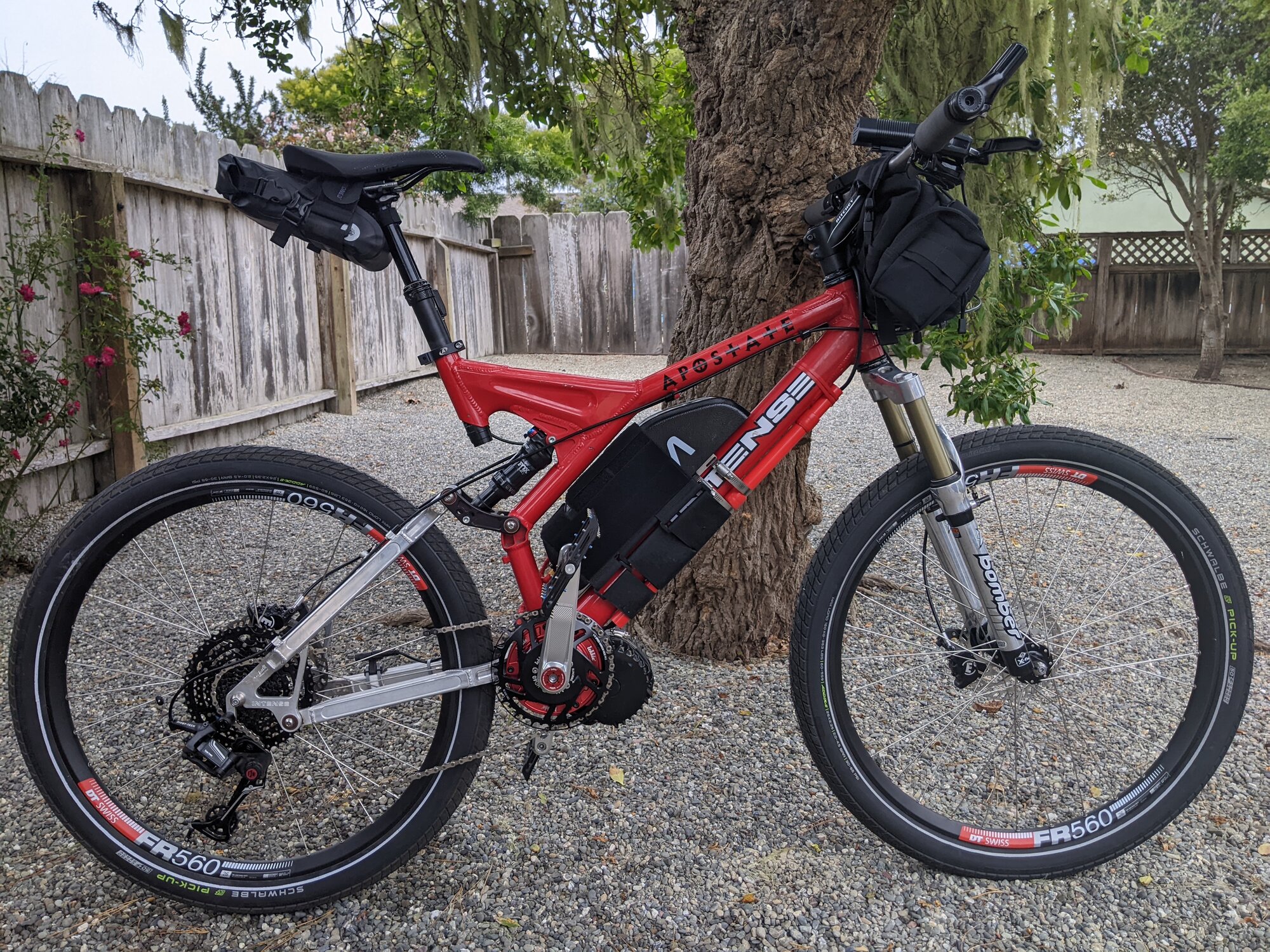

There are some suspension-dropper posts around.
I think there is only one combination suspension-and-dropper: The PNW Coast. I put one on my Apostate. I chose the external cabled version to be sure I kept clear of my rear shock.
PNW says this in their literature/advertising and it is absolutely true: These posts do not perform the same function as suspension posts. They are posts that ride solid and only take the edge of a hard knock. Thats it. It behaves nothing like a suspension post but it does perform its advertised big-hits-only function. I wanted to see if I could absorb a little of the give that would otherwise be transmitted to my mall and overworked rear shock (it worked and max travel was reduced).
