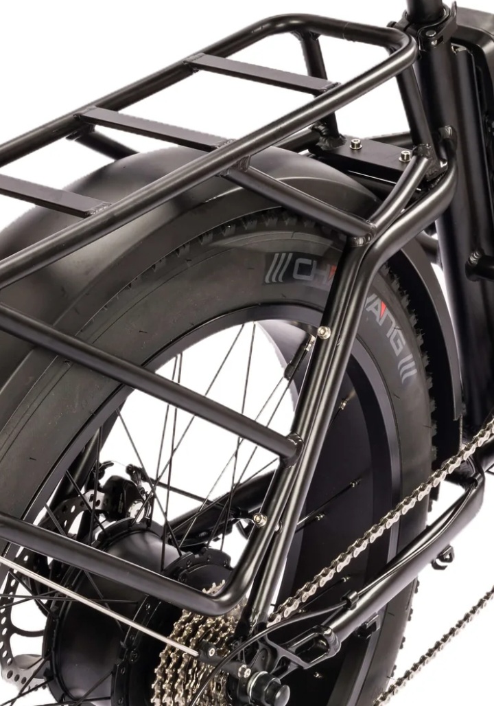

Hi there. My first time here. I'll just jump straight into the major details and hope I can explain it well.
I bought an Espin Nero bike about two-three years ago. And over the course of the last couple of years, it held up pretty well. Even went ahead and got a double battery adapter from Big Game Bikes in the UK. Recently, I was involved in an accident (I'm doing OK) and sadly the bike was partially totaled. The front fork was snapped, the rear wheel was totaled, the braking system was completely shot. I tried to contact Espin to see if they would happen to have a rear wheel replacement and unfortunately, they told me they were out of stock on the wheels and unable to send a replacement. (They had fenders though so no problem with that.) So now I'm stuck with the frame of the bike (which held up), the two batteries (no damage to either of them, the frame of the bike actually landed on my leg which took a beating), a front wheel and the badly damaged back wheel.
I'm now trying to find replacement parts to the items which didn't survive and this is where I'm having problems. I can't see to find a shop or AliExpress/Amazon seller who happens to sell a wheel with the same connector as the original tire has (it's a 9-pin Julet connection, but the pin layout is kind of weird to explain) and the wheels that I do find are rated at 1000W and not 750W (they are 48V).
In short, I'm trying to ask:
The specs of the Nero are that it's a 750W, 26 inch x 4.0 fat tire with hydraulic brakes (I'm already considering switching to Tektro brakes instead). The controller is an older LSW17974E (with a rated voltage of 48V and max current of 24A, the website on the controller doesn't even exist anymore...). The only benefit of this controller is that it has a five pin out for the rear light. (Which also seems to be missing from the other controllers I found :( ).
Any assistance or guidance would be greatly appreciated.

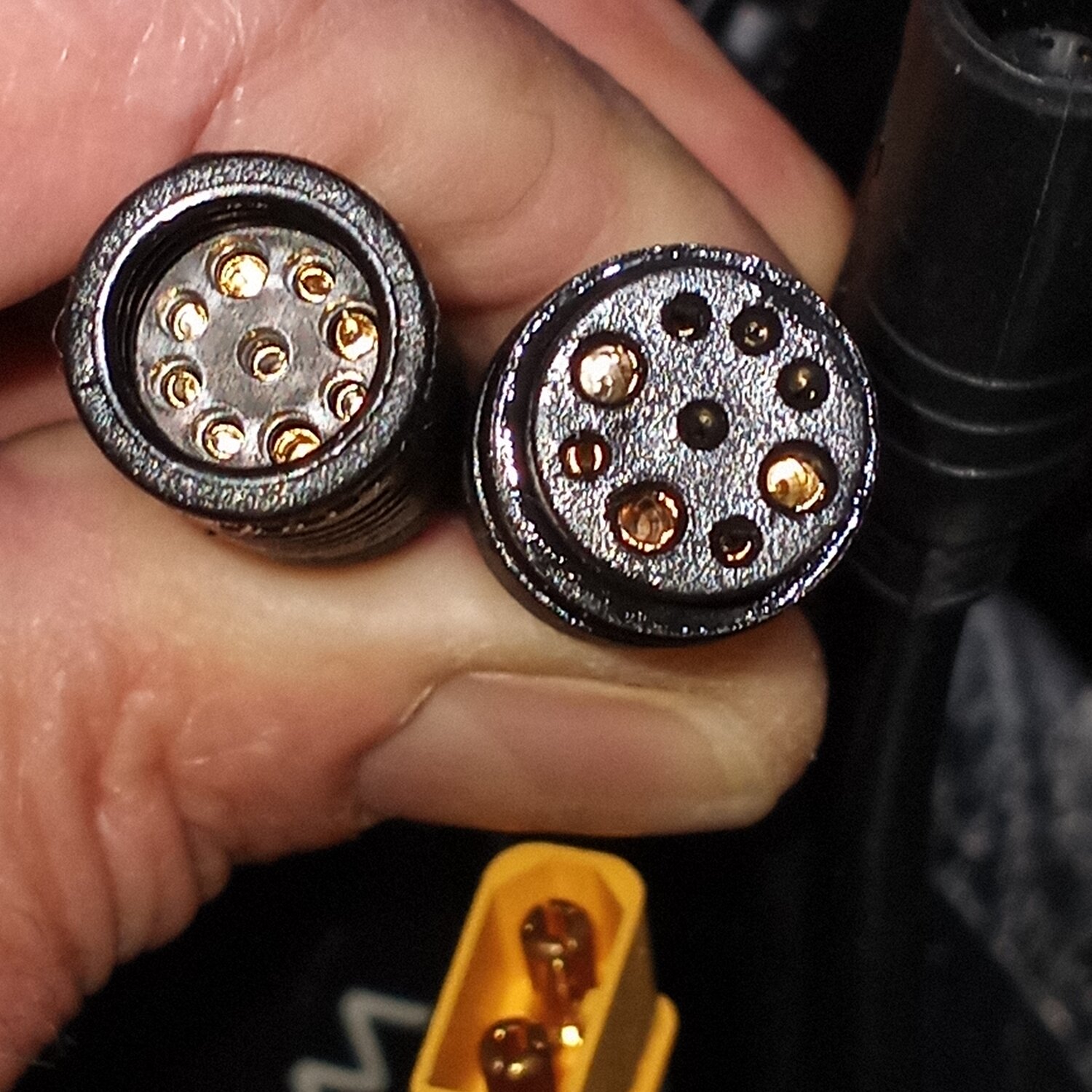

Yeah that 9 pin controller is hard to shop for. Luckily the wheel I found matches connectors. But thanks for the help with the controller question.

Note you can't swap phase wires and hall effect wires in a juli connector. Buy the adapter cable from juli to white block 6 hole hall effect connector and 3 phase wires with either .157" bullet connectors or ring terminal connectors. I buy only controllers that have these connectors. I bought a kit of white block connectors with solder terminals in 2, 3, 4, 6, and 9 patterns. Then I can make "door switch" connectors (power on), correct un-matched throttle connectors, or correct for the bafang motors that were wired backwards to suit Uber's purposes. Same reason as the 7 flat axle nuts and the tamper proof cover screws I imagine.
