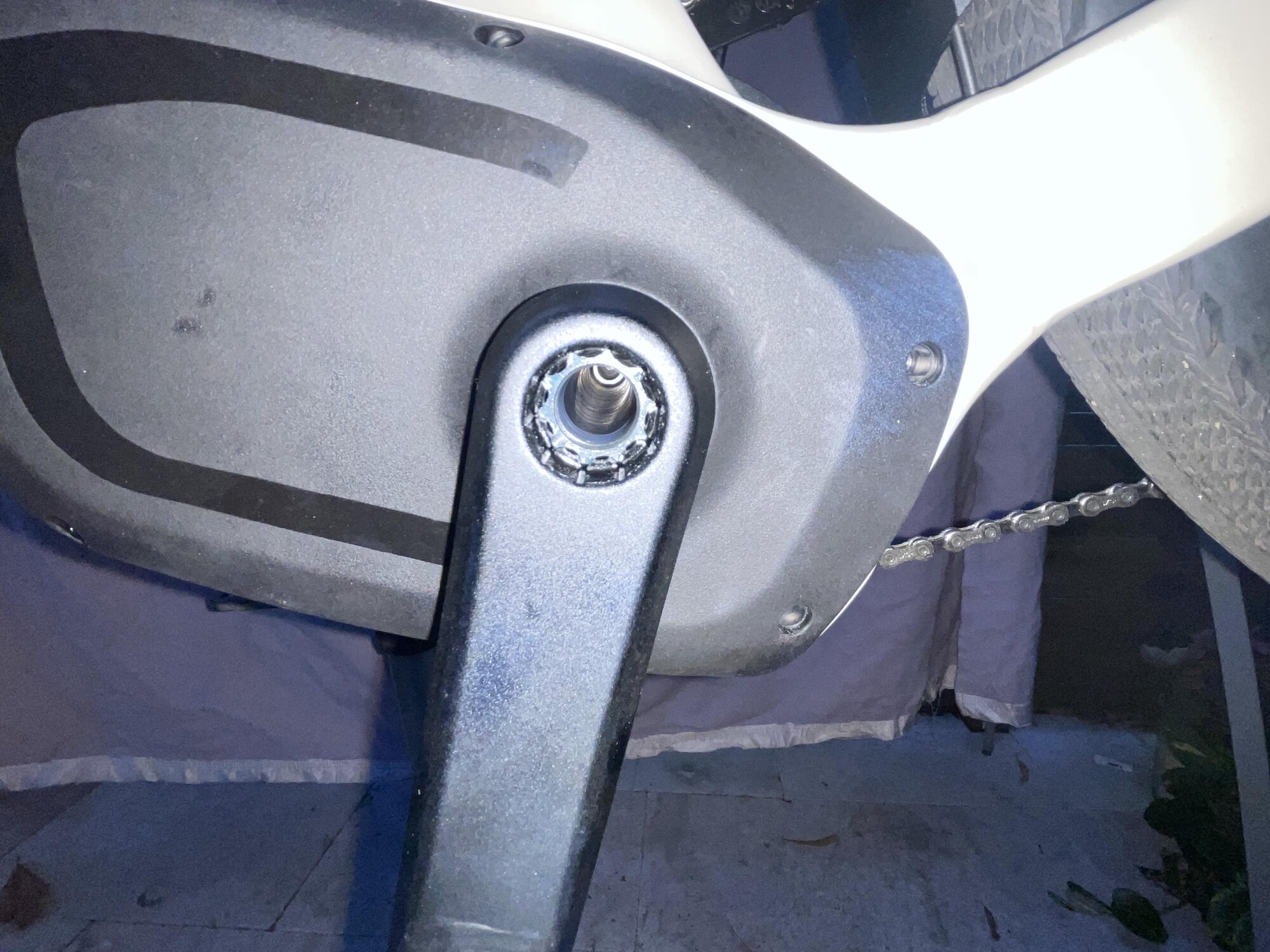

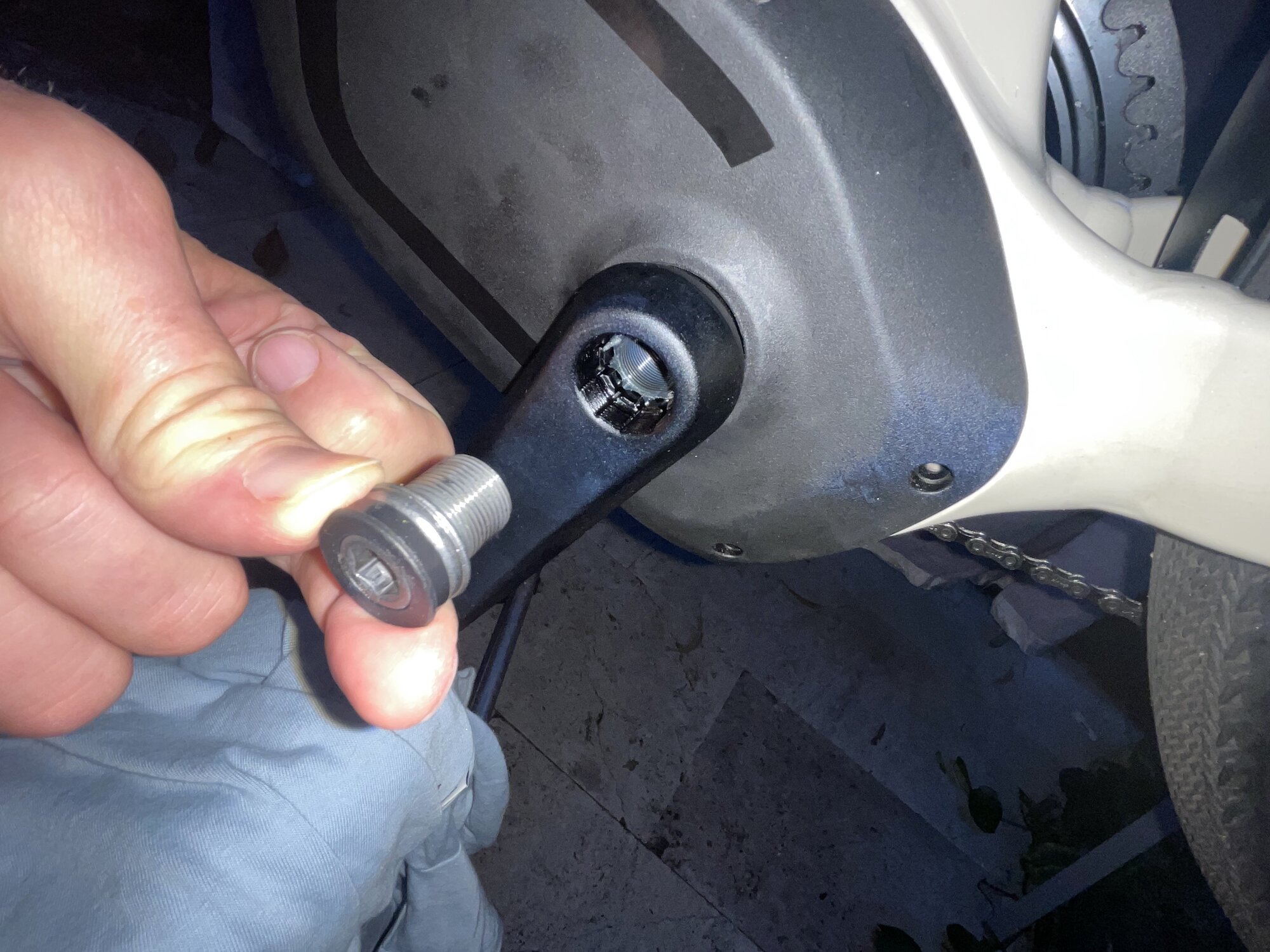

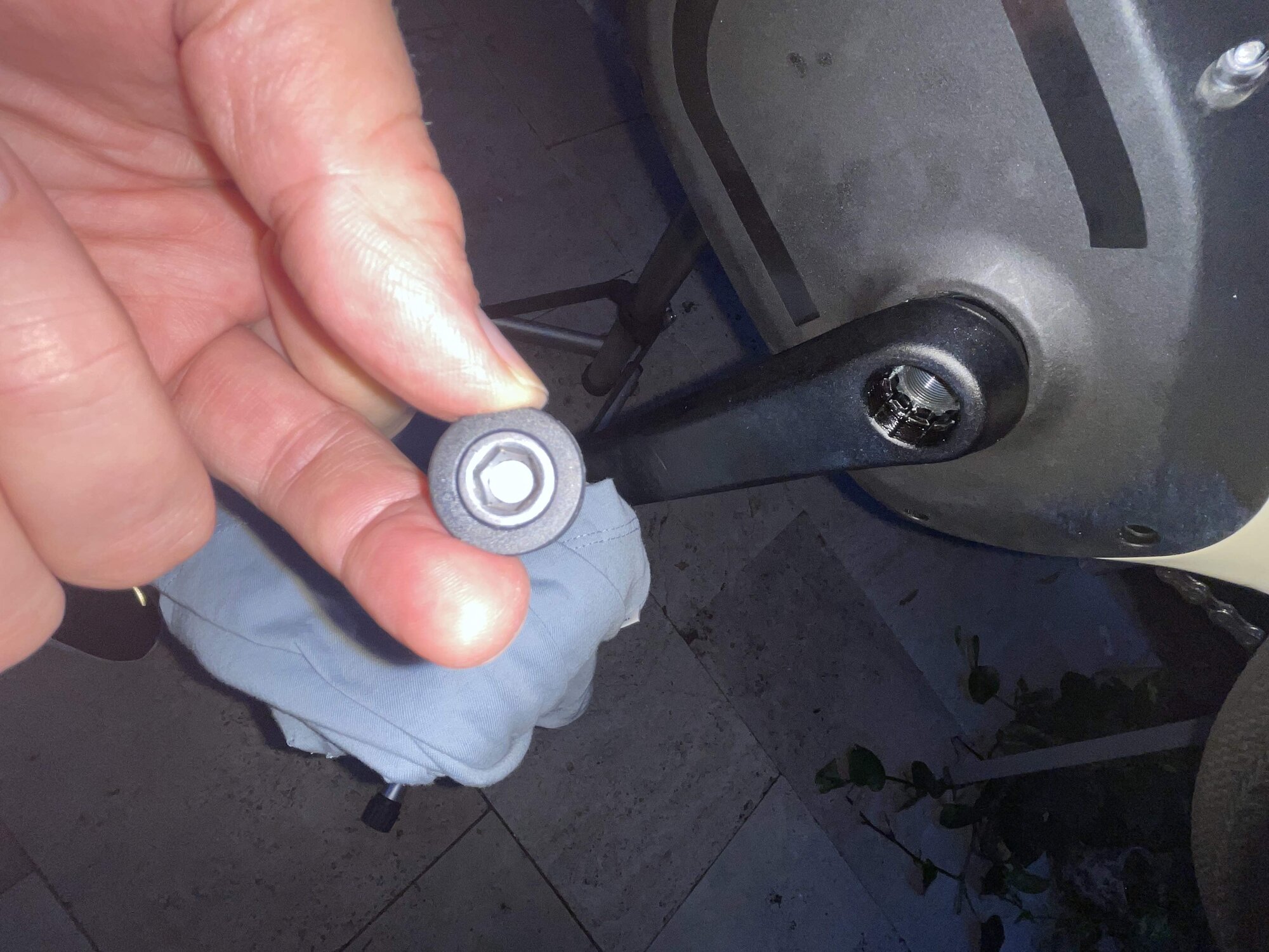

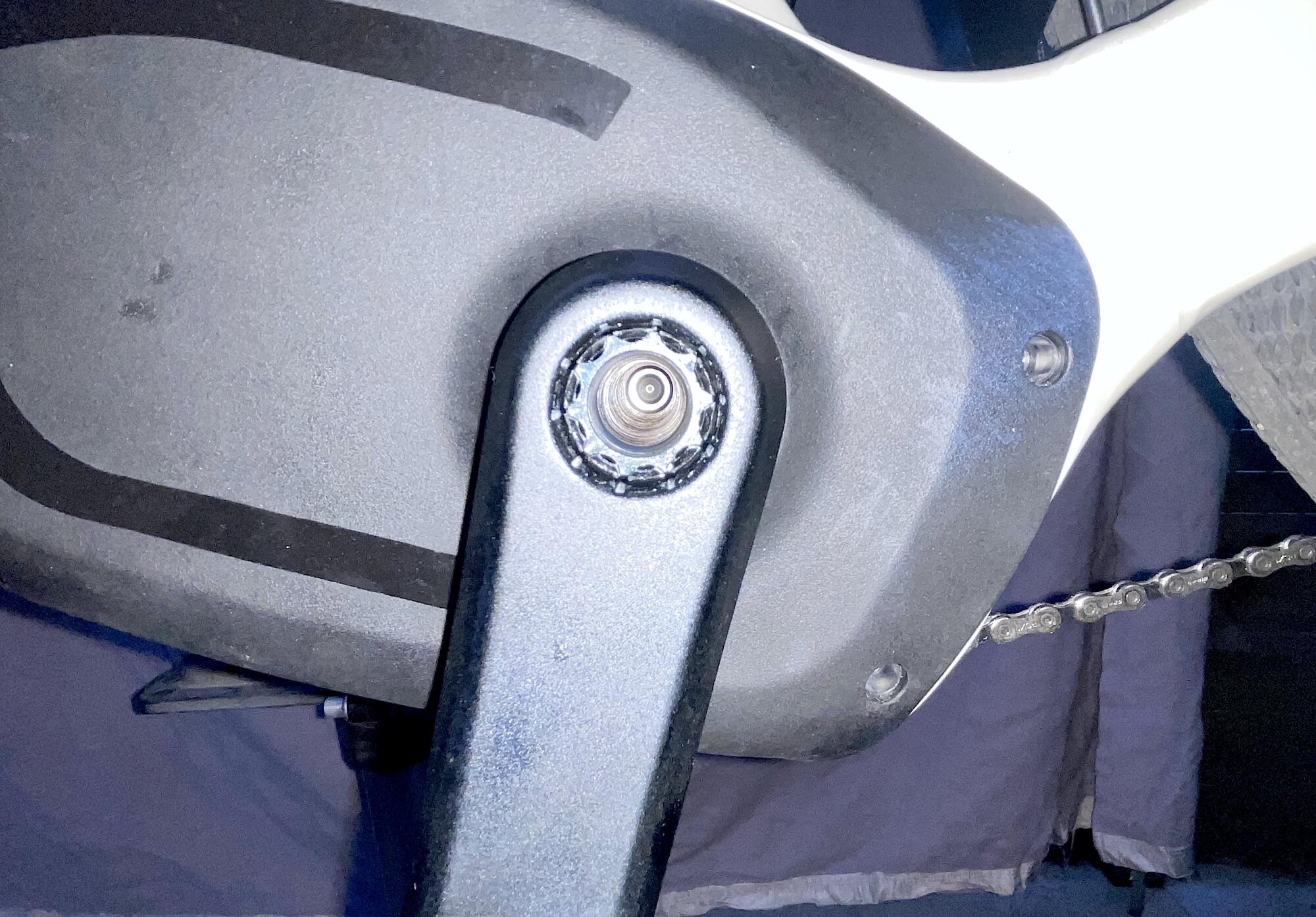

Hi all, I've got a new Turbo Vado 4 (last one stolen) and am trying to remove the left-side crank to instal a chip. I've removed the 8mm hex bolt, and from memory that's all that is required... can anyone confirm if there are more steps or that's it and the arm just needs to be "coaxed" off somehow, please? From memory, when I did this on my previous Vado, the crank arm came off after just a little nudge or three, but this one is like it's welded on.
There are "teeth" on the crank arm side of the hole that seem to be only wedged into the corresponding spaces in the crank axle, but they look like they might possible also be threaded or grooved for more bite... [see pix] IMG_0666.jpeg
but I don't know. Perhaps a gear puller is now needed or similar?? I've wacked it with a hammer, given it everything with hands/arms, right up to the point I feared I'd break or strip something. So I'm reluctant to go further... I would much appreciate any insight if anyone has any experience a 2022 Vado crank removal.
Help please!

It looks that your post got overlooked. Did you manage removing the crank?
Hi Stefan, yes thanks, but I had to buy a crank puller [ I got the Park Tool CCP-44 Crank Puller for Splined Cranks] which worked fine. But it became clear that there was no better way - I think I just got lucky with my previous Vado 4.0, the crank just came off easily with some pulling by hand, so I just assumed this was normal, but that seems unlikely. Not surprising really, since we all want our cranks to never fail!!
Thanks for checking!

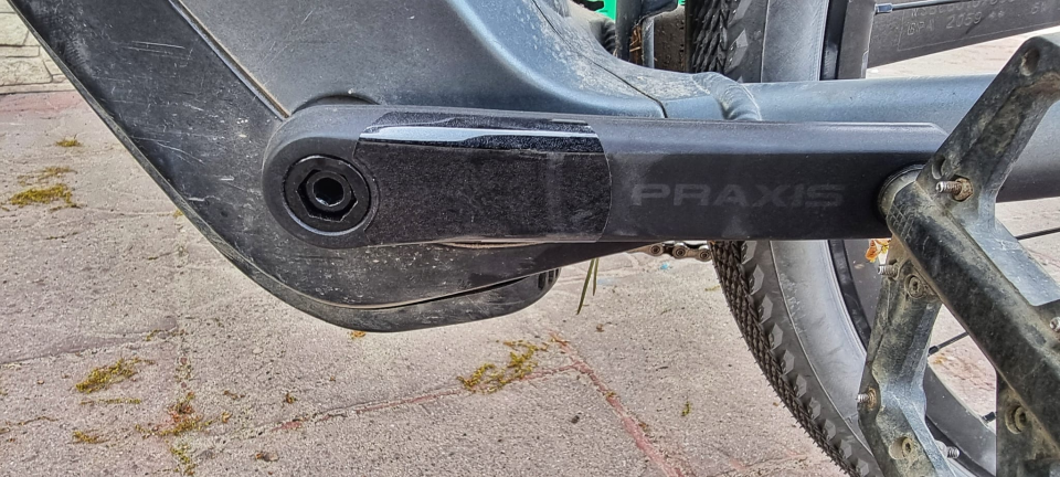

I will be in the position to replace the cranks on my older Vado with shorter ones, Praxis 165 mm for the 24 mm motor spindle, dedicated to Specialized e-bikes such as Vado. Praxis claims the cranks are self-extracting (so only an 8 mm wrench should be needed). In case of trouble though, my brother owns an ISIS crank puller! :)
