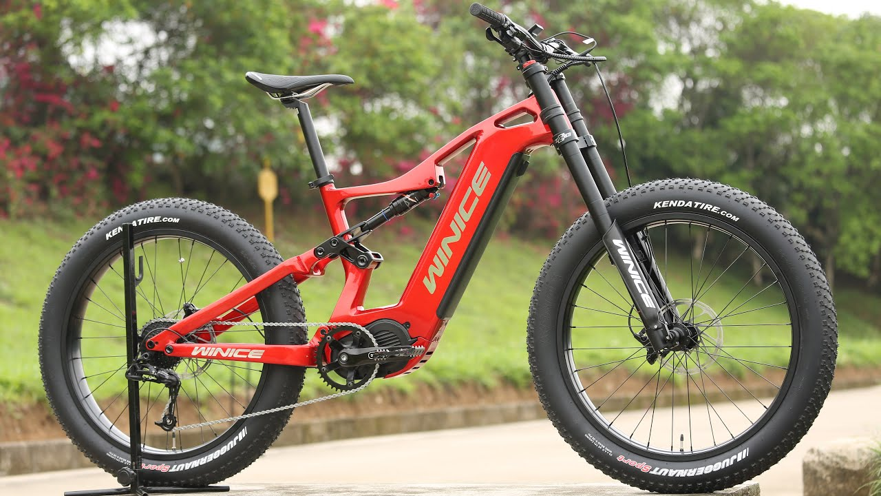

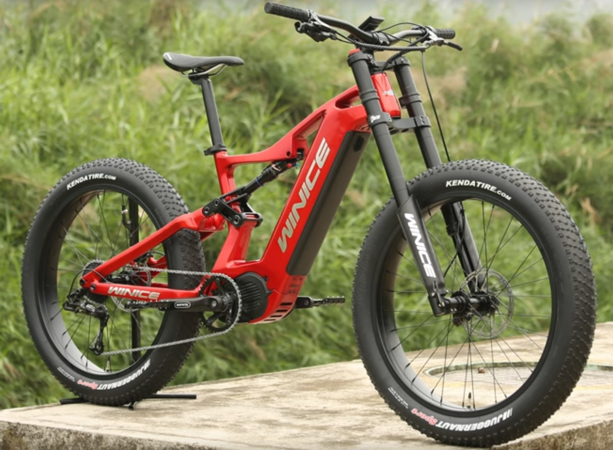

Dengfu just released new carbon fiber frames E55(regular size tires) and E56(fat tires) for m620 motor for DIY guys and the frames look sick, the motor is smoothly integrated and on top of that is it works with huge 52V 20A 1040wh battery. I think at this point the Biktrix Monte Capro Ultra is obsolete

Oooo, Mama! That's the first thing I've seen that would make me consider a new build over my E06. I guess I need to abuse my E06 even more so I can break the frame and give me an excuse to replace it....
Not for me, but still a pretty awesome looking design. Motor case tilted up out of the way, and room so you can carry a battery big enough to allow for some hard play using the M620. Nice!

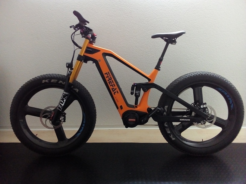

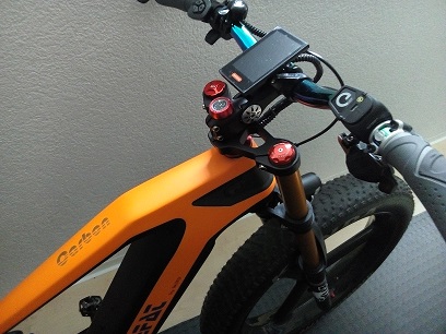

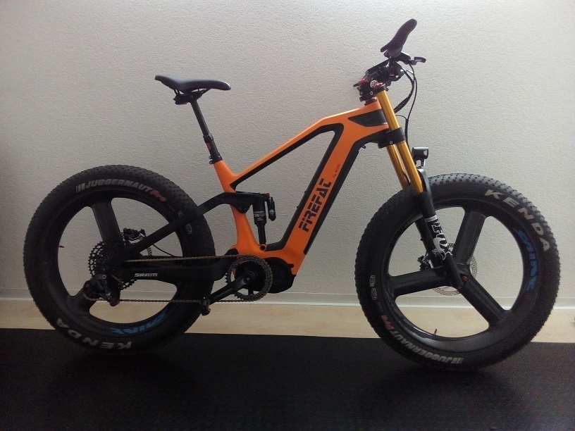

No Words........

That Frefat ebike (Firefat? Odd kerning...) has a distinctly different frame than the E56 & E55. Rear shock layout just for starters.
Looks great in orange though!
Is that your new ride? It looks nice enough that I immediately went searching for details, but I didn't find anything resembling it, online. Can you tell us anything more about that beautiful bigfoot?

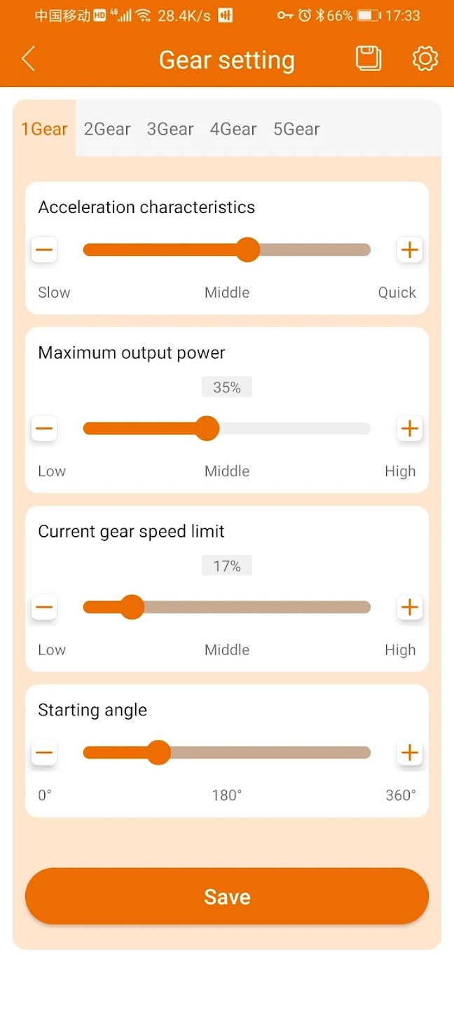

Not sure this has been mentioned. Bafang has a new app on Google Play, Bafang Go+. Screenshots show assist programming. It may have just been added today, no reviews and shows today as last time updated. I don't have my QuietKat Rubicon yet, (fantastic price right now) but managed to get the app installed and verified. A little clunky as expected and asks for lots of permissions! I blindly said yes to all but notifications, otherwise it wouldn't run. I hope it works as I ride tight trails and from what little I know, the motor currently lacks control and finesse. Will see when the beast (bike) gets here...

You sure that works with the M620? App description says it connects wirelessly.
