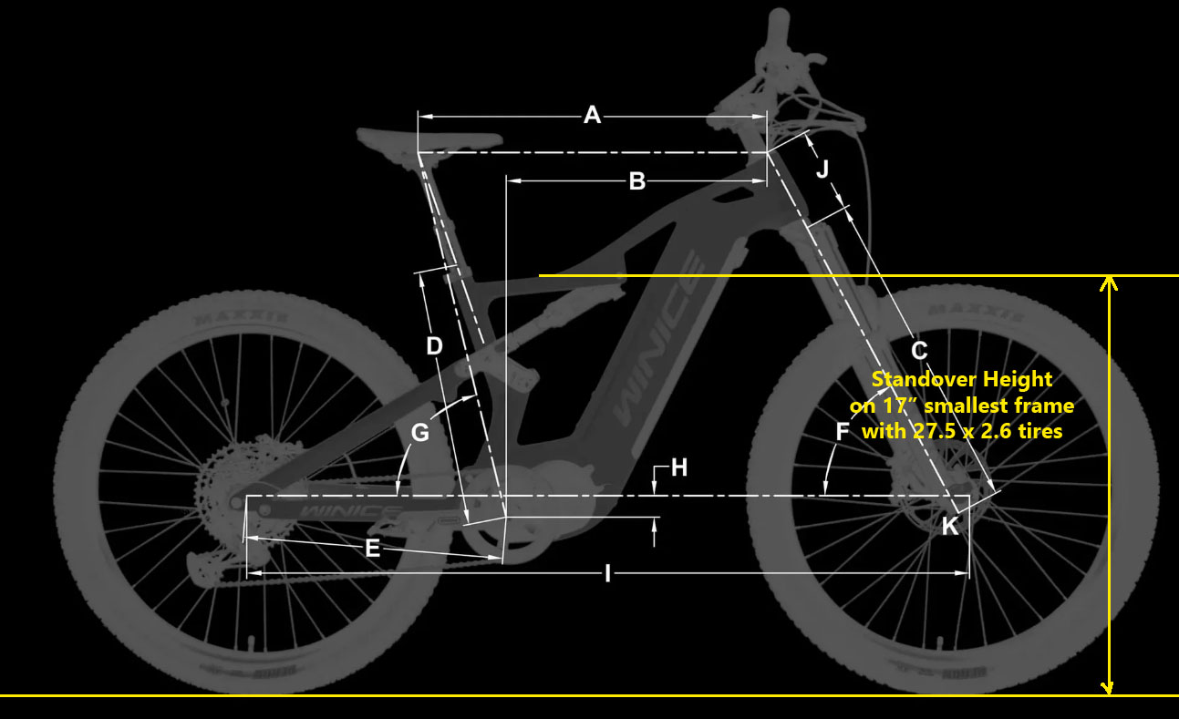

Do you have access to a 17" frame version to measure the standover height by any chance?
below is what I mean by that"

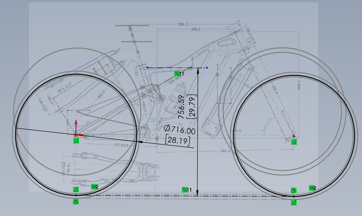

It is about 757 mm for RockShox Domain RC Suspension Fork part number 00.4020.707.006

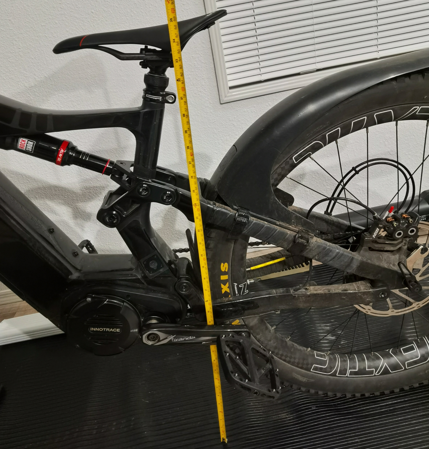

It is about 35" from the ground to the top of the seat with lowered dropper post on 29" rims with 2.8" tires. If you consider to stay in that area it might not be possible because of the seat is going to be right above it (you can see on the picture below how the seat nose covers this area).

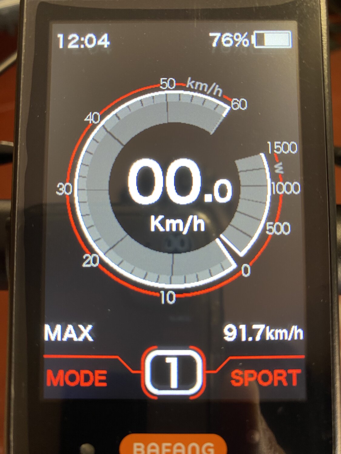

I haven’t tried to lift the front wheel but I’m sure it’s possible. Interestingly, the 60klm speed limit doesn’t seem to apply to the throttle when on its stand as you can see from the max speed on a partially charge battery.
