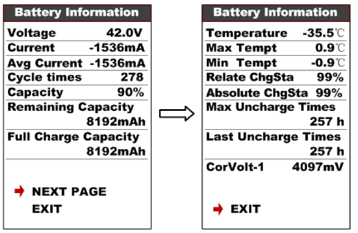

I was referring to battery communication with the motor controller / display for information such as this.
Same data can (& does, when installed) get sent over UART: CANBus does not carry any different type of data (data is independent of how it's carried); UART & CANBus are just protocols by which data is carried.
CANBus can use fewer wires, but the main reason OEMs like it, is the protocol's device-ID keying scheme which makes it super simple to build systems that reject 3rd party parts / diagnostic etc.
What you are referring to I believe is considered unnecessary.
Yes I understand that... But do you know anyone with a UART motor that has battery communication? Supposedly a Bafang branded UART battery would communicate but as far as I know up until the release of CANbus they were not exporting battery/motor sets.
I mean, before ebikes were commonly mass-manufactured, many of the batteries I saw had either no BMS at all, or a full BMS, with per-row BMS seemingly rare by comparison...
Pairing a specific line of batteries to a controller is mostly new with the advent of CANBus usage, but CANBus is in no way a pre-requisite to BMS usage; it's not coincidence that manufacturers concerned enough about liability to include a BMS, are also those more likely to employ CANBus to deter unlicensed modification.
For decades, UART serial communication's been used to carry all kinds of data with BMS data being no exception; ebike manufacturers tending to introduce BMS & CANBus at the same time, has plenty to do with business strategy but nothing at all to do with the capability of either protocol.
TLDR: UART m620 displays\controllers accept BMS data if it's provided. UART already supports BMS data; CANBus adoption is contemporaneous but not prerequisite with BMS usage.

I'm in total agreement that UART is more than capable of transmitting BMS info.
And that UART is more than capable of the programming needs of a controller and that the manufacturer move to CANbus is more about product control and lock down.
That's why I've decided to stay UART for now.
But in my search over the years and battery purchases... No one offered a UART BMS and was led to believe the only one doing so was Bafang itself but only available in China.
I still don't know of anyone selling.. or anyone who has purchased a battery that has a UART BMS that can be used with the Bafang UART display to see battery info.
Y SOC MV
How expensive to convert CANBUS to UART? I'm thinking new controller, new display, new wiring but should be able to keep the motor?
