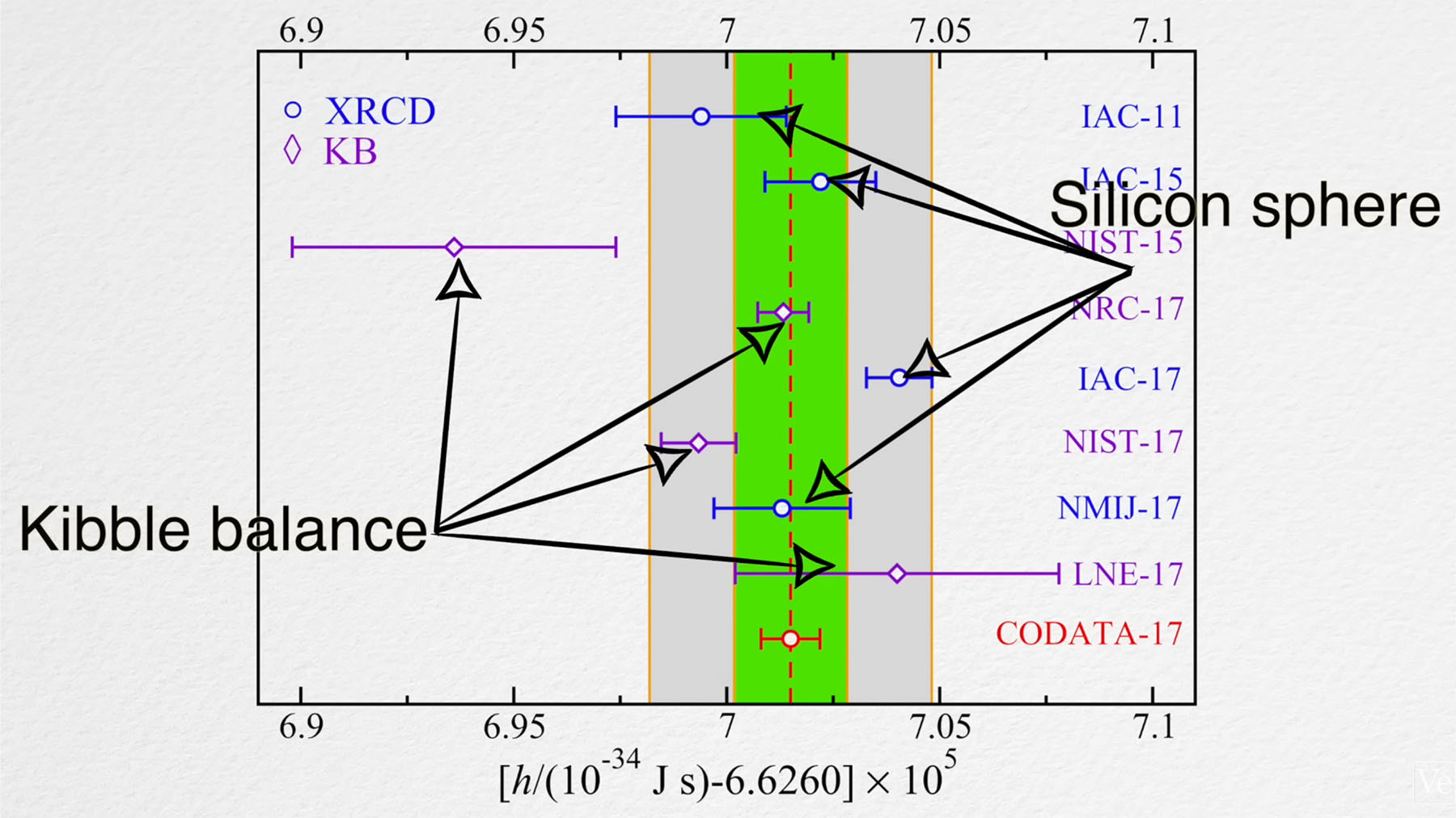

(Not so) fun fact: The Kilogram is no longer based on a fixed mass (such as by measuring the prior samples in Moles, as was suggested), but instead is now measured via the force exerted within a specific known gravitational field; in the process, we've not only made Kilogram calibration now require a (proprietary) device adjusted for each region of the Earth (or space), but also if read very carefully the definition now contains circular logic.
We really should have gone with Moles, despite the drift involved.
