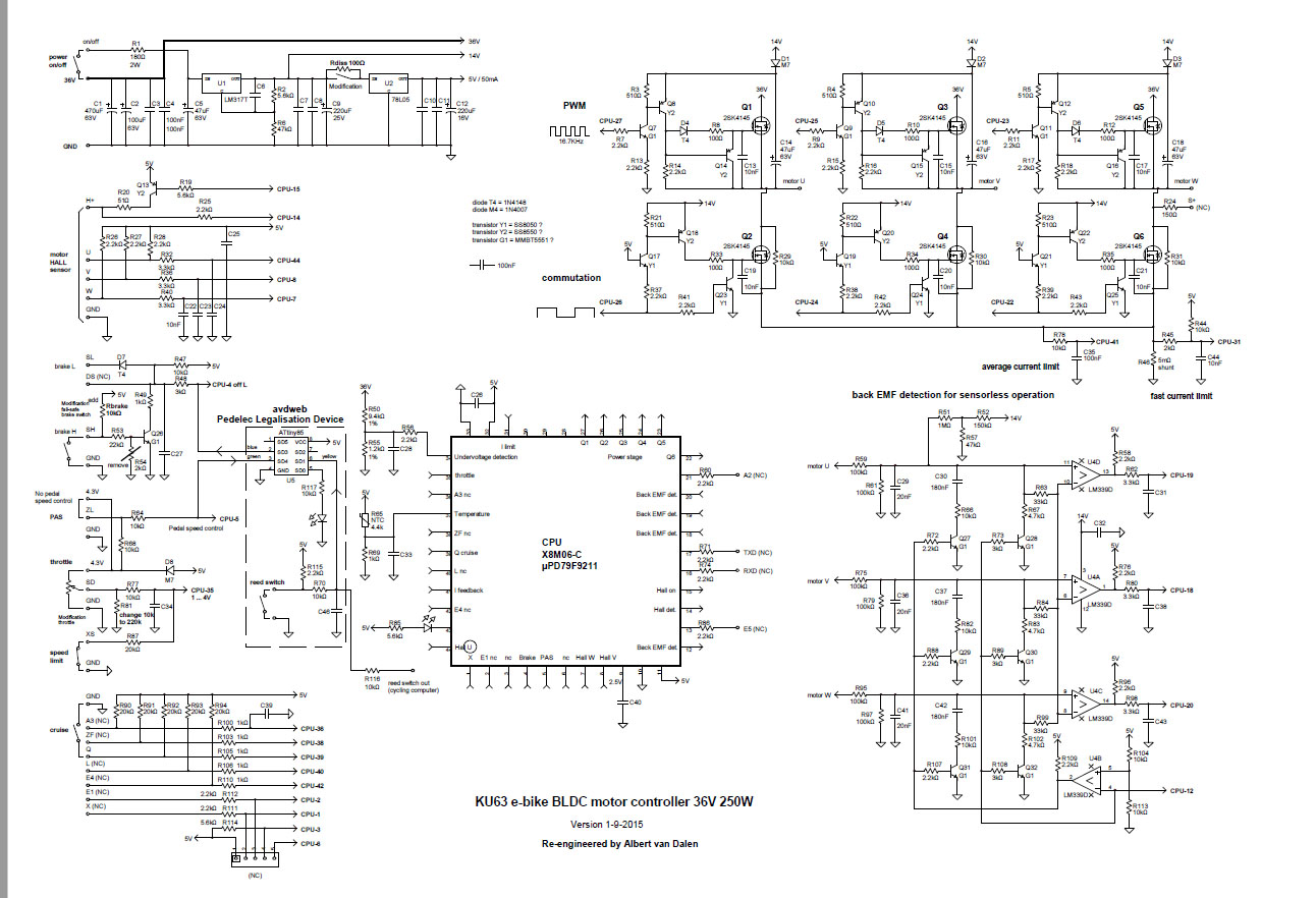

Best way to test a motor is to hook it to a good controller. Conversely, you test a controller by hooking it to a good motor. Here's two schematics for popular controllers that are representative of motor drives. You can examine the mosfet drive circuits,
  • S06S_schematic.pdf

It's all digital in the end. The controller only looks to see if the Hall signal is above its digital Vin, probably 2V. However, your Hall outputs, which I didn't look at, should be similar.
As for the 13V, you;re the circuit guy, I gave you two typical drive circuits to get you understanding it, Figure it out.
Yes, I took a deep look at it, it's very useful.
The problem is that I don't know what the CPU is supposed to output, whether it's supposed to be symmetric or not.
As a consequence, even though the MOSFET driver circuits seem symmetric, I don't know what the end result is supposed to be.
