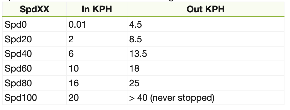

You probably need to choose a different Wheel Diameter/Circumference in your display (not Basic) settings.
Which of the Speed columns world have the greatest effect for 4-15 mph range, for rough trail riding?
From the Spd Table post (https://electricbikereview.com/foru...g-the-torque-tabs-spd-table.52505/post-594973 ):
Multiply by 0.62 to convert KPH to MPH.
Note the speed columns overlap. I believe there's a feathering as speed moves between them.

Torque Tab: Spd Table
  • Repeats the incorrect claim that the 6 ranges are motor speed ranges and not bike speed ranges. They are actually Wheel RPM ranges, but that’s closely correlated to bike speed.
In my opinion it's motor speed ranges. Have checked this - if i ride without magnet mounted in wheel, engine works as usual and controller has no information about wheel and bike speed.
I've been riding ultra with stock controller and 14s7p battery for only a few days and I'm trying to find the best settings for me. I'll check the rest of the information posted here and come back with conclusions. I tried to get some programming information from the bafang distributor but it seems impossible.
That's not a conclusive test. The test I ran is described here: https://forums.electricbikereview.com/threads/ultra-tuning-decoding-the-torque-tabs-spd-table.52505/
Essentially, I zeroed out MinCur & MaxCur in all the SPD columns except one and then rode the bike to see when power kicked in and out. Then I changed which column had non-zero values and rode again, seeing the differences. Then I changed wheel size, which had no effect. Then I changed how many magnets I said were present and that changed the in/out speed points. The only objective conclusion is that the columns index off of wheel rpm (which is essentially bike speed if you don't lie about your parameters).
The behavior you're likely seeing is that you're getting power as specified by the SPD0 column, since without a magnet there is zero wheel rpm reported to the motor controller. Change the MinCur and Max Cur values in the SPD0 column to zero in your bike without a wheel magnet and I bet you won't get any power. Better yet, try reproducing my test and I bet you'll be convinced.
