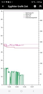

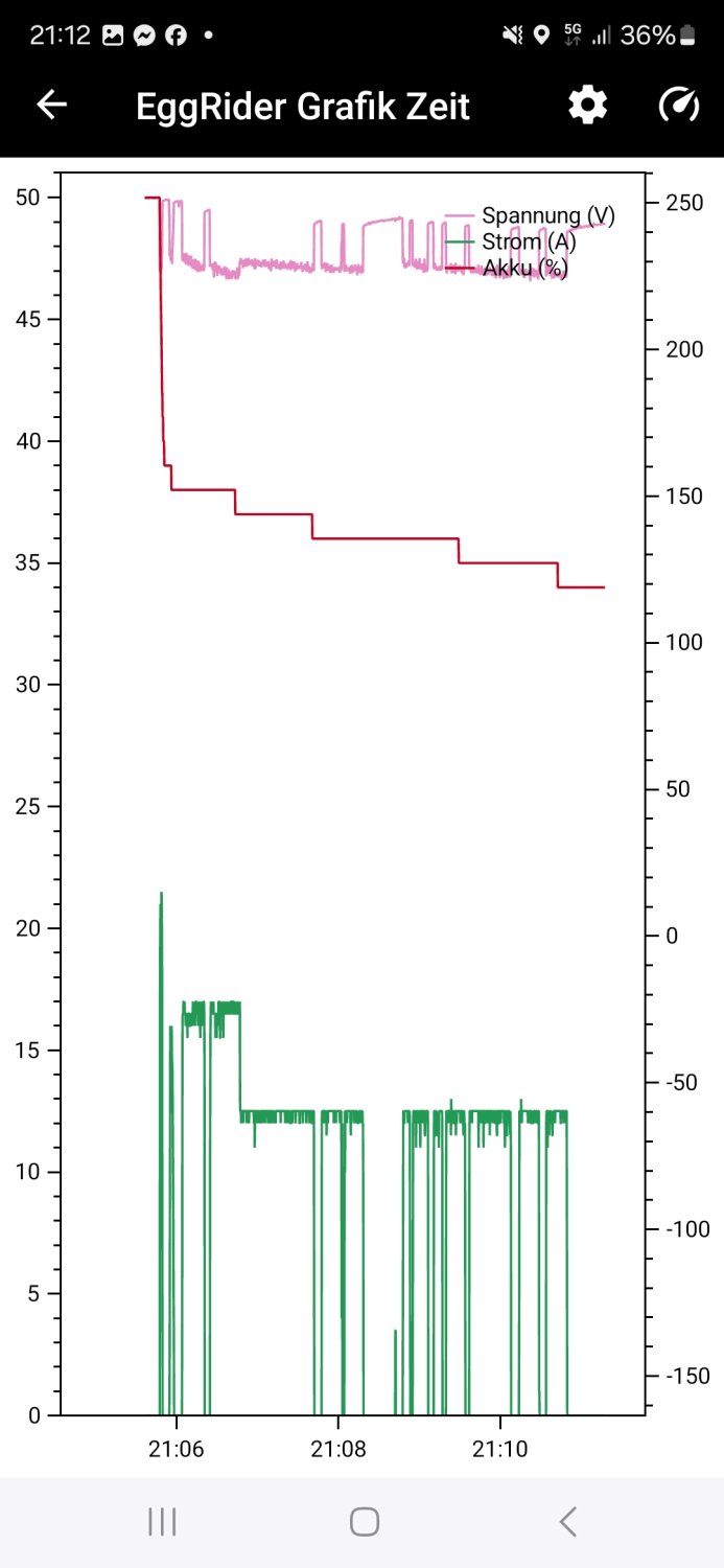

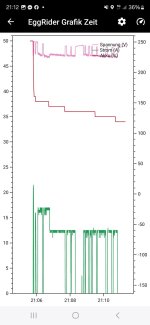

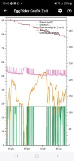

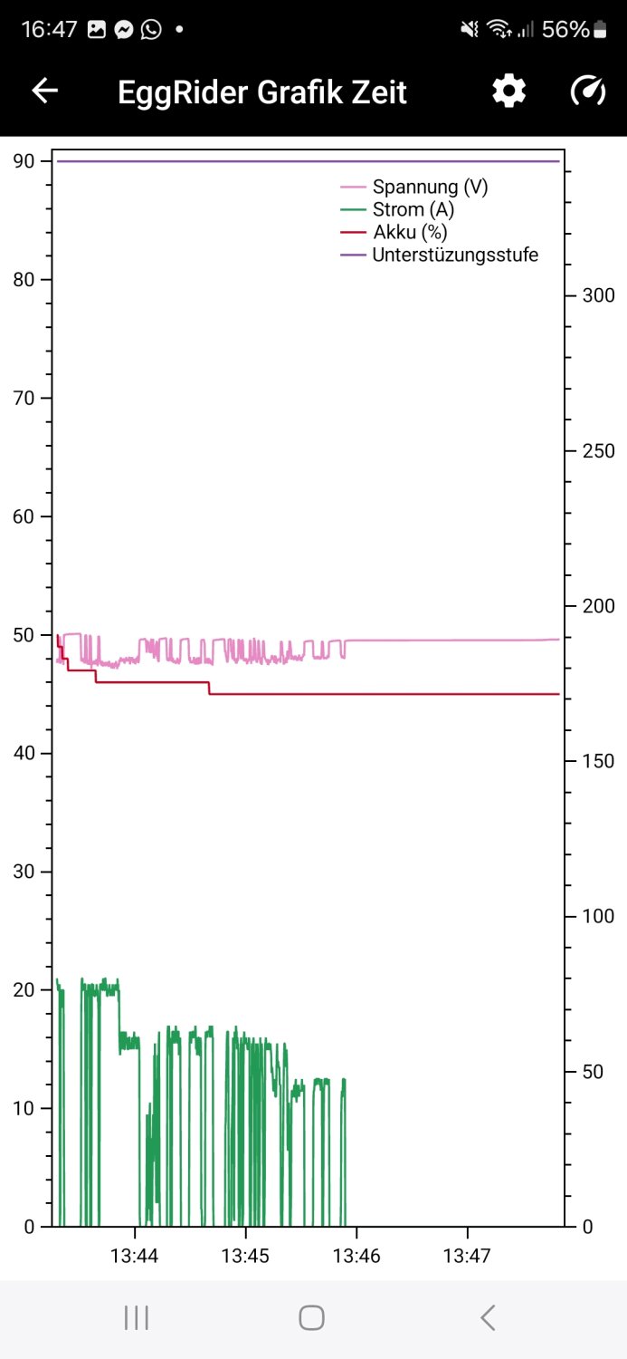

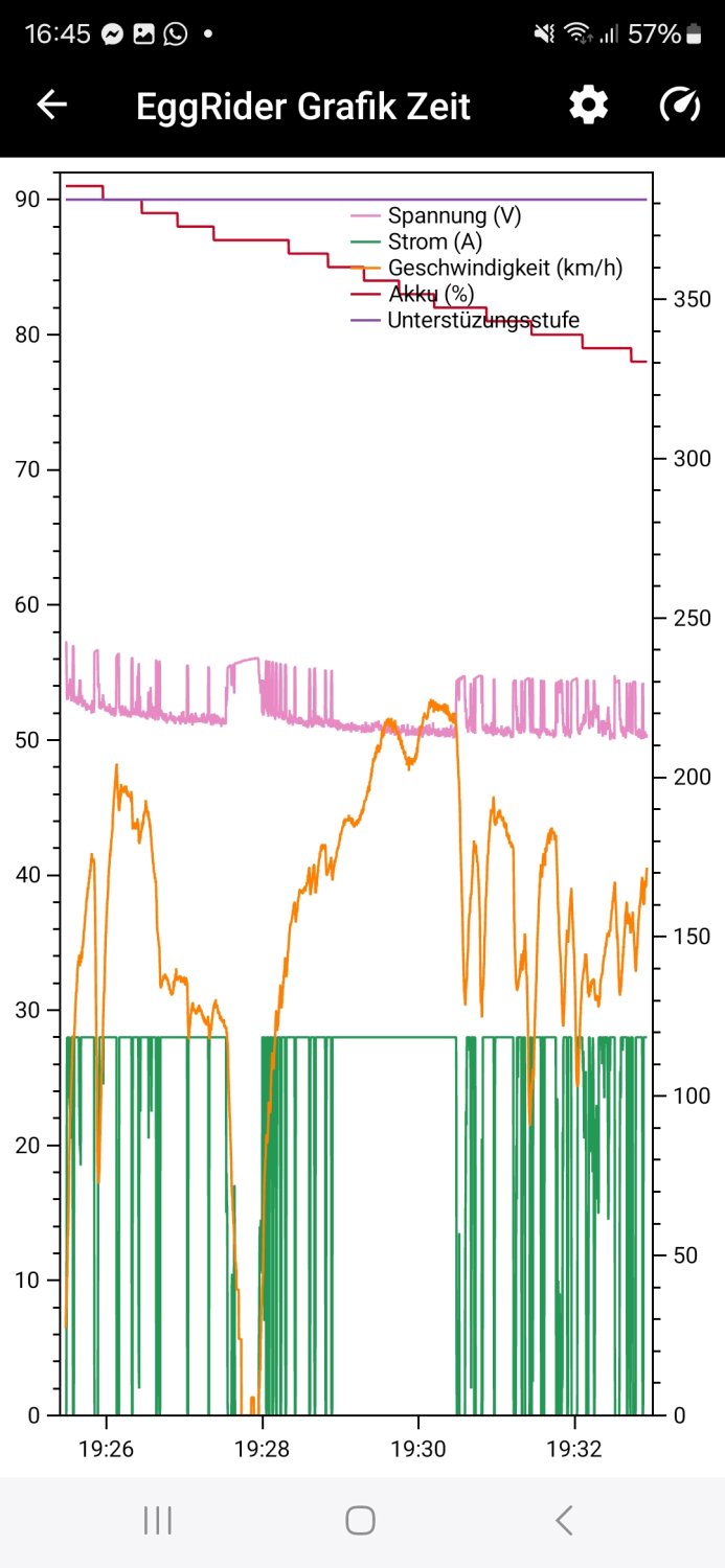

My issue with the Banfang m620 ultra 52 is that the "Low Voltage Cutoff current ramp down" starts in my case by 50% SOC in 4A steps to limiting me for the remaining 40% of Battery SOC to 12A max current.
