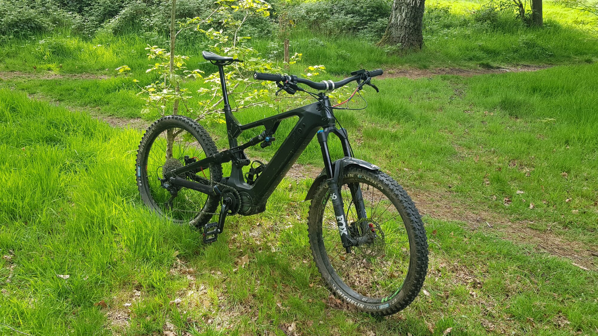

So essentially, just pretend it has the 'LUNA' logo on the downtube and it would pass as a Luna z1.

LOL dude take that shipping sticker off your M620 your blocking the cooling vents 🤣
Good eye👍🏿
I didn't even realise until I watched it again 😅.
Truth be told, the sticker is still on (even after being cleaned multiple times 😀).
But I haven't encountered any problems so, I'll guess I might aswell keep it on........until it one day losses its adhesive.
