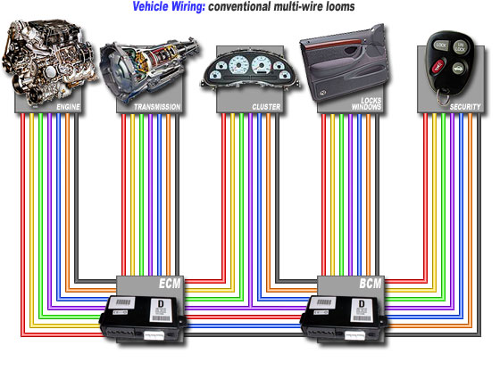

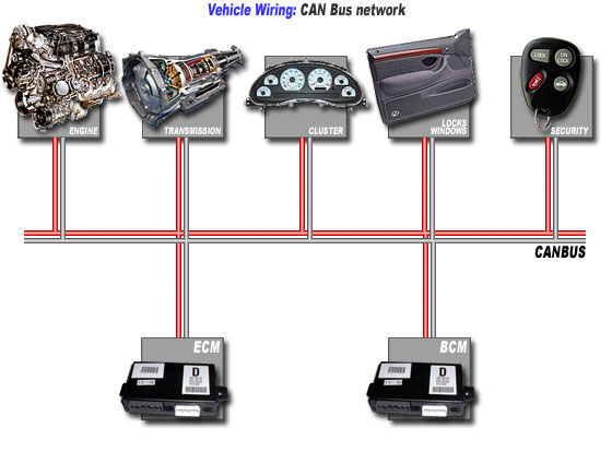

There is a reason why every car in the world uses CANbus communication not UART.
This diagram explains why the CAN bus communication protocol is used in the automotive world and the redundancy.
Source: https://canbuskit.fortin.ca/what.php
Without CAN communication, the wiring would a total mess.
With CAN communication, the communication would lot more robust.
Yep: Vendor lock-in, & lower wiring harness cost for complex vehicles with many interconnected electronic modules.
Kinda proving my point for me, here: An ebike has none of this multipart complexity.
