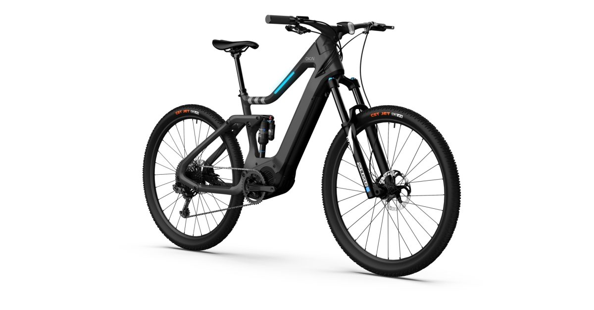

This one looks kinda interesting. CF frame with budget components, an odd pairing. Elektrek says Bafang Ultra motor, but has a touchscreen display and appp support so perhaps a next gen version of the Ultra or M600? Battery capacity is a bit weak for Bafang Ultra at 700 Wh unless, again, it's a more efficient next gen motor.

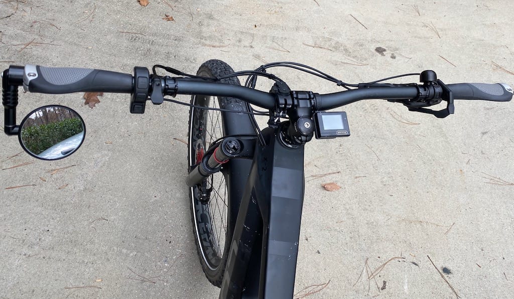

Touchscreen = meh, at least for a riding interface. When you're actually using controls when riding, e.g. adjusting power levels, the last thing I want is to be fumbling to 'touch the right spot' with no tactile means of locating the right spot. As it is their power/PAS controls are pretty amateurish - they don't really fit well on bars in general and could/should be streamlined to not break the second someone has a minor off.
Look at how the DP C240 controls are stuck hanging down below the bars if you position access to +/- sanely. Compare this to e.g. a simple, thin, round control like Grin makes - but no, instead, let's make a touch control that has you looking at bars and not on the road or trail for simple operations... meh.

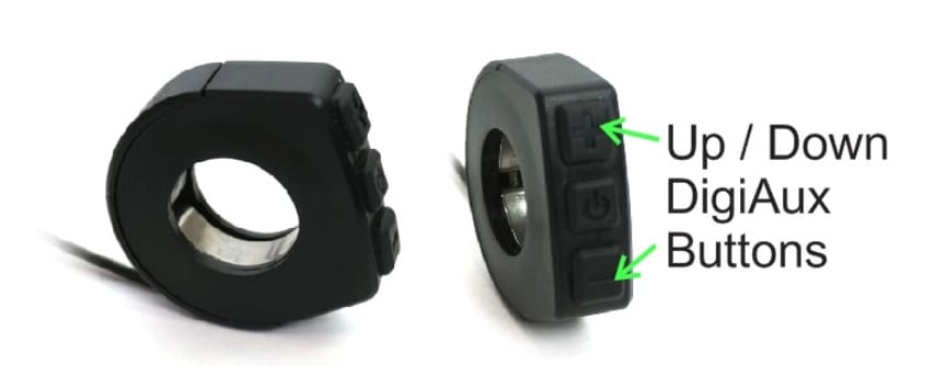

Which one do you think has a higher chance of surviving even a minor drop of the bike? I'm probably going to look into wiring one of the Grin units if I can find one, because none of the Bafang display/control combos are really anything I want. Ironically the DP C240 B/W is probably the closest as it mostly gets out the way, but the bar control sucks, and the screen could be slightly bigger and let you display voltage. Instead, they do crap like this:
K, go ride off-road or just near traffic at 15MPH - sure hope you can find the +/- quickly without looking at it.
From a usability standpoint and just basic human interaction principles, let alone specific to cycling - their displays and controls are a nightmare. At least copy <something good> instead of doing 'innovative products' by people that likely don't even cycle.
Apologies for the rant, but man- just copy something decent already Bafang...
Prefer tactile (click) type up/down buttons here as well. For the same reason. Looking down at certain times can be a distraction I'd rather avoid.

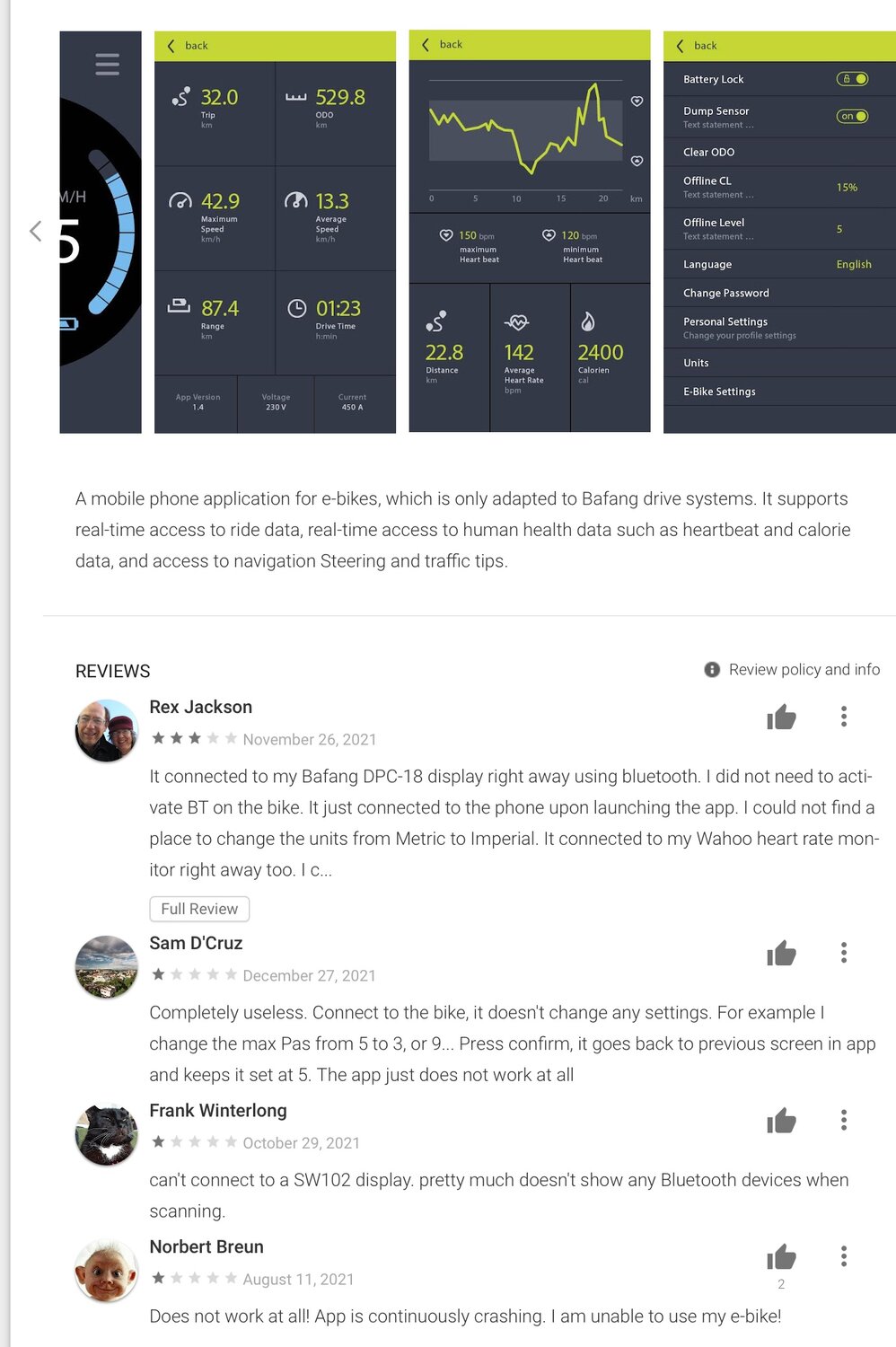

Yes granted, I'm aware of the app. However, that app doesn't support all bafang motors (M400 being one). Thus, a traditional programming cable is required.
