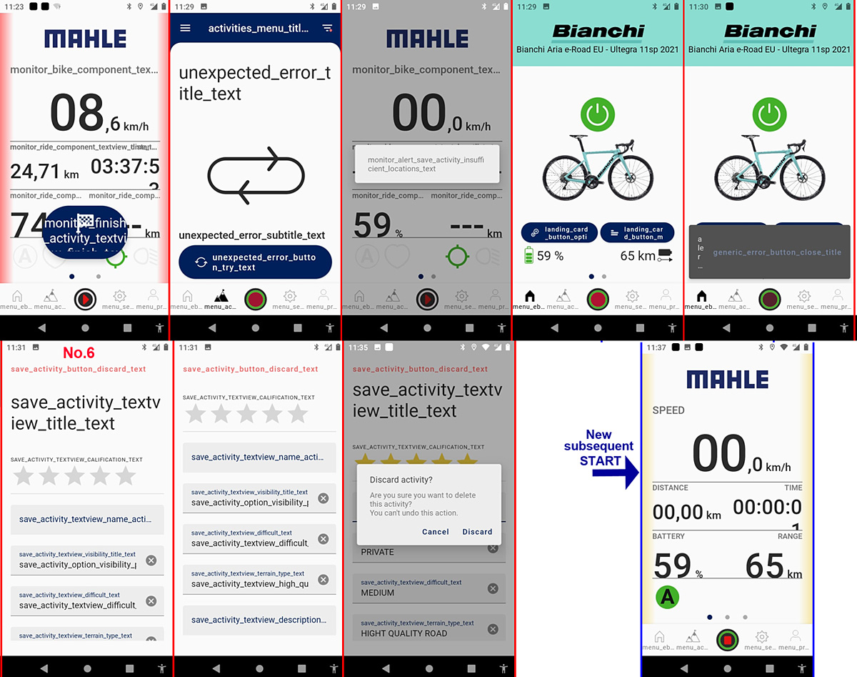

I updated the app yesterday (Update 14.7.22/Version 1.1.1) and was looking forward to an improvement in the result as the previous results had problems.
Big disappointment, bad result!!
Action: I activate the application and drive. Upon inspection, everything indicates that the application works well with all parameters. After about half an hour, I take a half hour break without turning off the app (I keep it in my back pocket). After half an hour I leave and the application continues to record the route without my intervention. I'm coming home and want to save the route. Now it has come. Instead of SAVE, subsequent screenshots that I recorded gradually appear. Nothing was SAVED, on the contrary, the application froze (on slide no. 6).
I had contact with fy. Mahle and thought it was still with the older version 1.1.0 from 14.6. – that everything will now work normally. A mistake - everything is worse than it was before.
Disappointment again!
So it's a disaster - in the end, I'm afraid that on my next trip, the app won't throw off the steering system of my wheels and I won't be stuck somewhere outside.
In addition to everything, the application instead of 1h. recorded 3:37:5, kilometers are fine, battery should show 59% (also recorded incorrectly in the app).

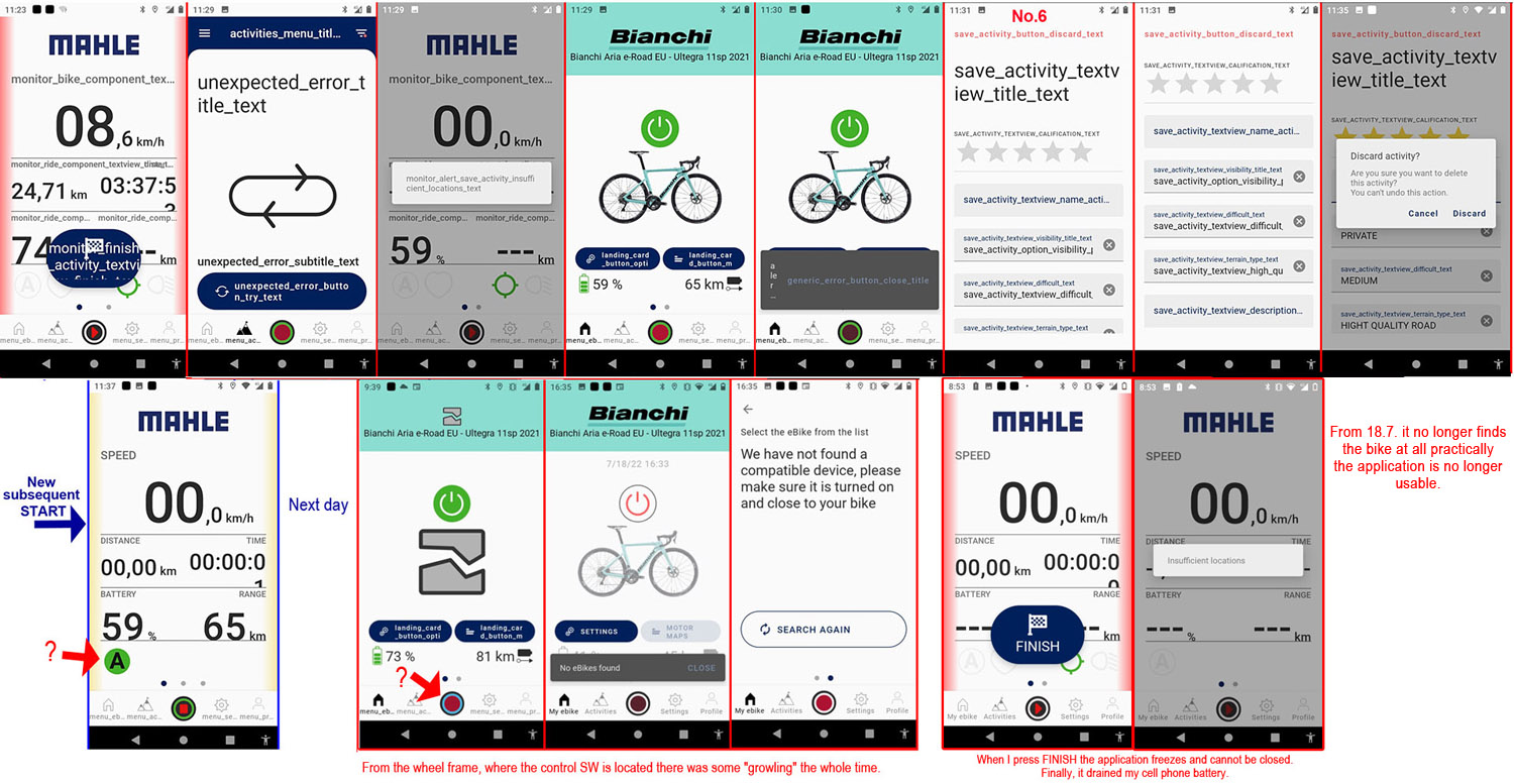

New: All this appeared after turning on the application in several situations at the start of the ride.
I couldn't even find a PDF guide for the new version of the application anywhere to get my bearings:rolleyes::oops:.
In addition, the diode on my bike was flashing purple, and at the same time there were sounds from the SW bike.
I'm going to try the app one more time and as it keeps happening I'll end the app.
Thank God - that the bike runs and the SW of the bike is not destroyed.
I am sending the whole file to Fy.Mahle, if he answers me, I will put the answers here in the forum.

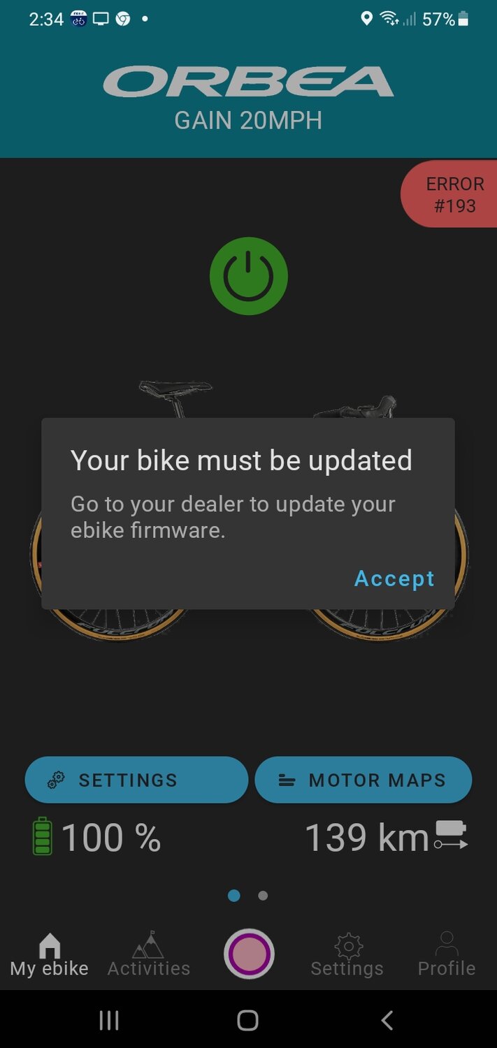

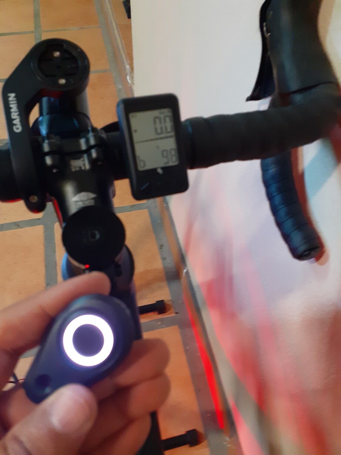

Hello friends,
Thank you for all the contributions received from you. I want to tell you that today I spent the whole day knocking on doors: dealer in the USA, Orbea support center, Mahle support center in Germany. All have given their response immediately (thanks to all of them) but nothing concrete.
The error that was being reported in my MyMartBike app is error #193 (see image), so I decided to start a document search about error #193 and found that it is due to "excessive tension in one of the cells" (see pdf).
I proceeded to discharge the system battery a little and when it reached 98%, the problem was solved.
To discharge the battery I used lights and it was enough. Hope this experience will be usuful to you just in case.

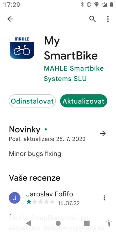

Yesterday, 25.7. updated the Fy.Mahle application, so I'm curious if there has been an improvement.
If the "My Smartbike" app worked well, it would be a very good, I would say excellent app. Where you can find an app - that will not only show % climbs.

Thanks for reporting the update.
The application is still rated at 1.6, knowing that 1 is the minimum mark. The comments (for whatever reason i only get the comments in french) are quite similar to the ones given in the forum. 99% of the people prefered the ebikemotion application and almost everyone report major bugs and lack of functionalities.
Mahle has all the feedback needed.
Note that quite many people report the application causing the bike to become disabled, my bike never got disabled but after an error code Orbeá asked firmware + some information and decided to serve the bike in one of their workshop. I don't know if it is related to the application.
Mahle state that the update fix some minor bugs, so i do not expect much.
