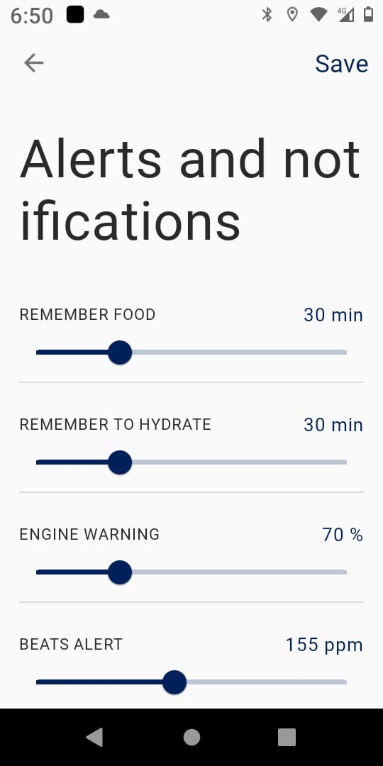

Probably the last question about the My Smart Bike application:
how does the "notification" setting work - nothing has been announced for me yet - never audibly announced.

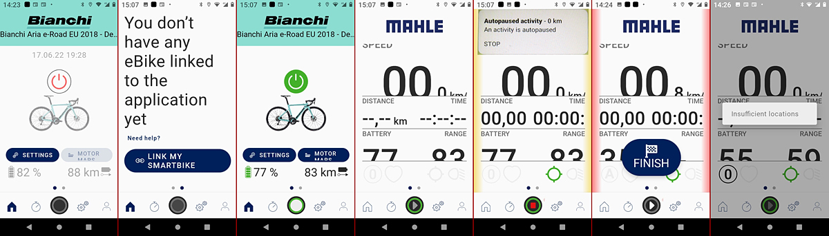

The application started to make me angry and he doesn't want to start before leaving for the trip.
I'm attaching pictures of the procedure and START can't be created - everything goes round and round.
Do you have no idea where the mistake is?
I also have a question if I delete the application and reinstall it on my mobile phone, whether I will not lose the information
that was there before - or at least whether the records will remain on the PC.
May be the lack of valid gps signal, anyway the application has very low marks on google store. In any case it gives a very bad image to Mahle.

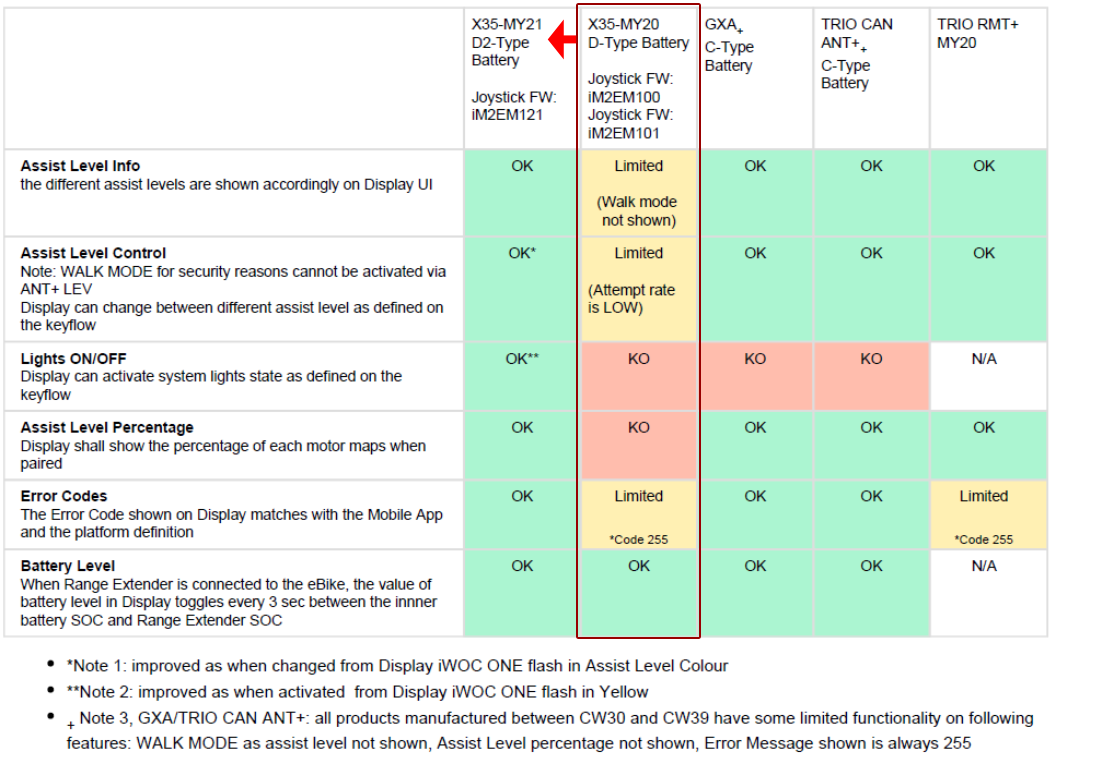

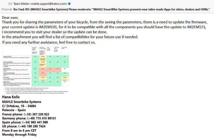

I have a bike for a year and I connected with Fy.Mahle (I sent all the parameters of the device), where they recommended me to update the firmware at the dealer - I still have MY20. Fy. Mahle highlights various new improvements to the new X20 engine, but that's all marketing bullshit and I'll wait for the opinions of the new owners of this engine, but as I write - some of us don't have this problem.
I'm far from the seller, so I'll deal with it at the end of the holidays and let me know how it turned out.

I have a bike under warranty, so I will deal with everything with the seller.

Hi Veteran,
Yes the new app release works better. But, recently noted during riding that the assistance level in use (no matter what level ) is returned to L0 automaticaly if I stop pedaling. Have you noticed that?
I didn't notice anything out of the ordinary, I think I would have noticed. I'll see next time.
