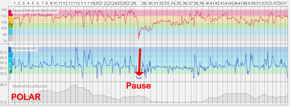

Today's problem. After 1.5 hours of driving, I went to the store to buy a snack and only the second half of the driving
was recorded, the first 1.5 hours are not recorded - it disappeared. I also ride with a Polar watch, where everything
(the first and second half of the ride) is recorded. Why not take an example from this watch (first activation and final activation).

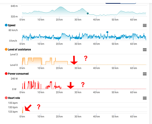

The application is unreliable.
Again, a significant part of the results is missing from today's drive after arriving home.

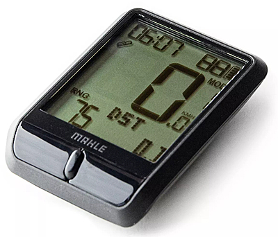

Let me understand your settings. First, I want to know if you are using a display device ( somenthing like the attached). What do you use to change assistance level ?

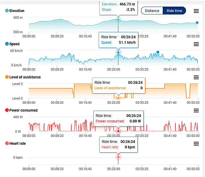

Today the whole ride was recorded in the program.
I activated the application and had the inner power drive constantly on (I often drove to No.0). I have the application in my back pocket and switching the degrees of assistance via PulsarOne still didn't work, so I had to set the degrees of assistance on the bike frame via Iwoc One and then the speeds were shown on PulsarOne. I still have to try everything, I want constantly set the speeds via PulsarOne and not on the bike frame, that doesn't suit me and I want to use drive settings no.0. If I find out that it doesn't affect the driving record, I'll let you know.
Veteran,
Nice to see you recorded a complete ride. I came to the conclusion that once the application is running and I have put the phone in my pocket, I should not touch it at all until the end of the tour.
I use small Orbea( like PulsarOne) device for Level assistances switching, I never use the button on the frame of the bicycle, nor the phone. In conclusion, once the application is running in the phone, it should not be disturbed in any way.

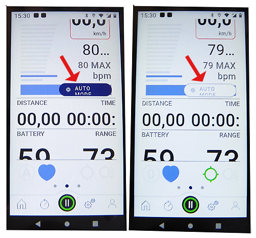

Also, I can't figure out what it means to turn AUTOMATIC MODE on or off? (in the attached picture).
Besides, I can't find the new MY SMARTBIKE in the PDF edition (instructions) anywhere, just the old system everywhere.
Automatic mode is to enable Level Assistance switch base on Heart Rate. Avoid that, turn it off . Many problems reported when is ON

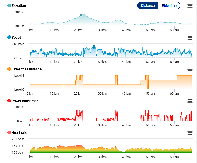

Great!! I have more than 50 ride without app problems. I like the app and the data I get at the end of my rides.
Interesting: Today I didn't have a heart pulsometer on and I could shift up and down on the PulsarOne and didn't have to frame.
Do you have a pulsometer monitor on while driving?

Check if your HR sensor is paired using Ant+ or BT. There should be a link conflict..
As far as I understand PulsarOne is linked to internal Mahle controler using Ant+LEV protocol. Your HR monitor ( pulsometer) or any other sensor must be paired to PulsarOne device in order to add sensors data with controler data and send it to your Android phone. So check that your pulsometer is correctly paired to your PulasrOne.
I use Garmin or Wahoo HR sensor as well as Garmin cadence sensor and Garmin power meter pedal, all them paired to Orbea Display( like you PulsarOne). No problem at all.
