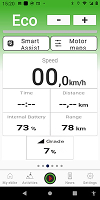

Maybe a stupid question on JavaGPZ:
The app in the PC dashboard also evaluates the % gradient on the traveled route.
Is it possible (maybe in the future) to have the app display these % currently also during the ride?

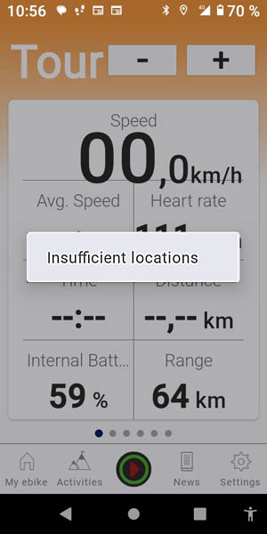

23.3.2023 - The application records all parameters well, but sometimes a message >Insufficient position< appears at the end of the ride.
I must say that the best (most reliable) application worked before updating ver.2.0.4. of 7.2.2023. - then there is always some minor error or deficiency.

Hello Veteran,
It is not possible because the server calculate the % of the slope. It is not something that we can do on the mobiles.
In the future we will add that information on X20 engines because have sensors but on X35 we do not have it, sorry :(
Best regards
Javier

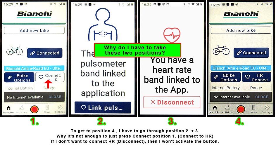

I have a question for the developer:
1. - I have to activate the button several times at launch:
Connect Bike + Connect HR + Link Pulse... + You have a Heart rate.. + and back to Start Again.
Why isn't it enough already with Connect Bike press on Connect HR - I don't need HR - I don't activate the button.
2. - Why the message sometimes appears?: No Internet available. I don't need the internet after all, or do yes?
Hello @Veteran it is possible that more than one HR band could be detected.
Because of that we show that view that could show a list of HR Bands. I see your point.
We plan to add “auto connect” on HR band so in the future you will not need to connect it manually.
Best regards
Javier
Best regards
Javier

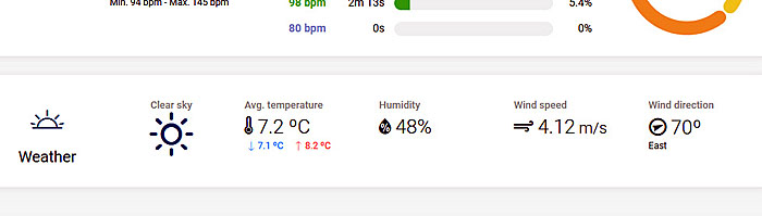

Thank you for answering and understanding my intention. Now I also understand your reasoning.
One more query: 3.February 2023 I had a WEATHER record and it has not been repeated since.
Is it a mistake on my part or was it an attempt on your part to upgrade?

You write about the reliability of the application.
I've had the opposite experience for two years now.
Just today I drove a very important and demanding section and at the end of the drive I got the message "Position Insufficient" when saving and everything was lost.
I think they should focus on storage reliability instead of inventing more gimmicks.
Otherwise, the driving records, if saved, are very good and beneficial.

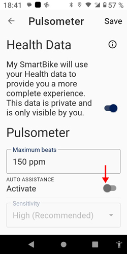

New - Changes to the engine assistance that I mention:
it is quite possible that I had activated: Pulsometer - AUTO ASSISTANCE and there was an auto assistance
and a change of engine assistance according to the Max. beats setting. In settings Pulsometer I canceled Autoassistance.

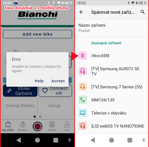

Now I got a new Android 11 mobile and I can't pair it with my bike, it keeps giving me an error. I don't even post my findings here anymore because it's hopeless.
My bike works well when I ride without the app activated, only with PulsarOne. I'm not going to update anything because I'm worried that
I might not be able to ride my bike outside without problems next time.
The only positive thing about the app is that it is free and the idea is very good, but the result is sometimes sad and unreliable.

The problems people seem to be having changing assist levels
I also had the problem to be having changing assist levels while driving, but I disabled AUTO ASSISTANCE in the settings and the problem has not recurred yet.
