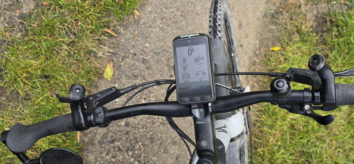

Mounting on different e-bikes
The first nice surprise was the ACE installed on my existing Redshift ShockStop Computer Mount (Wahoo) on my Vado SL. ELEMNT ACE is a huge device, and it is expected to not fit many existing mounts. However, Redshift Sports made its mount the way it is totally horizontal, and its top perfectly aligns with the suspension stem top. As the ACE is slightly raised above its base, the device fits the ShockShop stem ideally!
With the other e-bike, a Vado 6.0, I had to use the out-front mount provided by Wahoo in the kit. The mount is made of aluminium for strength, a sign engineers at Wahoo do sometimes think :)

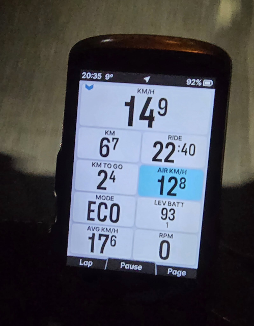

  • Air speed sensor (only available in the ACE). It is a Pitot tube that converts air dynamic pressure into air speed. Assume you are riding at 20 km/h but the Air Speed is 12 km/h. It means you effectively get an 8 km/h tailwind. Ride at 20 km/h and read the Air Speed 30 km/h: you are getting a 10 km/h headwind. The strength and direction of air is colour coded from Heavy Air Boost to Heavy Air Drag. I love the feature!

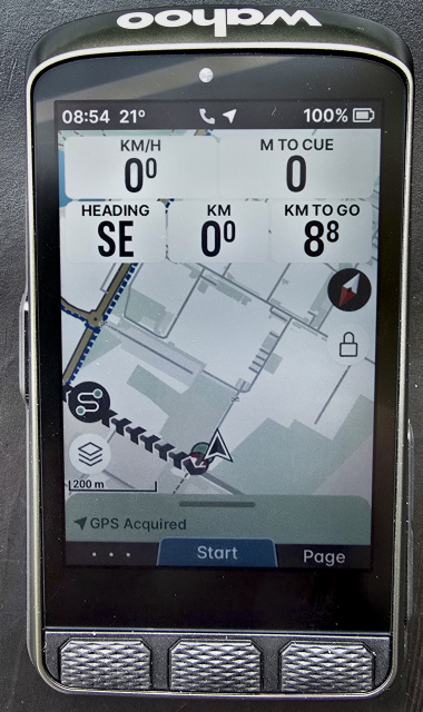

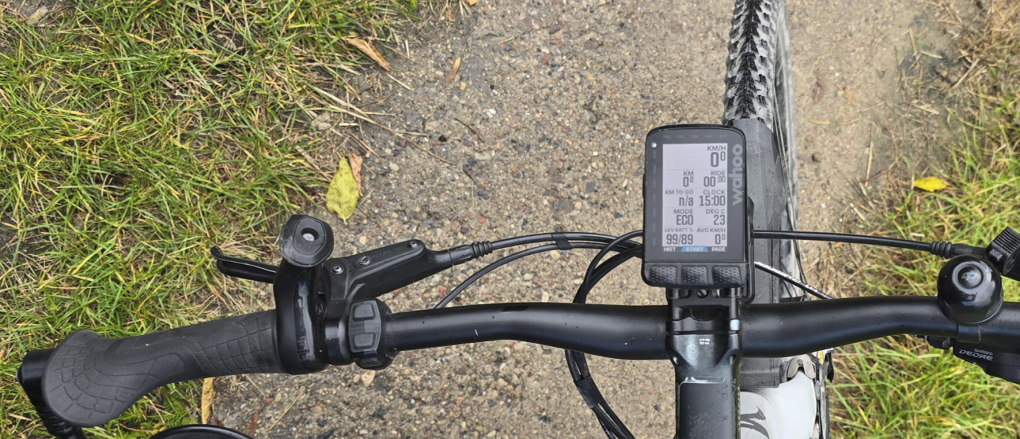

After leaving home. The device is still warm (17 C).

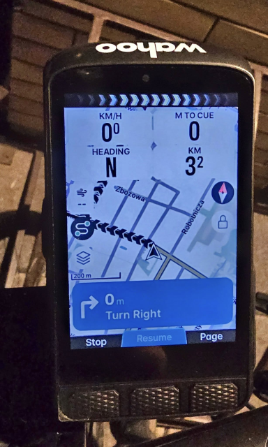

At the grocery store (2 miles away). You can see the LED emulation at the screen top.

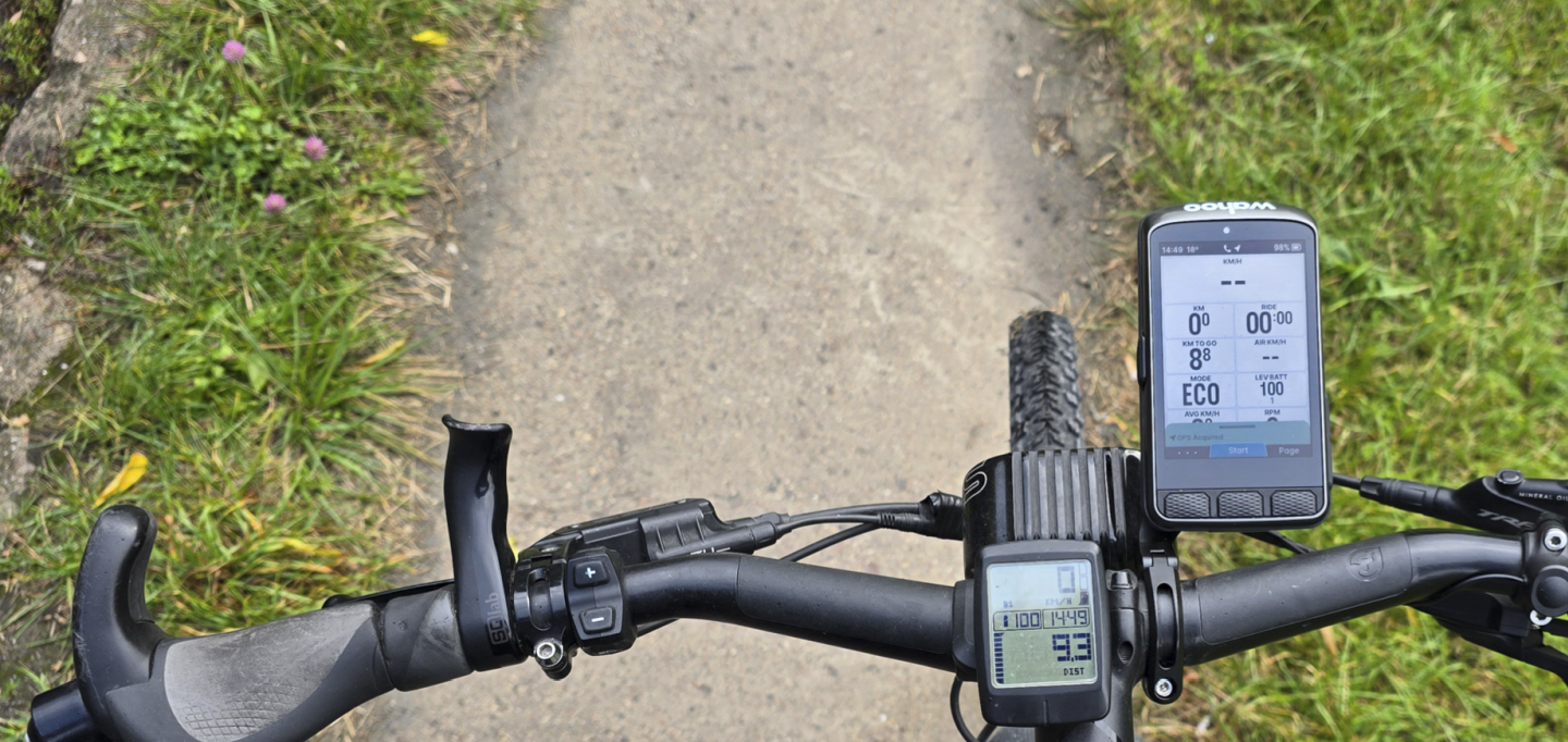

The thermometer giving a proper temperature readout (9 C). The Air Speed data field indicates Neutral wind conditions. Note: The Pitot tube has to be oriented forward!

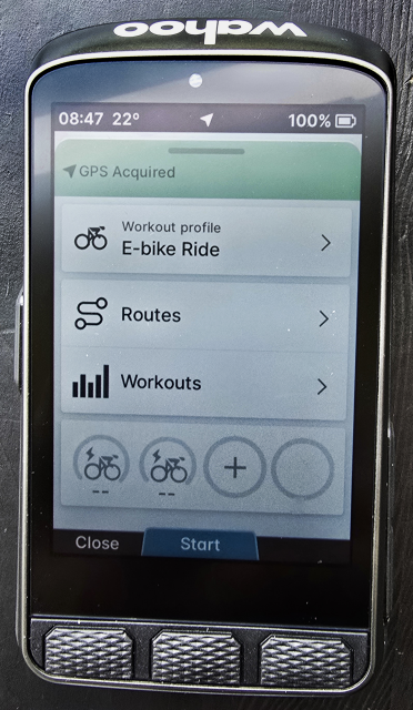

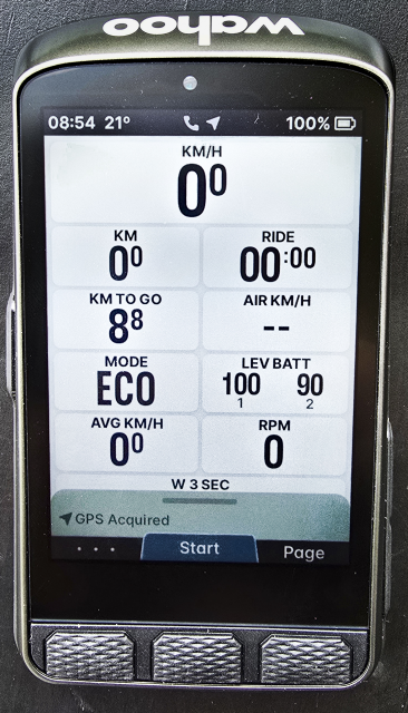

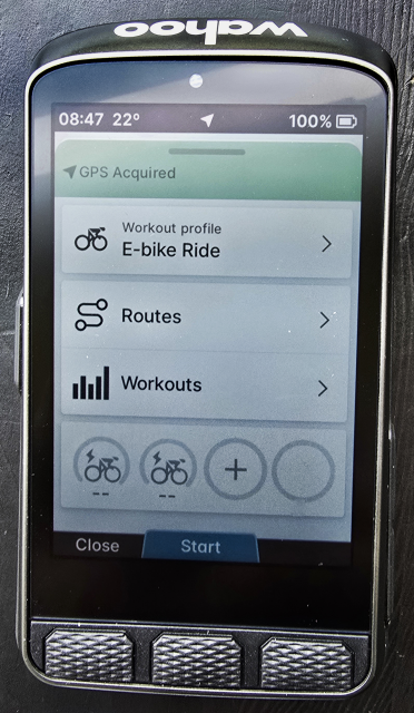

Ready To Ride screen. It shows the connected sensors (none at the moment), and basically serves selecting a Route before the ride start.

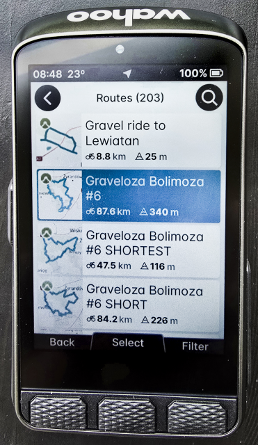

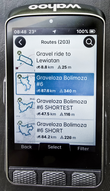

The list of Routes (automatically synchronised with Komoot here) is very similar to one found in Garmin.

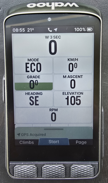

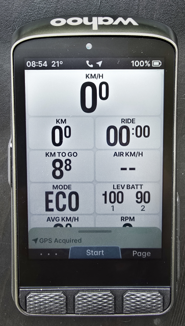

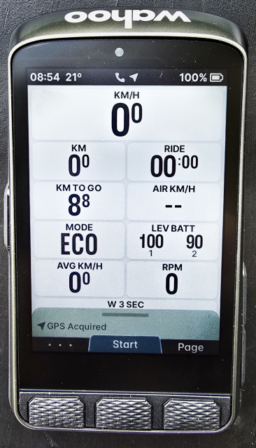

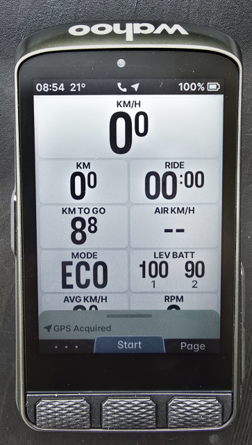

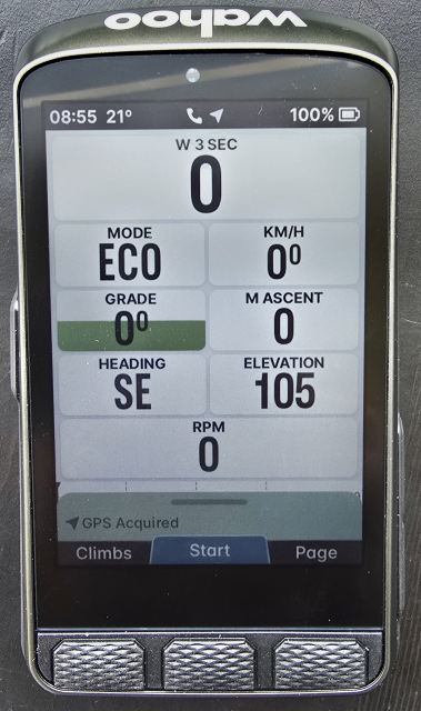

The ACE allows displaying up to 11 data fields in the Workout data page. An attempt to display that many fields in Roam v3 results in a unreadable page. The big size of Ace makes it possibly to clearly see all the data (it is as easy to see them on Roam v2. All Wahoo ELEMNT computers allow displaying the E-Bike Battery Level for dual batteries. No other brand can do it. See also Time of Day and Temperature data in the status bar: it frees as many as two data fields in the Workout data page.
Pressing the "+" button will reduce the number of visible data fields but will also increase the font size. See the Air Speed (Wind Dynamics) data field. The air speed field is colour coded from Heavy Air Boost through Neutral Air to Heavy Air Drag. It is very easy to calculate the effective wind speed (tailwind or headwind) or even assess the boost achieved by drafting behind another rider.

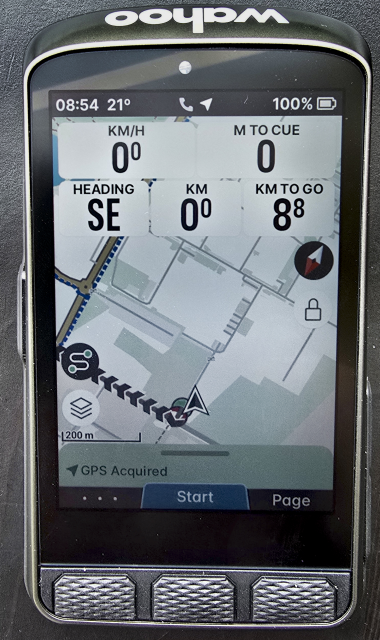

The map is now colourful and full of details such as street names or POI. The details can be controlled by Map Layers. You can unlock the screen to see more area around. Black arrows indicate the proper Course, green ones are for Climbs, and pale blue ones are for the re-routed course. Voice navigation increases the situational awareness. There even is a Bike Bell: double tap the screen or single tap any label above the buttons.

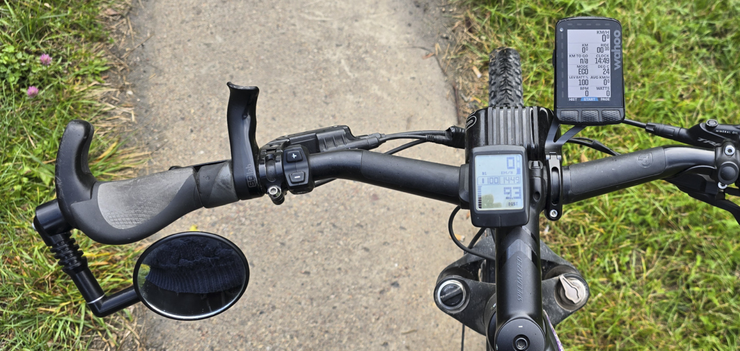

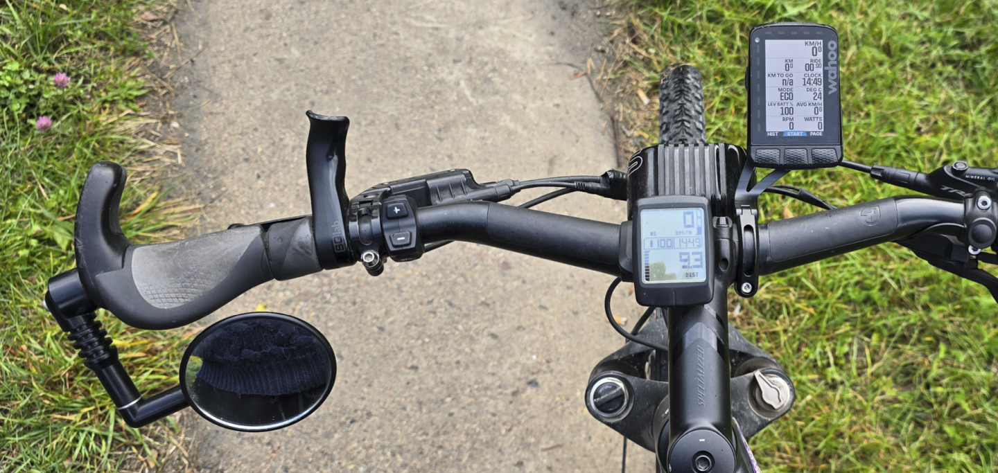

Size Comparison

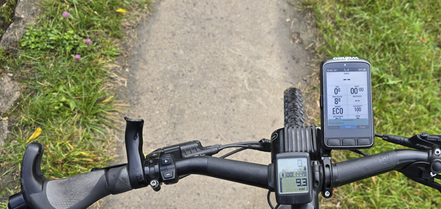

Wahoo ACE on a Vado 6.0

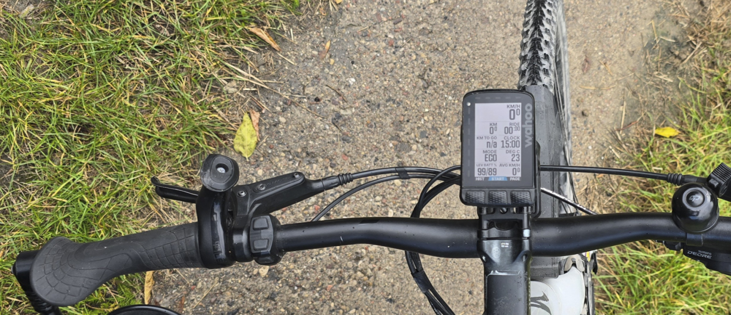

Wahoo Roam v2 on a Vado 6.0

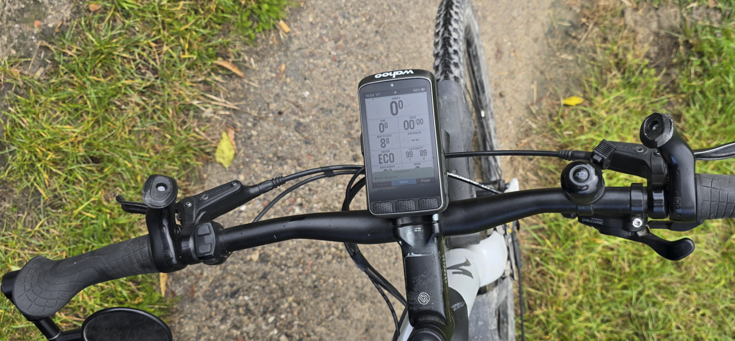

Wahoo ACE on a Vado SL 1 (Redshift ShockStop Computer Mount for Wahoo).
Wahoo Roam v2 on a Vado SL 1.
How odd it is the smaller and older device has a better readable and more contrasty screen, innit.

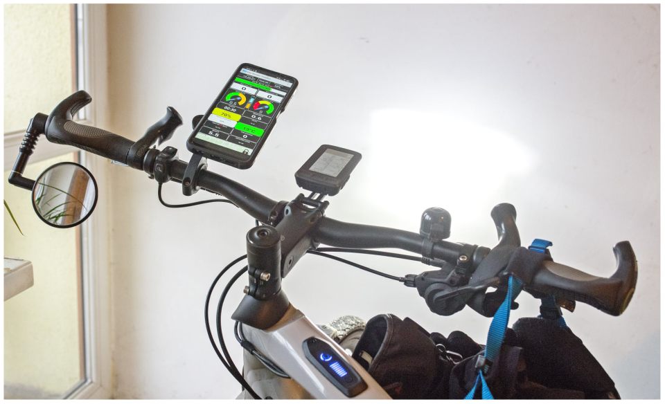

Thanks! As you know, I'm using the Specialized app on my large Samsung Note20 on my bar in lieu of a computer. Started to show you a photo of it in place to make you feel better about the ACE's size.
Then I realized that the phone can't be taking photos of the bar and on the bar at the same time. Duh.
My customer Patrice is training for her Spring '26 coast-to-coast bikepacking trip. This photo is one she took of a friend. She is doing 20 miles analog on a Surly three days per week and 50 analog one day per week. Then she goes to hill country the following week and rides 50-60 miles on her electric Prospero three days per week. And alternates each week. She is 71 and on days she does not ride she does weight training. She is like Wonder Woman. And is intrinsically motivated and does not need to prove herself to anyone. That is the contrast. She is the real deal.
Same here. I wanted to compare the size of Samsung U24 to the Ace and then realised the Roam could not take photos :)

  • The battery has a huge capacity. Over 5 hours of the device on only ate 12% of the battery charge

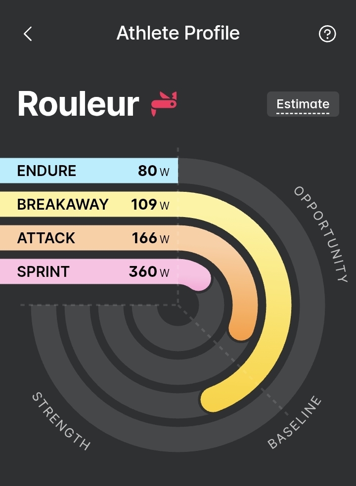

Some fun related to the new Wahoo App (that has replaced ELEMNT Companion App for v3 devices)
The App has asked me to fill in a questionnaire; the objective was to create my performance profile. When I answered all the questions the it turned out the idiotic algorithm has overlooked the fact I was riding an e-bike :D So the calculated FTP was enormous! :D
Then I repeated the procedure with assuming my FTP was 80 W and only then I got more realistic figures....
