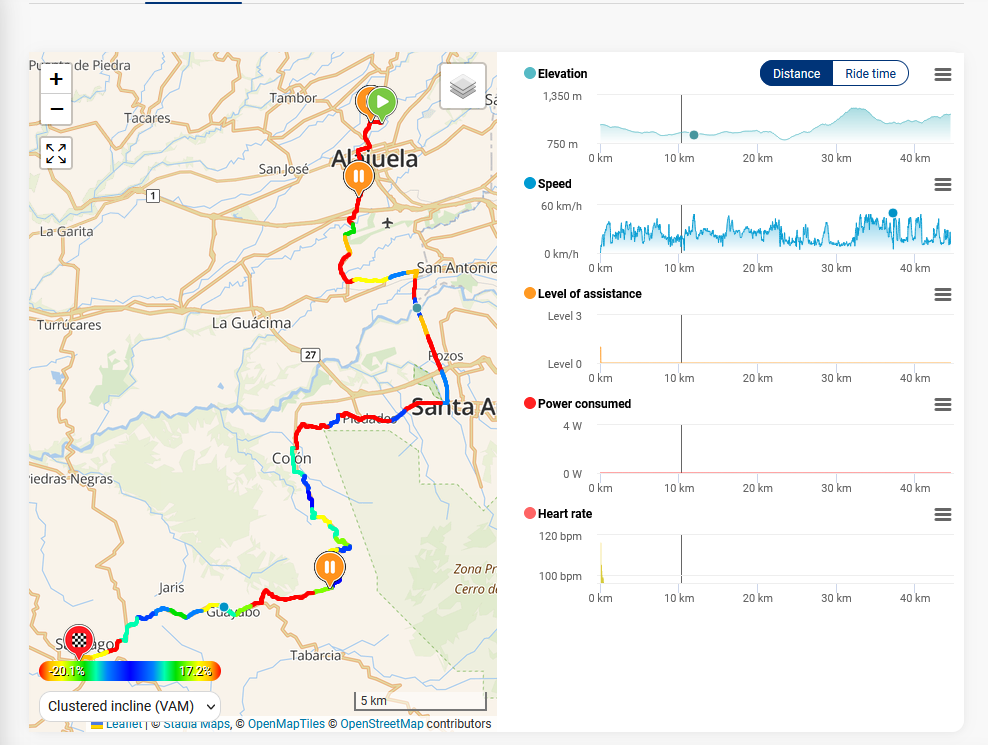

Hello everyone,
For a long time I have used MySmartBike app on my Android phone to record data such the level of assistance, power, voltage, % remaining charge, .. and others.
Curiously since the launch of the new version of the app, it has been impossible for me to register said information.
The app connects to the bicycle, I press the button twice, the application indicates that the data recording has started, but at the end of the journey there is no recorded data. Just distance and speed. See attached photo.
I would appreciate any suggestion on how to solve this issue.

@JaviGPZ, I'm sure you're messing something with that app.
I recently got a new phone, Googl Pixel, Pro version. Original, pure Android, high reliability and GPS accuracy. And although I promised to give up the app, the devil did not give me peace. I had to try, one more time.
Tried it! Does not work.
Well, if it doesn't work on stock Android and Google's most advanced phone, then you're really messing something with the app, which you shouldn't. Otherwise, I don't see any reason why the app wouldn't work.
I'm really angry now. Sorry community.

We are having issues on Android during the connection process. Sorry for that, we are working very hard on it.

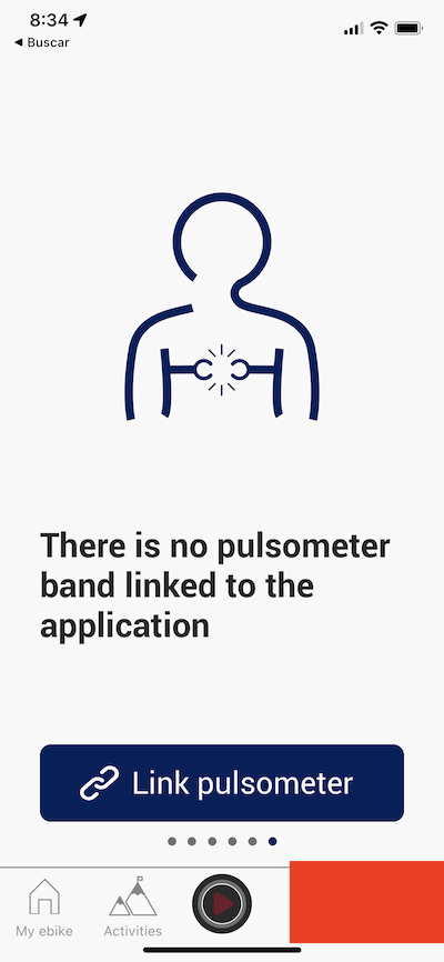

If you use a Heart Rate band and connect it to our app you can activate "Auto HR" that will increase or decrease the Assist level using your Heart Rate.
You have to configure you "Maximum beats" on Settings -> Pulsometer. Then the app calculate the best assist level trying to never arrive to your "Maximum beats".
You can decrease your "Maximum beats" to start the assist early (my maximum beats is 180ppm but I set it as 150 to receive assist early).
The band that you need is a band with Bluetooth (usually are dual bands with Bluetooth and Ant+) and you need to connect it on the app. Is easy, on the Monitor screen on the last position you can connect the band with Bluetooth.

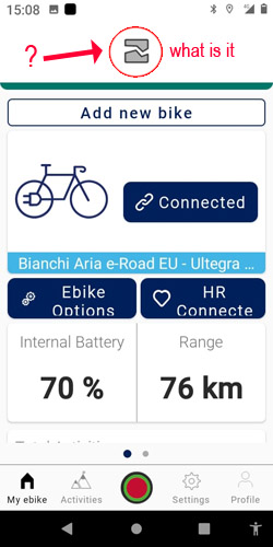

Hello Antonio,
If we use GPS you will calculate the slope based on the height of previous GPS location compared to the current one.
The value is in meters but looks like it have decimal values... I will modify an app to get a position every second to check the precision luckily this weekend will not rain an can make some tests :D
The biggest problem that i see is the GPS chips and antenas that use every phone. On iOS we can asume that have good quality but some cheap Android devices could have cheap chips with low quality.
Best regards
Hello Javi,
I know that you are very busy improving and fine-tuning the Mahle application, but I just want to know if there is any progress with this idea or if it will not be considered at all.
Best regards
@Veteran looks like you connected your bike with not good internet connection. Because of that the image was not loaded. Try again near your Wifi
