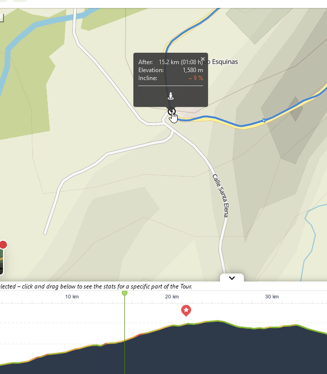

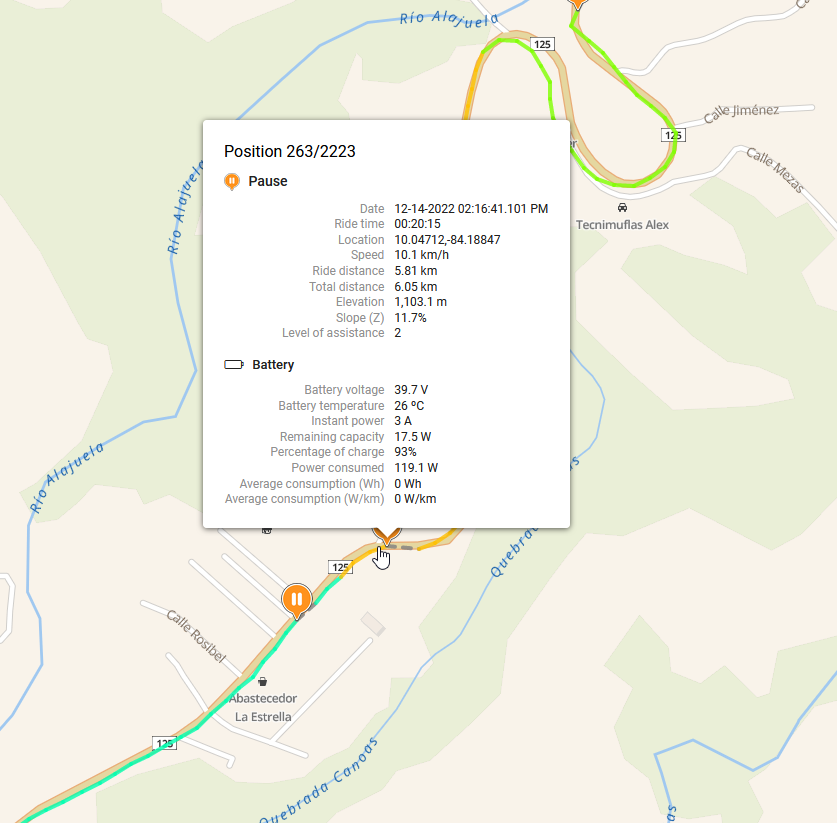

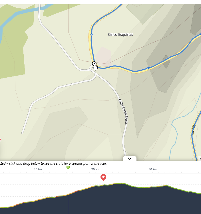

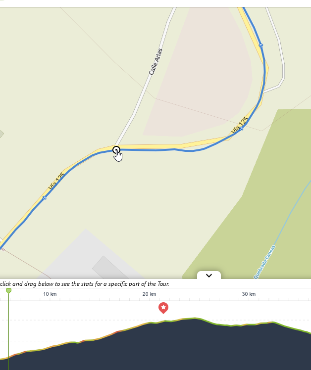

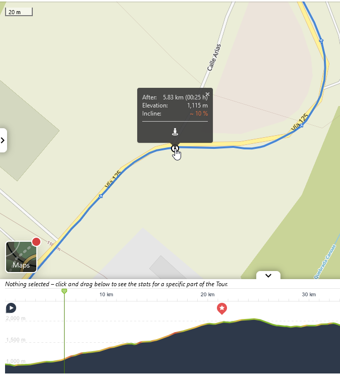

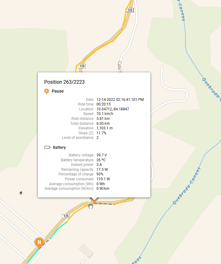

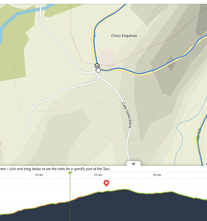

I want to attach some basic slope measurement results with the Mahle app and with the Karoo Hammerhead cycle computer. I show you two results that were taken at two different points using an easy reference point on both maps.
  • 2022-12-15 07_44_56-Alajuela_Carrizal_VaraBlanca_Poasito_Alajuela _ road ride _ Komoot — Mozil...png
  • 2022-12-15 07_42_49-Alajuela_Carrizal_VaraBlanca_Poasito_Alajuela _ road ride _ Komoot — Mozil...png
  • 2022-12-15 07_48_31-Alajuela_Carrizal_VaraBlanca_Poasito_Alajuela _ road ride _ Komoot — Mozil...png
  • 2022-12-15 07_48_58-Alajuela_Carrizal_VaraBlanca_Poasito_Alajuela _ road ride _ Komoot — Mozil...png
  • 2022-12-15 07_44_15-MY SMARTBIKE - Alajuela_cCarrizal_Vara Blanca_Poasito_Alajuela — Mozilla F...png
