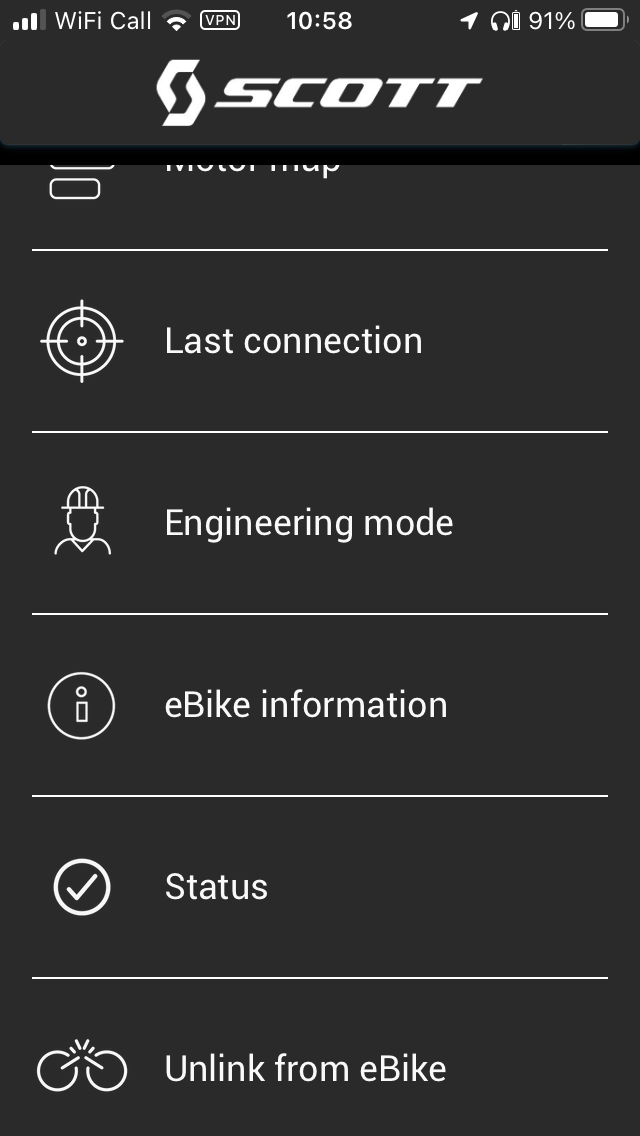

Also when you go to bike status page engineering page etc cannot return to home page or go back a page you have to close app and reopen

Hi Dave,
Maybe it is not easy to tap on that button, probably we should make bigger the tapping area.
But it should works if you tap there. Please let me know if it is completely impossible to go back and let me know the iPhone and iOS version that you are using.
Yes the Error 32 is a Firmware issue, sorry.

No visible back button to push
iOS 16.1.1 this is the latest OS
