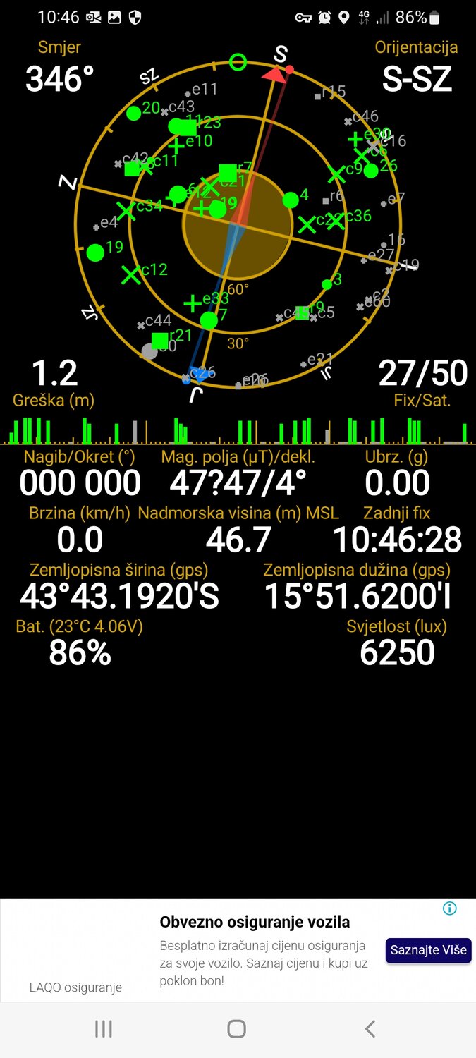

since june i can't record my bike rides. Last time I could do that on version 1.0. After, it seems to me, June 13, and version 1.1.1, until this latest ver.1.1.6, always the same story. It starts properly, and after 4-5 seconds it stops (screenshot_1.) after "exiting" (screenshot_2.) a message is received (screenshot_3.). The app properly connects to the bike and properly reads engine maps and so on, but it will not record the bike ride at all.
I've tried everything:
- turned the phone off/on
- turned location off/on manually
- closed/opened the application
- repeated multiple times with starting recording
- unpair from APP and re-pair bike
- uninstall APP and re-install again
- disable battery saving or optimizations
- cleared memory cache before reinstallation and afterwards
Phone model: Galaxy A31
Android version: 12
I would be very, very grateful if you could help me.
Hello,
Your problem it is a GPS issue. During your rides the locations that the app get does not have enough precision. Because of that the the app did not record any position and you do not have distance.
Are you using a third party app to save battery?
Does the gps work well with other apps like waze, google maps...?
Possible solutions:
1- Settings > Apps > My Smartbike > Permissions > Toggle Location ON
2- Settings > Apps > select the menu in the upper right-hand corner > Special access > Optimize battery usage > All apps > Toggle OFF for My Smartbike.
3- Check that your location settings are set to High accuracy. Settings > Connections > Location > Locating method > High accuracy.
4- Perform an "AGPS reset" by installing the App GPS Status & Toolbox, then in that app, go to Menu > Manage A-GPS State > Reset.
Also you can use this app to check your GPS:
If you do that go to the street and let me know the accuracy range.
Let me know if something works for you
Best regards
Javier

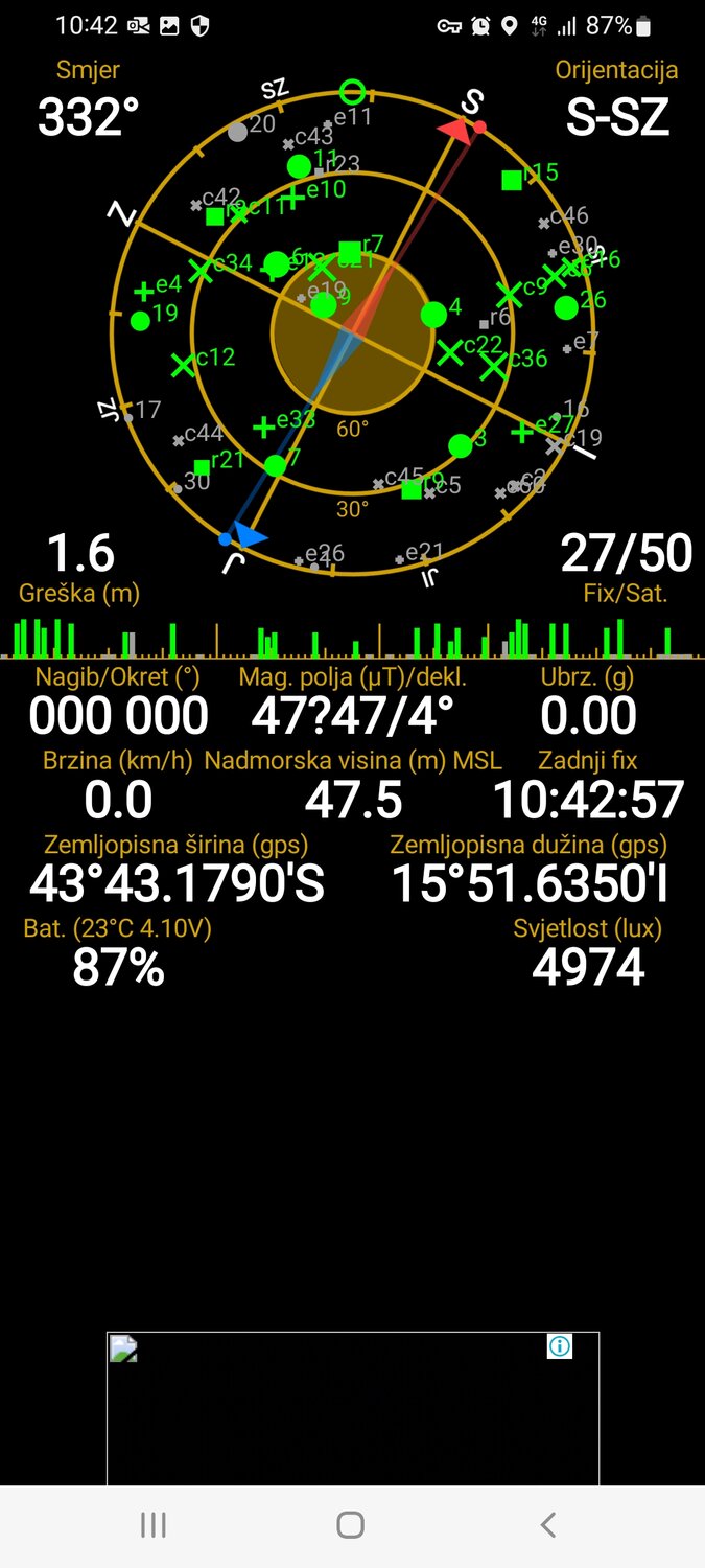

Thank you for your reply. I turned everything on/off as you wrote and it won't work properly. I even turned off the antivirus. The result is the same as before.
All other apps that use location work perfectly fine.
I am attaching a screenshot for GPS_Status on my location.
I don't know if it's blasphemous to ask - is it possible to reach ver. 1.0 that worked for me?
You are welcome. I asked to the Android Devs. Did you try to delete all data from the app? This force to recreate the local database (maybe it is not a GPS issue and it is a local database issue).
Here it is explained how to do it:
Let me know if it works. If not works we can think other solutions.
About comeback to the version 1.0 it is not possible because we modify a lot of things on the networking with the server and it is nos compatible.
Thanks again. Earlier, I already tried deleting all data, cache, and even uninstalling the My SmartBike app itself. Without success!

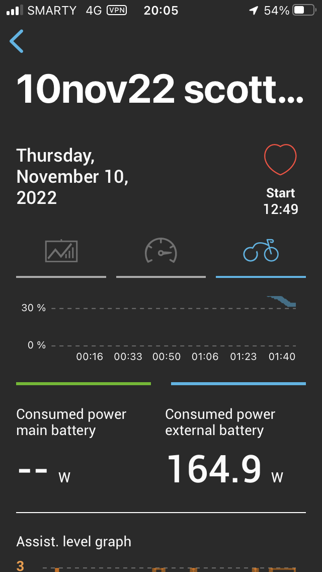

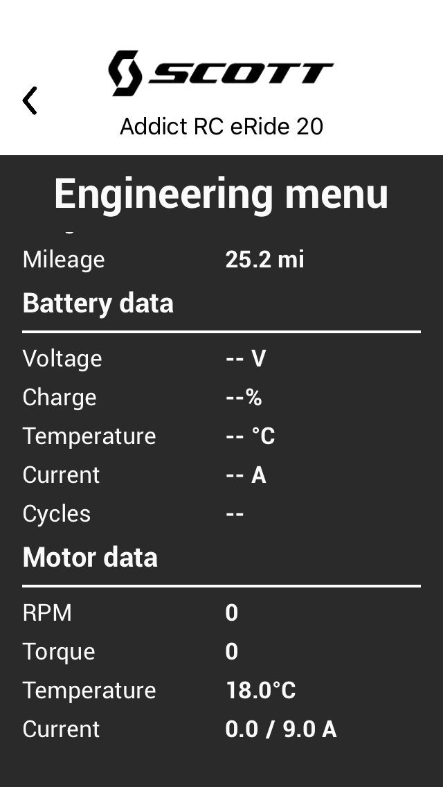

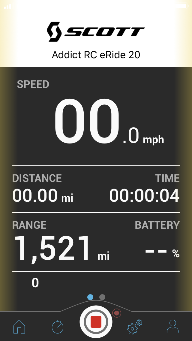

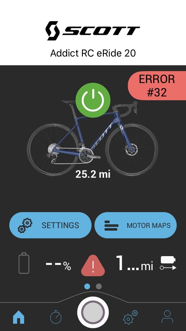

Hi all
ok I have been riding an orbea gain m20 for about 28 months 12500 miles with the app no issues all good
just got Scott addict 20 x20 motor
2nd ride
so here my issues with the app
Motor maps don’t work
No battery % on home or ride page or engineering page
so remaing battery for ride % all over the place which it would be as it uses battery voltage to calculate
Battery usage KW Zero after ride
but external extra battery KW has a used figure so appears it is mixing up main battery with external extra battery even if you don’t have one
I don’t have one
Error 32 comms issue
Pulsa one works perfectly and includes correct battery % except distance calculation for battery same as app all over the place
So it appears to be a firmware issue to me
MAHLE please get this sorted releasing a new system with this many issues should not happen

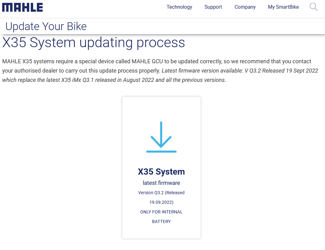

Welcome to the strange fascinating world of Mahle error 32. I have had it repeatedly at first. And all the book says is “communication error”. Which is supposed to reassure us.
First of all I would check on the support page of the Mahle website and download the latest firmware versions in case yours is still running the original ones from before August. This download helped a lot and I hardly ever get error 32 now.
There are no motor maps available yet for the X20. They are coming in a future firmware release.

Not to bothered about the error 32 it just a bug as it does not effect the bikes function it is frustrating that the app is so flaky as the the app on the orbea x35 worked perfectly

Error 32 comes up every time I use the Mahle app. Actually I stopped using it, it just displays errors and things like motor maps not implemented yet. It frustrates more than it helps (I have the latest version and latest bike / charger firmware).

Hello everyone,
Looking at the Mahle page, I see that there is a recent update to the X35 system firmware. Unfortunately there is no information about what is achieved with this update, so I would like to know if anyone has any experience with it and if you can share your experience and knowledge. Why is necesary to update the firmware ? Thank you very much.
Antonio

As for the question from Antonio
I believe the update firmware on the x35 was just for the battery
But don’t know the details
The problem here is you have to go back to the dealer
