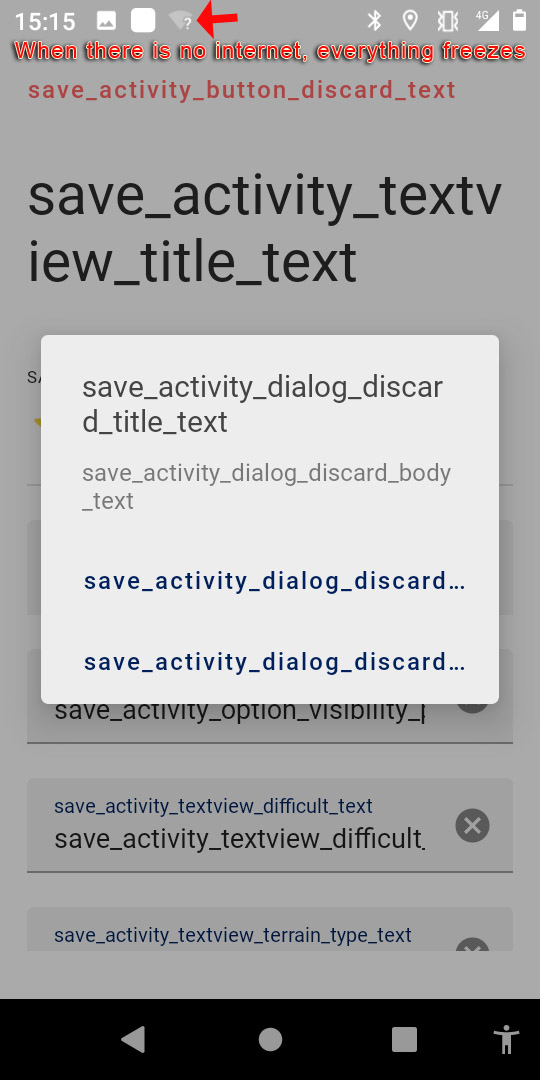

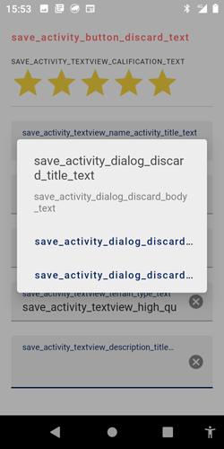

1. Yesterday the application consumed max. 10% in a radius of 60 km - never a problem for me.
2. I wrote above about the PulsarOne issue where it doesn't work with the X35 engine if the APP is on, sometimes it does, sometimes it doesn't.
Otherwise, it works well independently. I don't deal with it anymore, mainly because I ride my bike.
The dealer update link is a problem, the dealer is 350 km away. Updating via APP would have to be solved - it would be a better solution.
3. My biggest problem - I don't have network from the operator on my mobile phone:
I can run the app anywhere and it doesn't need to be connected to a network.
The problem occurs when you exit "FINISH" - if there is no network available (home or mobile operator) everything is always frozen and lost.
I have to restart my phone. If you "SAVE" at home where there is a network, everything is OK.
Image attached below.
Otherwise the app works fine for me. Thank you for its development!

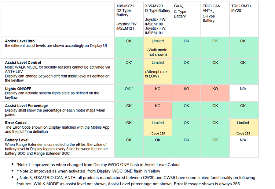

X35 update - does the update from iM2EM101 to IM2EM121 affect the engine?
After exceeding the speed of 25 km/h. I feel gently a certain friction (resistance) as if the motor has not disconnected at 100%
and it still has an effect or the magnets are causing the resistance. After exceeding the speed of 31 km/h. and more - this resistance (friction) already disappears.
On Italian Discussion writes about the same feeling a friend, it's obvious that I'm not alone.
From the update table* photo below, it does not appear that the update refers to the modification of the engine operation, only to the modification of the SW.
Not every dealer has the bike I bought, and apparently the dealer doesn't have an obligation to update,
which is for further legal analysis. In addition, they will not point out the possibility of updates when purchasing,
which will surprise many customers in the future. I would have to make one 350 km trip to the dealer with the update.
Today, you already solve the problem with the X20 via the charger, which is progress, but you forgot about the X35.
A trip to the dealer for the tour to take 700 km. it is also not a cheap affair.
That's why I constantly "annoy" your Fy. Mahle or here on the forumor or Martha Chavez, Hana Kolic, Nadine Wehking, Andrea Herak-Ignjatov, Jaume Jumbert :(

Hello Veteran,
Thank you for your feedback. We fixed some stability problems on the last two updates. Probably some of them affect to the activity without internet.
Anyway soon we will release a fix releated to lose the translations if you open the app without internet.
On the other hand we are testing for a future release to fix more problems related with stability on the activities.
About the firmwares... there I am a little bit lost because it is out of the scope on the company.
Thanks for you our app ;)
Best regards
Javier
Thank you for the information, in cooperation with Fy. Bianchi, I am looking for a closer option of service e-bike.
With the X35 engine, I have been dealing with this for a long time (12.100 km) in which I have already got used
to and adapted the ride to bypass this problem (I pretend not to have it).
It would be advisable to combine the charger for the X20 and the possibility of updating the X35 (Maybe I'd buy it).
I assume the connectors will be the same.
the update does not affect the engine, the x20 charger does not work for x35
I am sorry but the connection on X20 and X35 are different. You can not charge or update a X35 bike with X20 charger.
I suggested the possibility of extending the use of the X20 charger also for the X35,
so there is no need to bypass the sellers who are performing the update X35.
I wrote that not all sellers do this. Just because the X20 engine went on sale doesn't
mean the X35 engine will be handicapped in new technologies.
