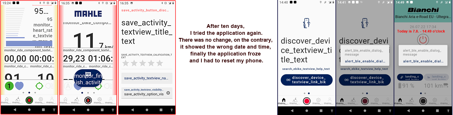

I updated on 26/7. and test drive on 27/7.:
1. - Start / 2. - Finish and press the blue button / 3. - Everything froze and no matter what I did - could not save!
While driving, I app. he didn't do not follow.
Time and kilometers recorded well, the rest of is probably not.
So I don't know - no change for the better, still a problem.
9.8. - I uninstalled from my mobile

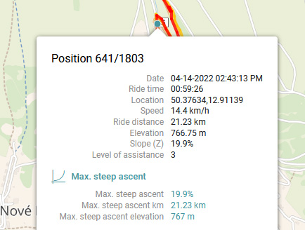

Question: Do you also see "Slope - (Z)" on Garmin Edge - if so, what type do you have. Thank you
