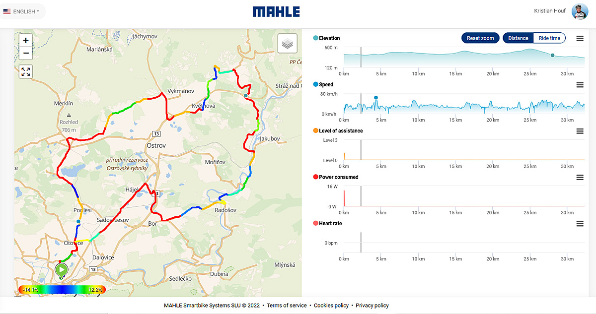

Orbea Gain D50 ( User learning and experiences )​
PC Dashboard does not show me on arrival / return:
"Level of assistance" and "Power consummed".
Can you advise me where I am making a mistake after connecting MySmartbike?
"Heart rate" - I already know how to activate from the post I read here.
About the new app: I use a Polar watch and Polar Flow app, and the new My Smartbike app I is still being tested out of curiosity.
I hate with this new app. only a long time after switching on and connecting to the bike. He searched for the GPS signal for a long time.
Thank you
Thank you
Something similar happened to me once. In the middle of the tour I stop to take some photos and have a coffee. After a few minutes the ebike turned off the assistance system, then when I continued with the trip I did not realize that I had to activate the app again. When I got home I only had a HR record for the second part of the tour.
I came to the conclusion that if the app is not activated, we will only have HR records.
Something I don't like about the Mahle assistance system is that if you stop for a few minutes (I haven't counted how many) the system turns itself off, and this affects the data recording in the app.

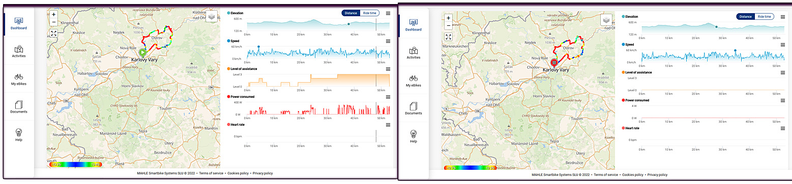

From another post, I already know how to activate the heart rate, but for others, after activating MySmartbike,
it is always uncertain what will eventually evaluate me - one way and the other. I don't get it and I'm probably
doing something wrong when I'm driving the same circuit.
Sometimes I read during the discussion that it is decisive whether the Pulsar One is switched on first and then the bike or vice versa.
The My Smartbike application needs some modification to simplify the whole process so that to always show all the options
and not just the ones I am forced to set before driving -
(Heart rate activation by swiping the display to the next page - I don't understand why it's not activated all the time?)

I respond to the above instructions.
Why solve No.4) + No.5) + No.6)?
Just No. 3) = go through Ebike with the application - I sit on the bike and go.
When I got back from the ride, every time! there was always something missing in the evaluation of the ride.
I do not understand the complexity of the solution.
