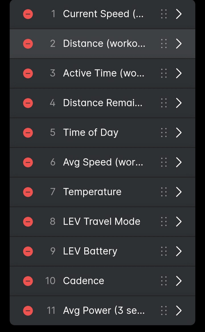

What about the LEV Travel Range data?

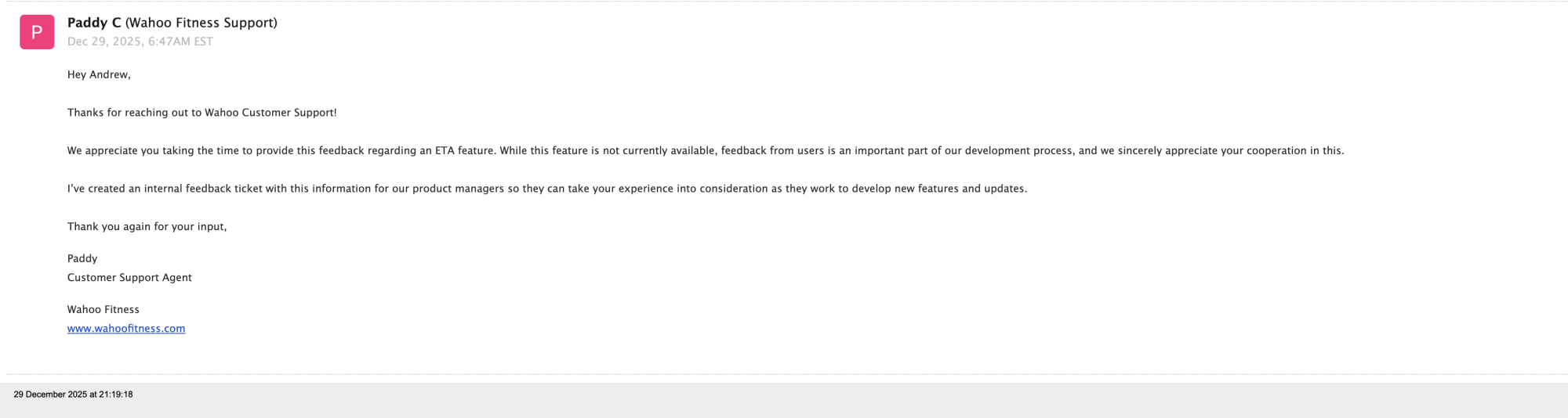

ETA has never been a Wahoo feature, sorry.On my Garmin 103,0 it can display the ETA when navigating, but I cannot find something similar in the ACE.
