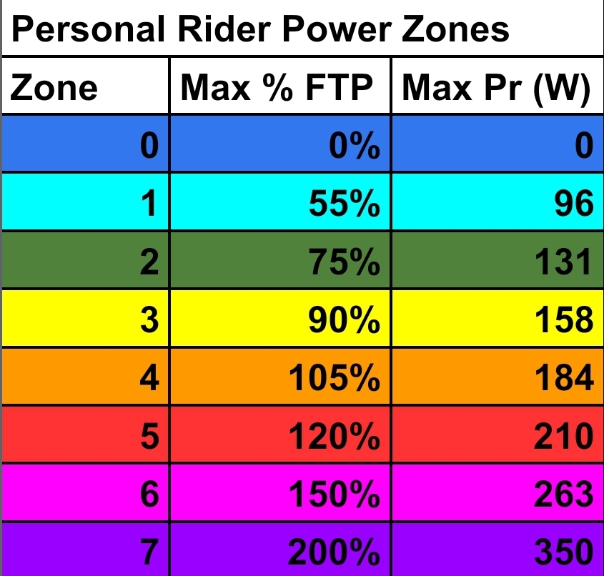

Have yet to test my FTP, but used a reasonable guess from my Pr data (175W or 2.0 W/kg) to set the Pr zone boundaries above.
Followed all but the part of the quote I put in bold. Could the 170W and 150W figures there have been reversed?
Yes, I went back and fixed it. The point was, the ability to put out more power without feeling more fatigue, and thus more speed, may be due to increased fitness. It may also be due to better rest. It's all related. You've ridden many miles, and know your body. The data is there to correlate how you feel with actual data. It's necessary to track all this if you compete at a high level. It's nice to have if you don't. I've been riding with power data for over 15 years, so it's part of my ride experience.

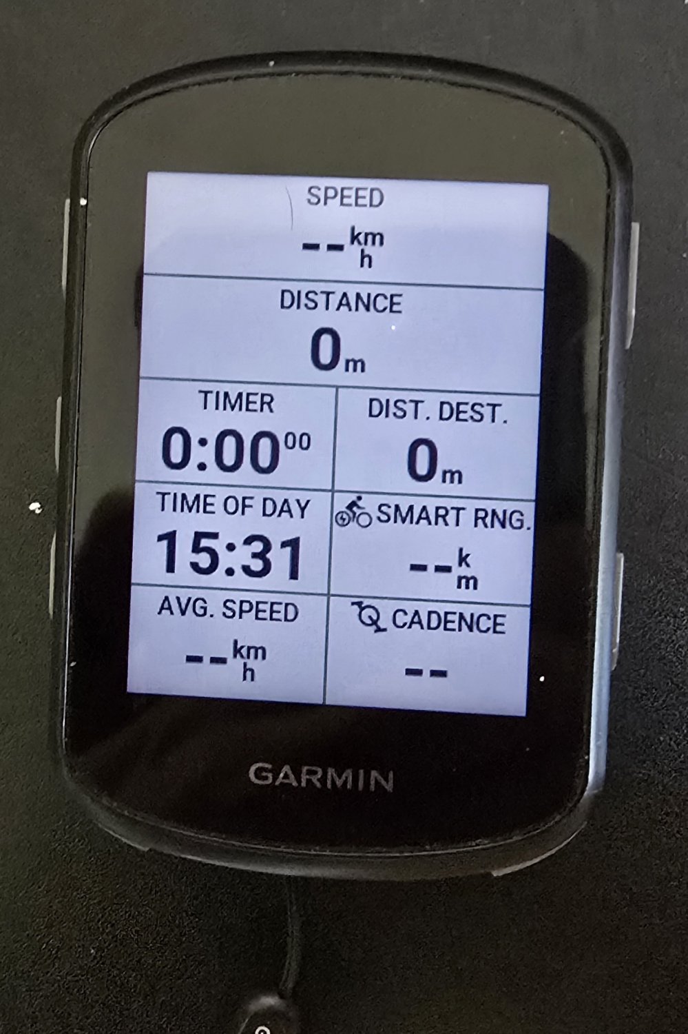

Pertinent to the OP:
Q1. Minimum number of data fields you could get by with for routine riding — across all displays in your cockpit?
Include only fields accessible with at most a single convenient button press. Exclude navigation.
Q2. What would those essential fields be?
I'll start.
Q1. 6
Q2. Assist level, battery remaining, ground speed, cadence, rider power, time of day.
All 6 fields are available on my Vado SL's built-in display (Mastermind TCU) over 2 pages I can toggle with a single button press on the handlebar remote.
Keep a phone on the bar mainly for recording and nav purposes.

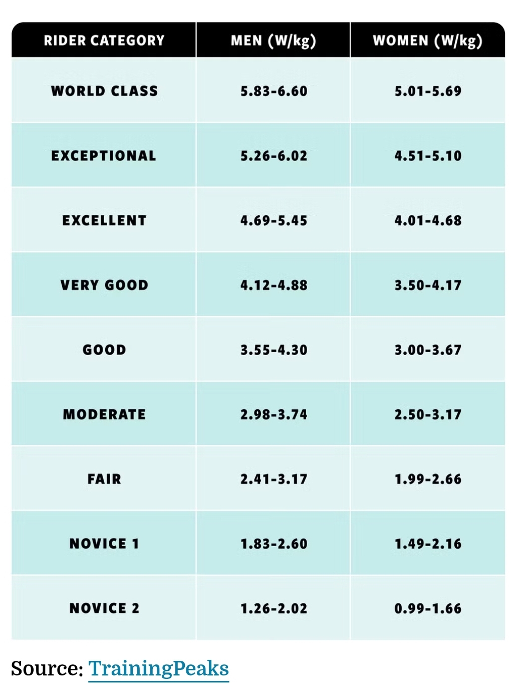

Hard to find places to do even an 8-minute max effort undisturbed. The best bet nearby is the flattish, straightish 9-mile paved bike trail along the San Luis Rey River east of Oceanside. Allowing for small disturbances on both runs, yesterday's 8-minute test there yielded 185W (2.1 W/kg).
OK for a 76 year-old per this chart...
...but not even "fair" on this one. Pogi's current FTP is literally off this chart at over 7 W/kg.

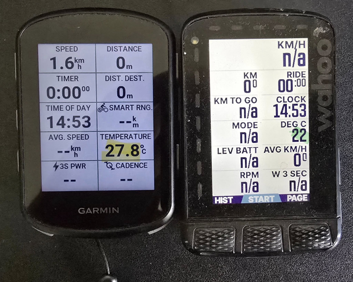

The inaccuracy of the Garmin Edge thermometer was the last straw. In the warm season, the Garmin thermometer shows temperature higher than actual by five degrees Celsius, which is totally unacceptable.

Thermometer and barometer are two sensors that are more "general sense of what they are measuring" on any bike computer IME. They've gotten better over the years, but have never been super accurate. If the computer is in the sun it will read much higher than ambient anyway.
It was 22 C inside the room.
Wahoo is -3 C off below 15 C, which is consistent on any Wahoo computer but it is accurate from 15 C up.
I checked my 530 just out of curiosity, and it says 72 in my office which is actually 69 or so. So it reads 3f high, which is 1.5c? I've never had temp on any of my data screens.
I guess if thermometer accuracy on a ride is important to you, get a wahoo. I personally just look at national weather service before I ride. :p
I use Wahoo on my Vado SL and indeed I use the thermometer there. With a Garmin on Vado 6.0? Well, will occasionally check the accurate weather forecast (Weather Underground) on my phone.
The thermometer is an important information source during my winter rides but also in the Spring and Autumn, when the evening temperature can suddenly drop. Last Summer, I had an interesting observation during a group ride with friends on a hot day. We suffered from the heat and I asked my friends for a stop by a convenience store, where I quickly had a cup of hot coffee. When I finished, I asked my friends "Seems to have cooled down, hasn't it?" The female friend said I only felt that way after drinking hot coffee fast. We restarted the ride and I could see the ambient temperature dropping and dropping every minute on my Wahoo! It was some strange phenomenon!
I have ambient temp on my Garmin (830) screen because I have room for it. It is nice to know, since the weather changes quickly here. I do have the weather alerts active.
In my experience, my Garmin one has, at least in the past ( I do not bother with temperature nowadays), reflected the temperature on the bike, that is the heat radiating from the road as opposed to reported or ambient temperature. I actually found this more useful, e.g., 50 C on the bike in the summer versus 40 C reported by the BOM.
How come Wahoo reports the ambient temperature correctly but Garmin cannot do it?
A friend who is a Garmin fanatic admitted himself Garmin Edge was +5C off in general. 22 C and 27 C is a fundamental difference. I compared the measurements of both in a room protected from the sunshine by curtains after the two computers were laying aside for many minutes in a controlled space.
