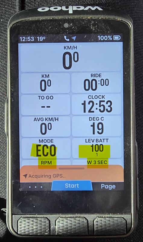

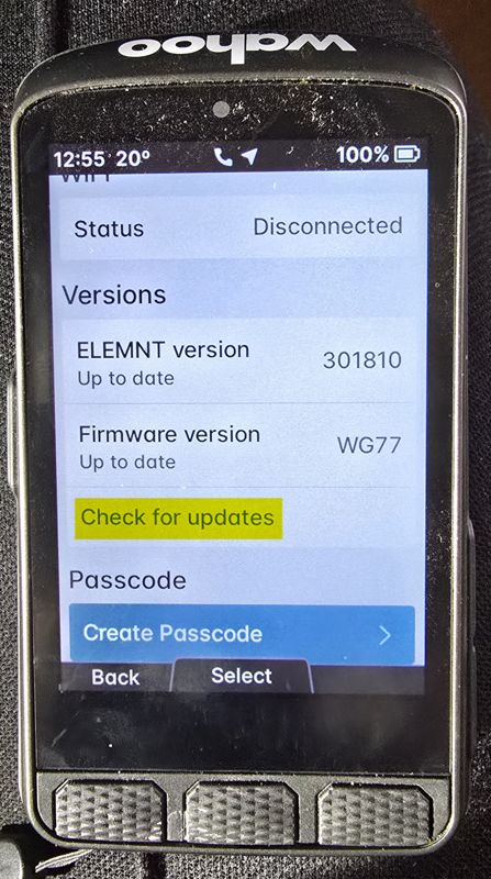

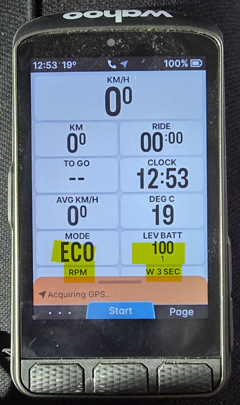

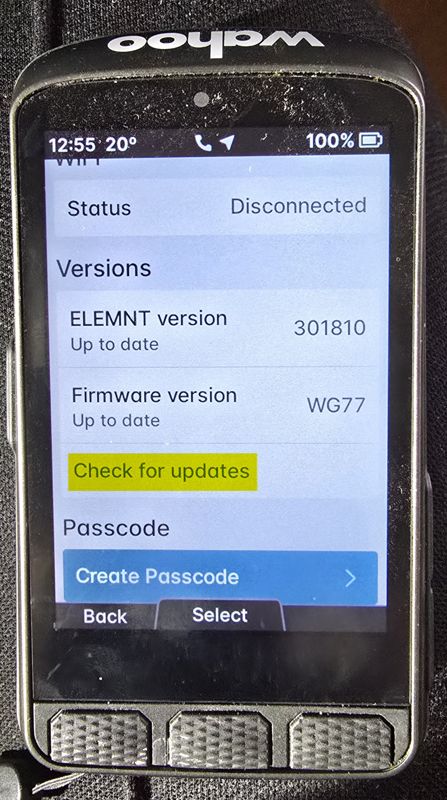

It is now up to two numbers, each for either dual battery. It came with one of firmware updates (which you do from the device not from the App!)does ACE now display the LEV Battery as an icon or a number?

My Ace has not displayed the LEV Battery level, the data field is there, no data is displayed? Maybe you can assist me with this one?

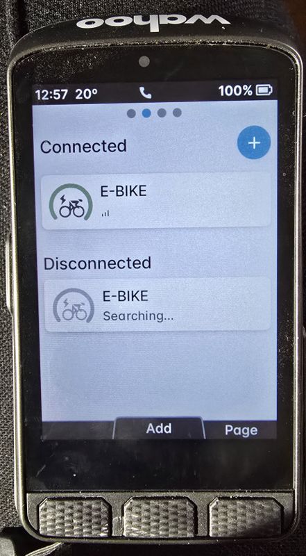

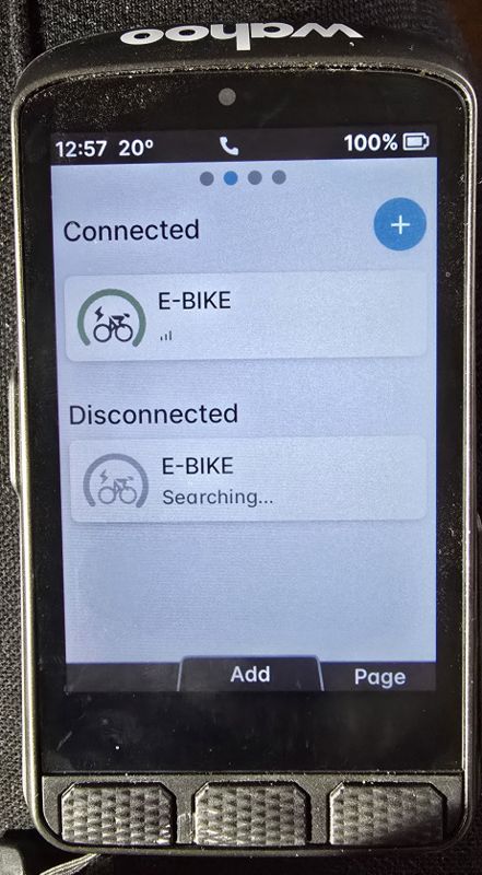

- Are you sure the e-bike is connected as a single sensor called E-BIKE? (It is done from the device, not the App!)
- Did you perform the firmware update?
