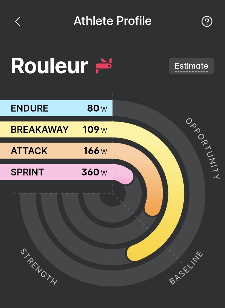

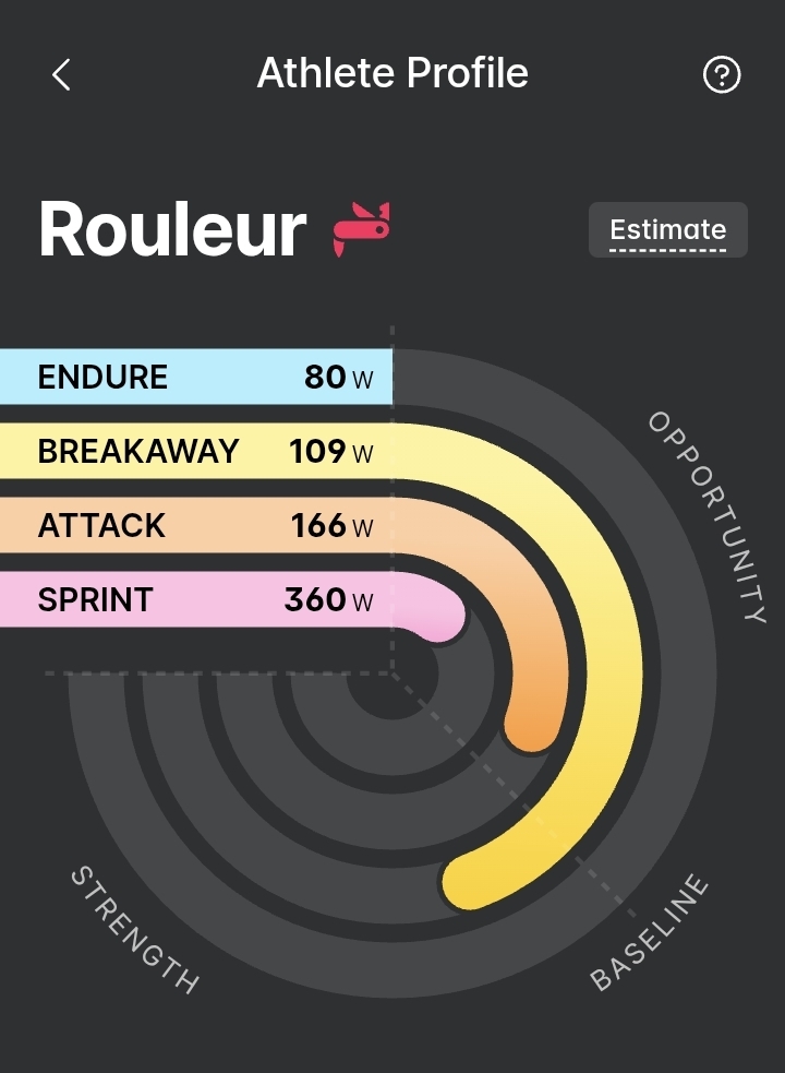

Some fun related to the new Wahoo App (that has replaced ELEMNT Companion App for v3 devices)
The App has asked me to fill in a questionnaire; the objective was to create my performance profile. When I answered all the questions the it turned out the idiotic algorithm has overlooked the fact I was riding an e-bike :D So the calculated FTP was enormous! :D
Then I repeated the procedure with assuming my FTP was 80 W and only then I got more realistic figures....
Slick graphic. No idea what it means.

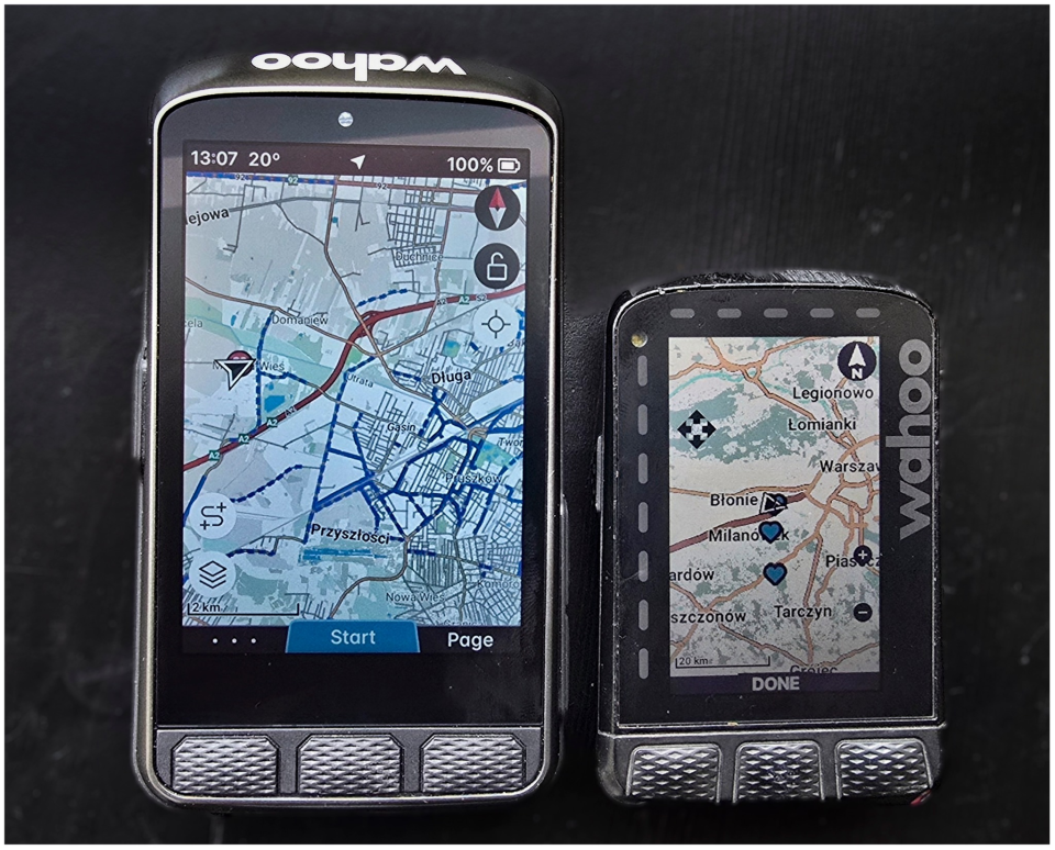

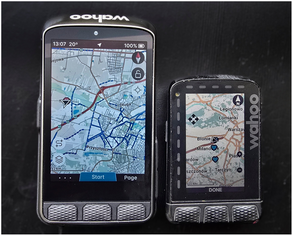

The smaller Wahoo Roam v2 has the characters big and perfectly readable even in the direct sunshine despite being a way smaller than the ACE. It seems a lots of potential was wasted in the ACE here. Roam 2 has its data screen readable in any lighting conditions without the backlight for the daytime. ACE requires Auto MAX backlighting in direct sunshine.
What makes ACE really better is a large colourful map. You can do a very long ride using GPS navigation and not scale the map even once! Scrolling and zooming the map with the Roam v2 is painful (buttons only). ACE allows touchscreen operations on the map even including manipulation of the map layers. There is a new data screen called Waypoints (similar to but not identical to Garmin). You can use a route with POIs, identify the POIs and navigate to POIs even if these are off-route.

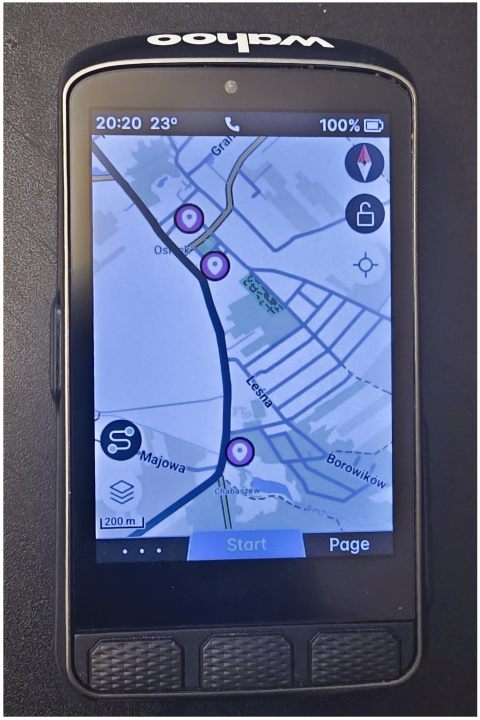

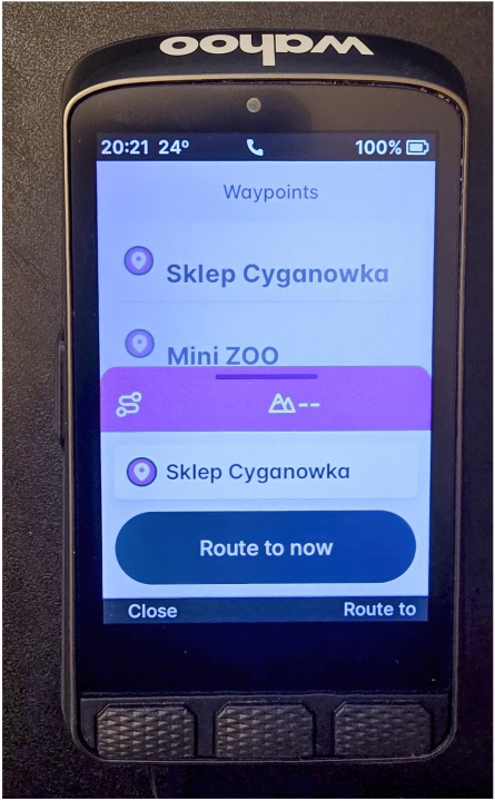

Points Of Interest!
Make a GPX that includes Points Of Interest. These points can be located long kilometres off route! (For instance, a restaurant you want to visit but which is, say, 4 km off the course). You read the GPX into the ACE (or, perhaps even Roam or Bolt 3?) via Wahoo App.
Your POIs are there! As you can see here, none of them is on the course.

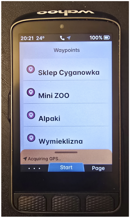

An extra data screen named "Waypoints" lists all the Points Of Interest. You can scroll that list with your finger or with the right hand side buttons.
Select a POI and Wahoo ACE will route you there. (I am sure the option to go back to the course exists, too).

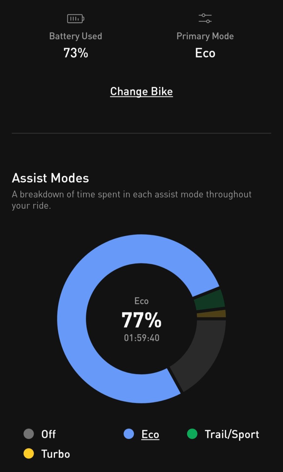

Problem is, the ACE and Wahoo app can't see my battery and assist levels and don't record them. Doesn't matter which I connect with the bike first — the ACE or the Specialized app. Everything else, including rider power and heart rate, records normally.
Before Wahoo entered the mix, the Specialized app's ride page would show me this battery and assist summary after finishing a ride:
Post-Wahoo, that part of the ride page is gone. Nor does this lost info show up in either the ACE or the Wahoo app.

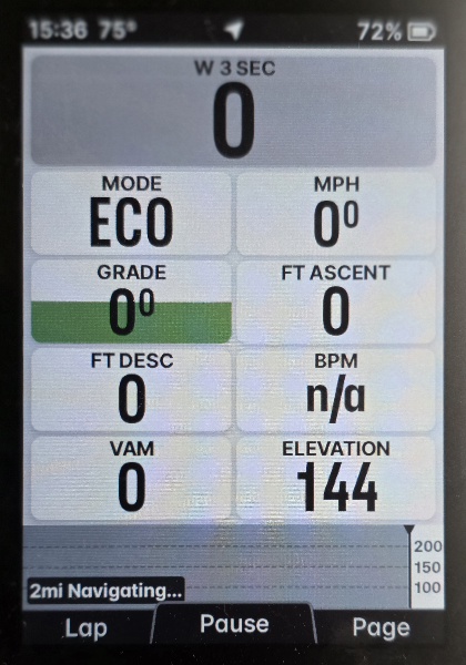

Please try adding the LEV Range field to your Workout screen for a while. Does the Range display? Or, does the LEV Travel Mode display? If not, I have a suspicion the E-Bike sensor has been never connected.
Field is present but doesn't show the data.
Have not tried that field, but I have the same suspicion. Will check on next ride.

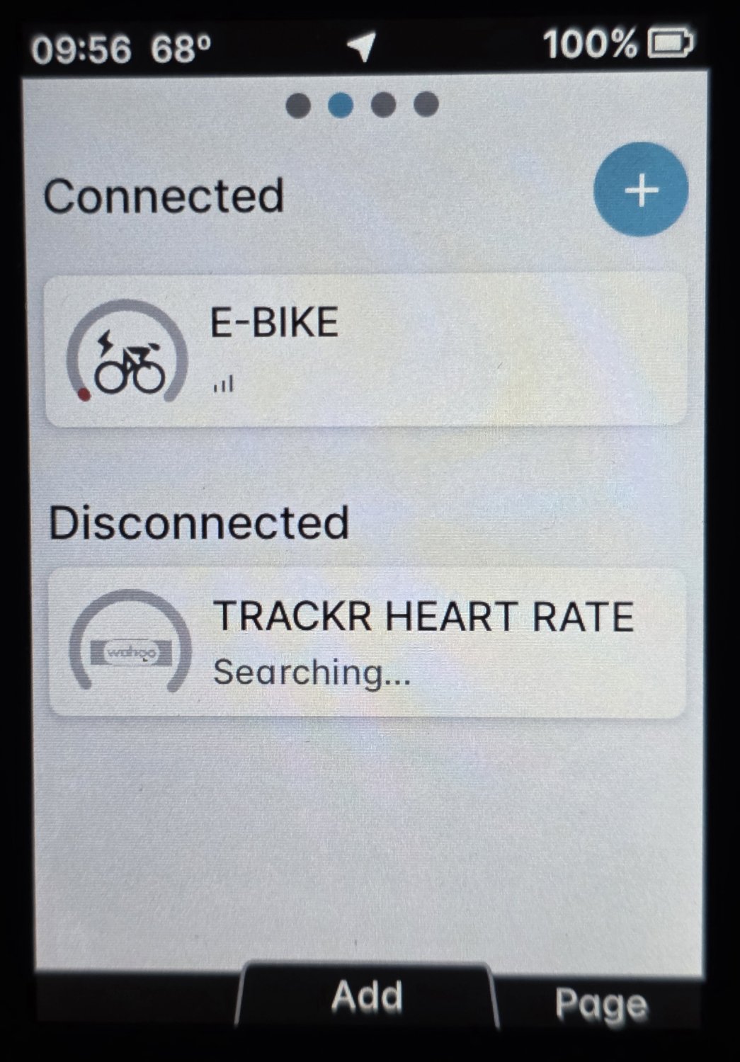

Thanks for all the help so far. Had a few minutes to start digging. Specialized app was NOT connected to the bike at this time.
My ACE readily connects with my SL when I turn on the latter. Page 2/4 of the ACE settings (accessed via the ACE's side button) then shows:
So the ACE seems to know I have an ebike. My HRM was off at the time.
Q: Should there be another bike-related sensor showing here?

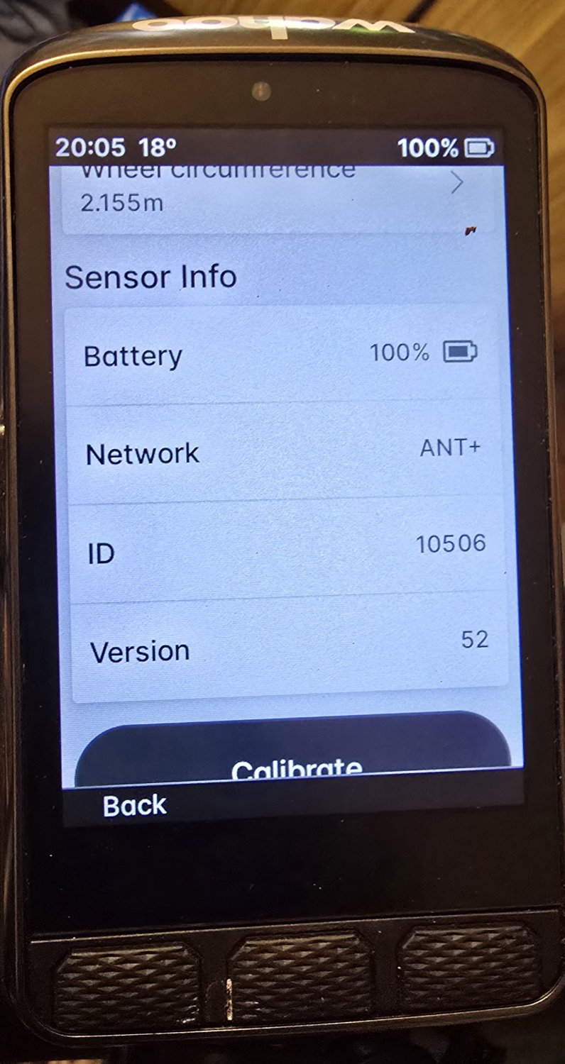

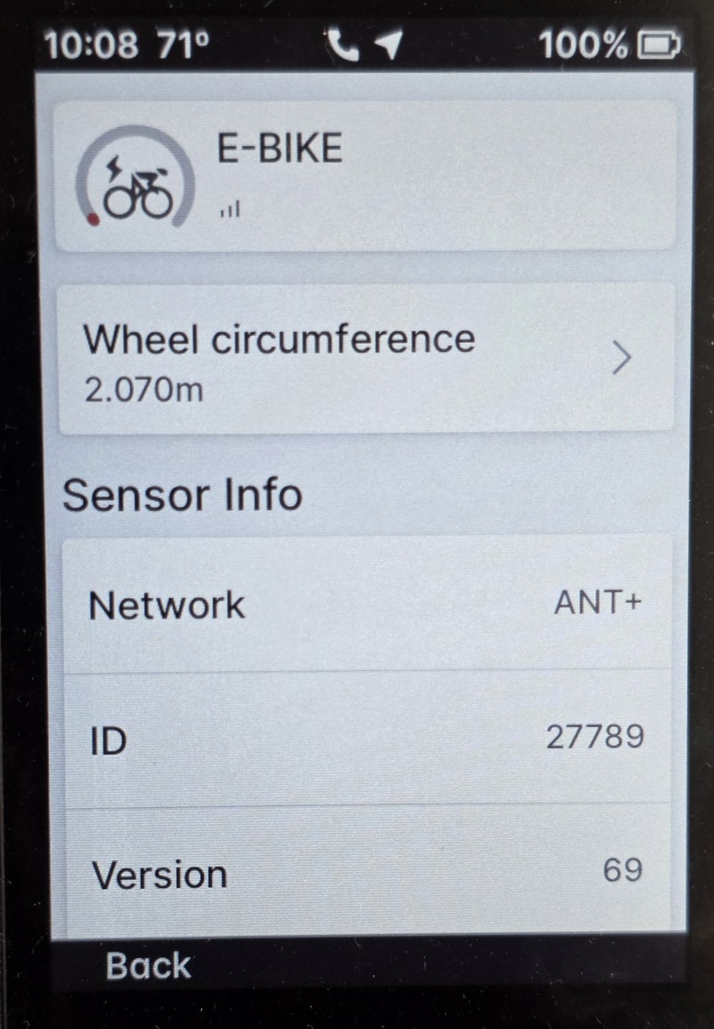

Tapping the E-BIKE sensor above brings up this "sensor info" page:
Just below is a "Forget sensor" button, but not quite ready to take that step.

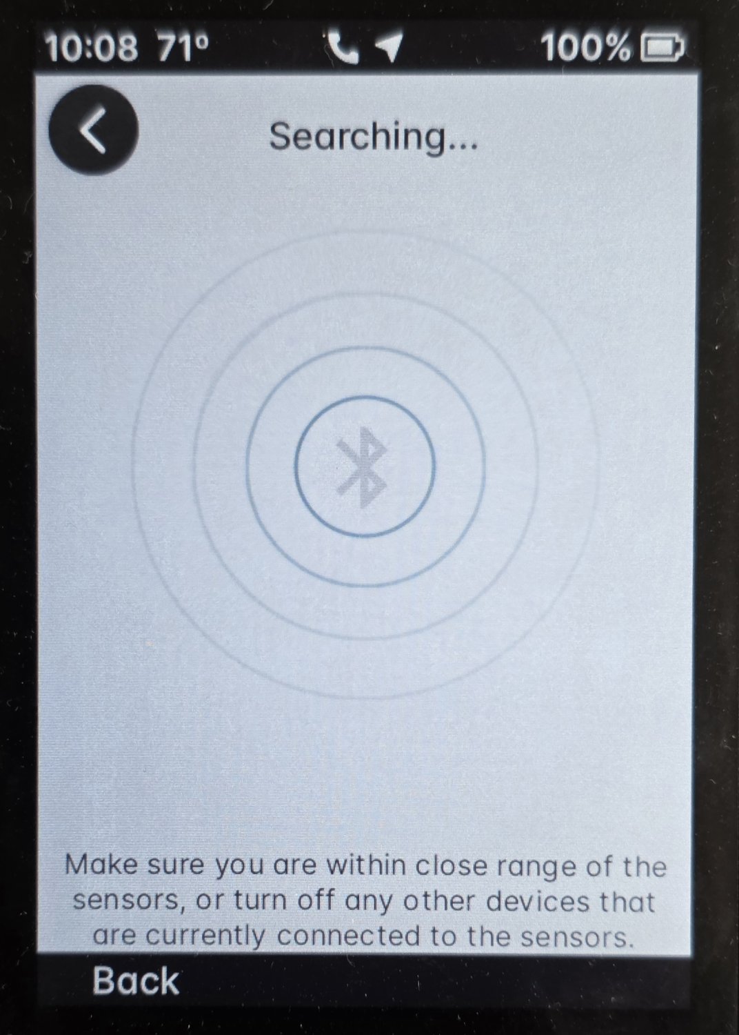

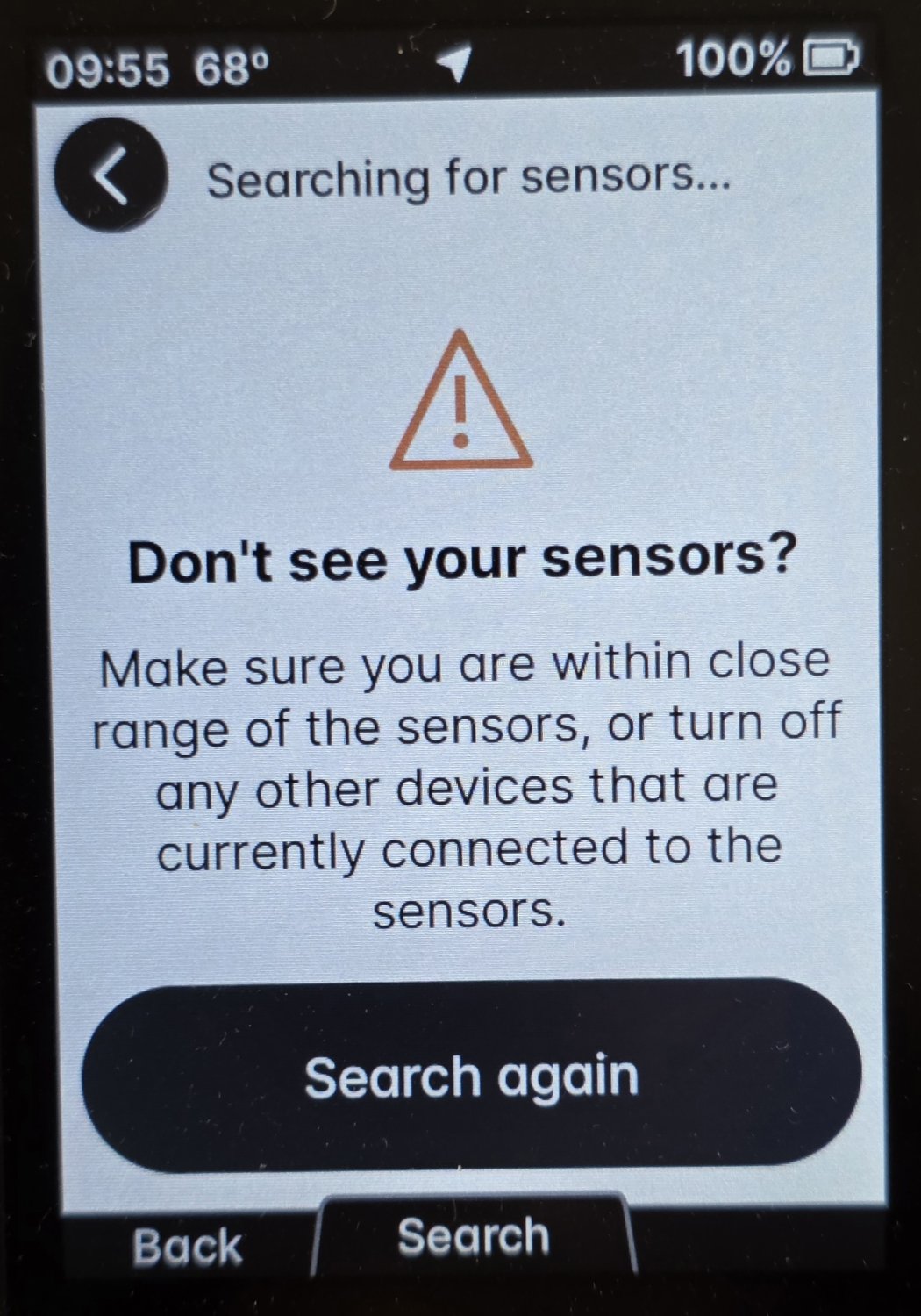

Then tapped "Add" in the 1st photo to see if the bike has any other sensors to offer and got this:
Thanks again
No indication that the ACE was looking for any ANT+ sensors, just Bluetooth.
Eventually, the ACE gave up. Searched 2 more times, same result:

Is that "Forget sensor" button my next move?
Yes it is.
There is some confusion. E-BIKE is a generic name given by Wahoo to a combined apparent sensor made out of three actual ones, one of them being E-Bike (Light Electric Vehicle, LEV). That very sensor was not detected by ACE while pairing your Vado SL.
Forgetting the apparent sensor then searching for sensors again will give the device a fair chance to recognise then combine all three actual sensors into one.
It is only ANT+, no Bluetooth. Meaning, I can connect my ACE to any compatible e-bike without knowing any PIN. Just to explain: I have owned three compatible e-bikes and four Wahoo ELEMNT computers. The only one combination that didn't work properly was a Giant + ELEMNT because the Giant E-Bike didn't let Wahoo combine the E-Bike physical sensor into the combined one (I could see two sensors for the e-bike instead of one).
P.S. Garmin recognises three independent actual sensors on a compatible e-bike, which is pretty complicated.

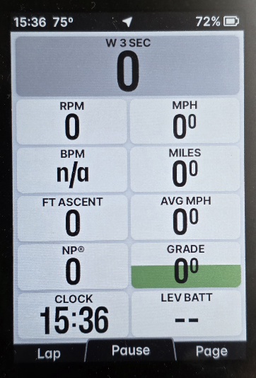

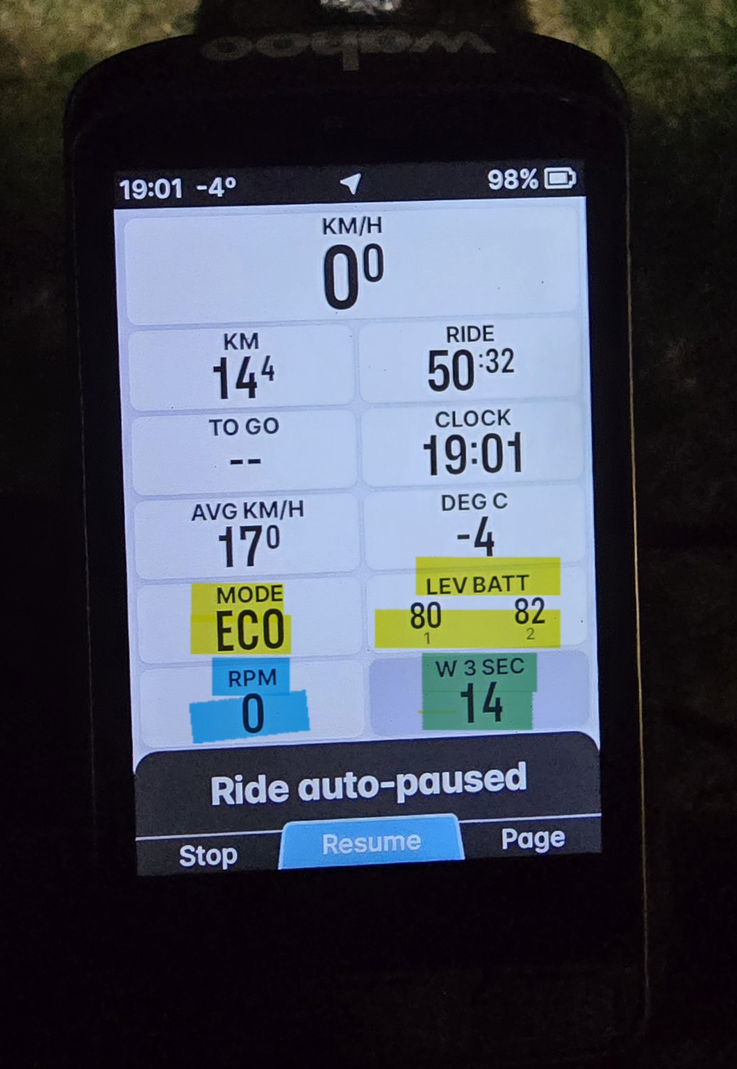

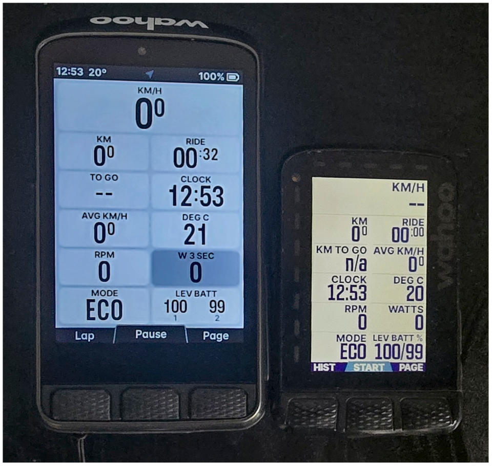

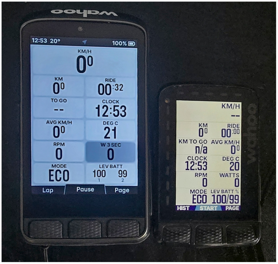

Thanks, but no change after forgetting the E-BIKE sensor and reconnecting, twice. Sensor info page is always as shown earlier — no mention of the battery.
The ACE's LEV BATT field remains blank, but the W 3 SEC, and RPM fields have always worked normally while riding. This data can come only from the bike.
The ACE assist mode field also updates as soon as I change it on the bike.
Guessing that some of the bike sensors are connecting properly, but not the battery sensor. The SL's firmware was updated maybe 6-8 months ago — long before the ACE entered the mix.
