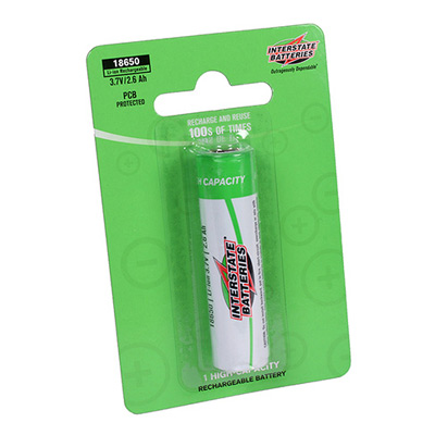

Interstate does have 18650 but their main target market seems like flashlight and some kind of industrial equipment.
