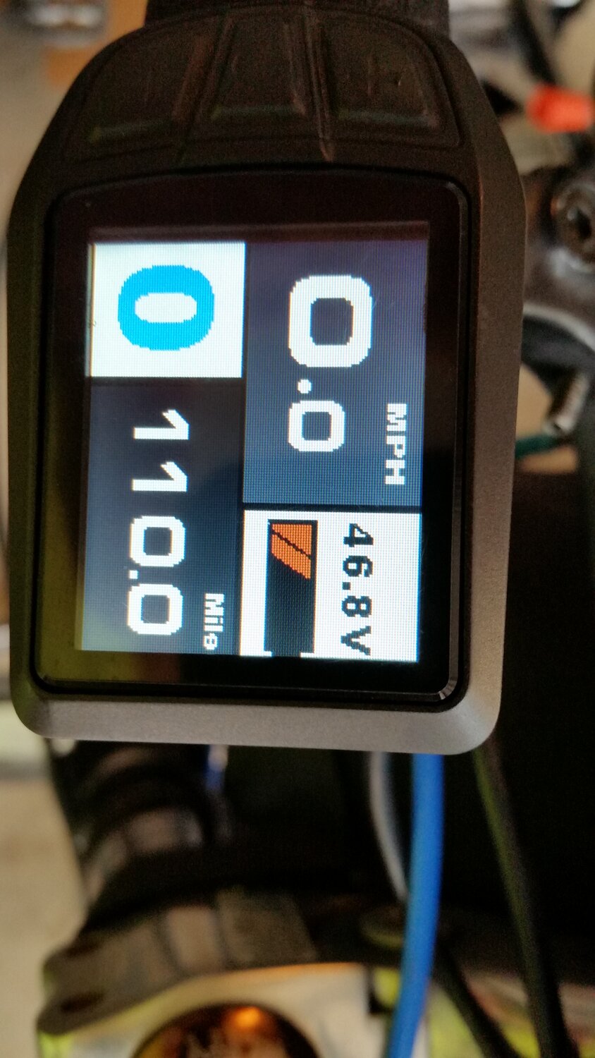

Highest point was a bit above here:
lowest point was at the river at the left of the picture and over the hills seen between the two large fir trees.
Odometer is set to be accurate:
Just one person's experience, which has been excellent, with these batteries as well as a couple other no-name Amazon sourced batteries that I have. I ride for fun and exercise and not moped style that I see with people throttling along with their heavy fat tire bikes so YMMV.

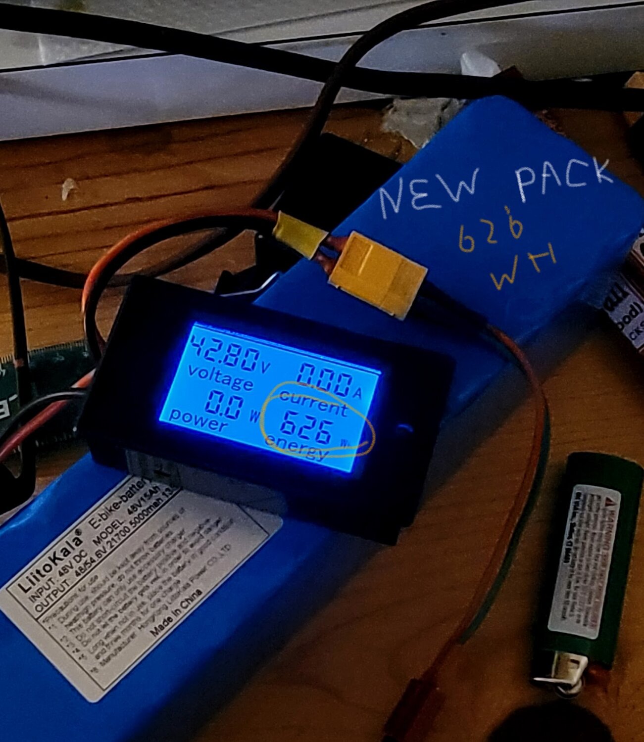

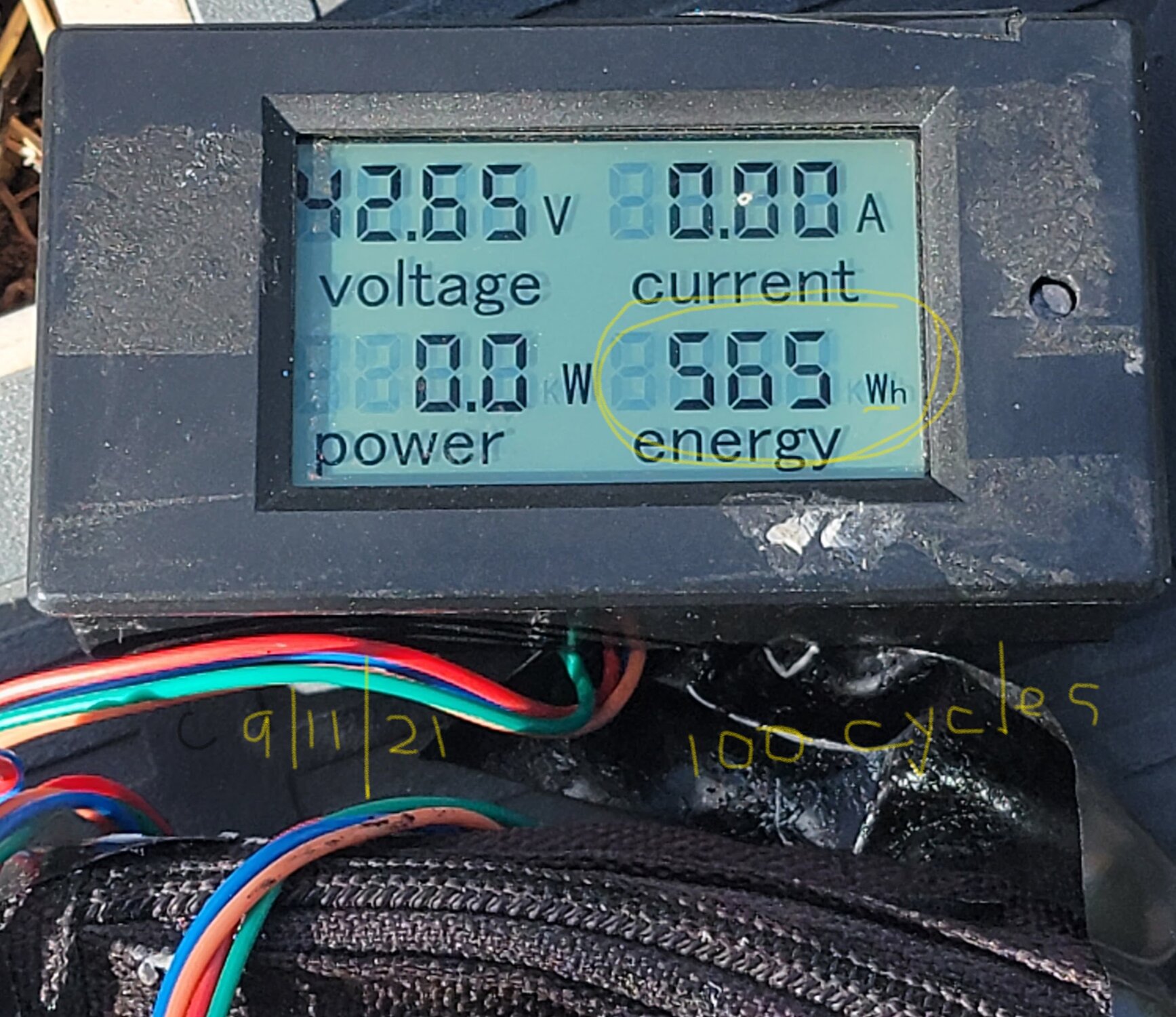

A 4 Month Evaluation
I expected this pack to fail or have a very short life, but that's just me looking at the low price and thinking it can't be real. There are reports of problems with cheap packs, but the pack worked for me. It is light. It fits in a cheap top tube bag. No problems ramping my BBS02 to 16 amps. Like many packs, it starts to sag after it is 40% depleted, which does make it less fun that when fully charged.
The initial watt hour rating was around 625wh. For a 'true' 15A and 48V, the real average voltage for a full discharge is around 46 volts. Multiply 15 times 46 and you get around 700 wh. That's what you would like to see. The 625wh is down 10%, but it's not outside the norm for pack marketing. There is a 20AH and anyone who needs over 400 wh might look at that. My tests are not extreme, I just charge the battery. For testing, using a plug charger, It sits at full charge voltage for a few minutes but not long enough to do a lot of balancing. Basically, you have to do a full charge and leave the pack overnight, to get a balance charge. I use a solar charger and it shuts down at the voltage set point. So I assume this pack has not been balanced.
The 4 month watt hour rating was down to 565wh. That's a drop of 60 wh, or 10%. A lot of performance cells can lose 20% in a hundred cycles, but I'm not doing hard cycles. It's a full charge and a half discharge, mostly.
I assume if the vendor, Liito Kala, continues to make the pack and it performs similarly, they will do pretty well. Right now, I think it costs $120 with tax and whatnot. It's a 3 month wait, ocean freight.

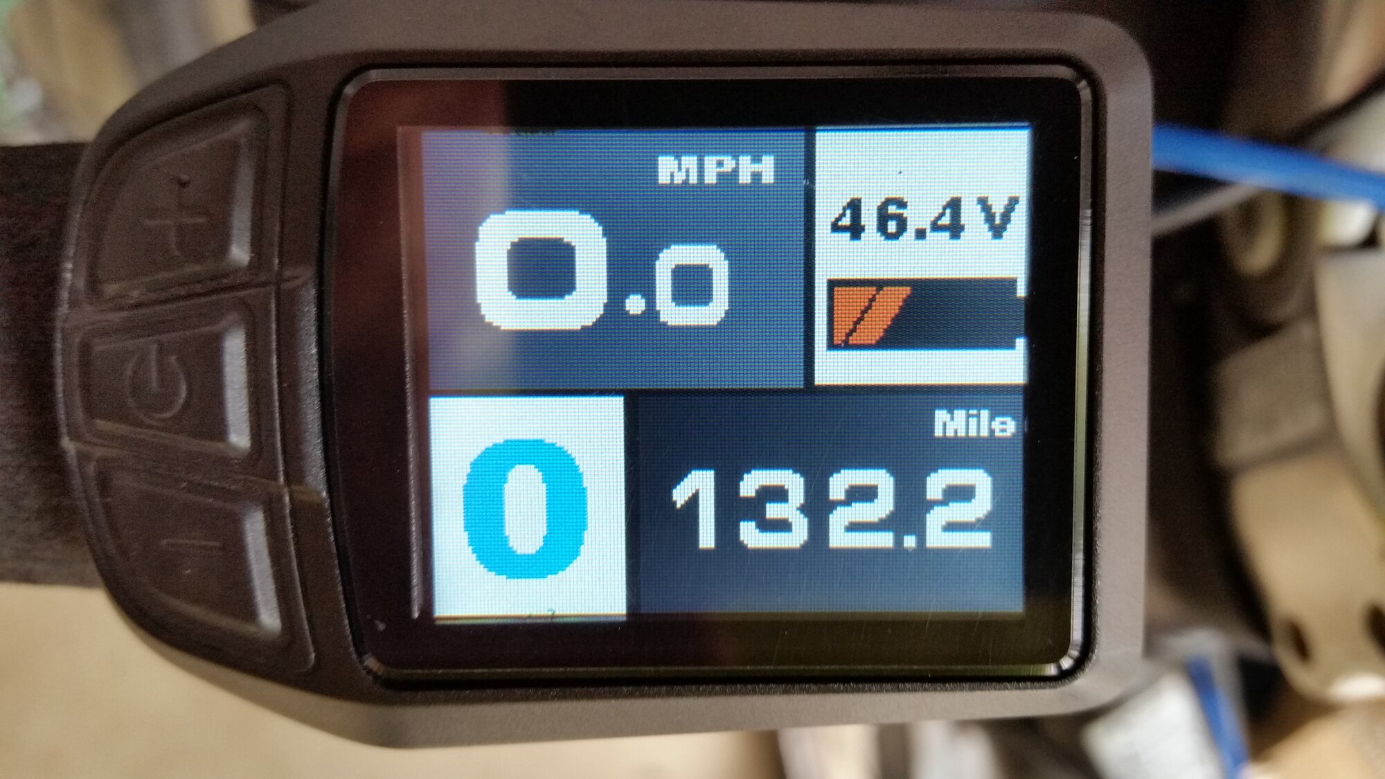

I'm doing a range test on my no name Amazon sourced 48v 15ah battery that I've had for about 9 months. Used it on this TSDZ2 mid drive conversion as well as a 1980s Schwinn Sierra mountain bike with a 500w geared rear hub motor conversion. All rides on very hilly routes. So far 110 miles on one charge with 46+v residual charge. Lowest I saw battery slump was to 46v on very steep section going up this mountain. I do ride without assist downhill and on flats but current charge has assisted me up this mountain 3 times (3 rides over a 4 day span).
I might try one more 22-25 mile ride on this charge which will include another ride from near sea level up to this point and rolling hills in between. I guess all of my inexpensive batteries have been in the lucky "95%" good performing group - so far at least.
Did one last ride on thecurrent charge. Total 135+ miles (display trip odometer has a glitch where it under reports 1 mile out of 10 when above 100 miles). Over 7500 feet climbing. It might be able to provide assist for another 25 miles and another 2000ft elevation gain but I'm not going to push it to the last electron. Super impressed!
EDIT: digital voltmeter read 46.6v so the display reading is close. Almost 50% residual capacity left in the battery which is pretty unbelievable - maybe there would be a steep drop off in performance after this but still amazing battery performance IMO.

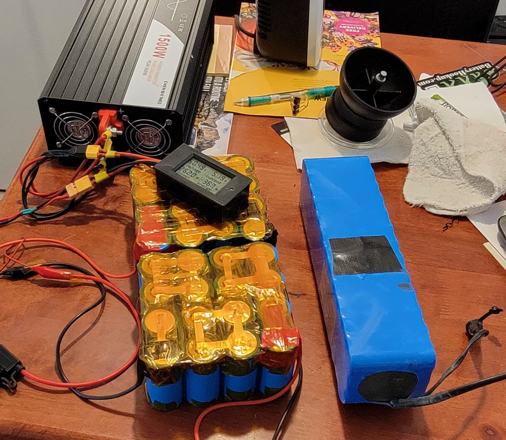

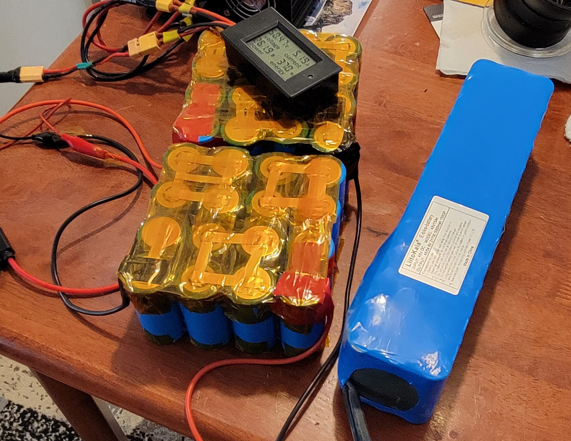

After 10 weeks, the Littokala 48V15Ah 13-3P arrived.
One full test cycle. After verifying it could push 26A on my BBS02 bike, I did a capacity test with my 20A hubmotor bike..Ran it from 54.6V down to 40V. The discharge capacity was 11.9Ah. My controller LVC did not work, so I stopped the test when voltage reached 40. I did keep riding, and within 500 feet, the battery shut itself off at 38V. Voltage sag, by the way was 4V, under throttle. Even at 42V, my bike felt good, but to be honest, I normally run that bike on a 10S 36V battery. On recharge, the pack sucked up 12.3AH. COnclusion is mine is a12AH pack, and the cells must be 4AH cells. It has enough capacity for a 500W motor, and performance is acceptable fior a $106 battery, By the way, I covered 57 miles, around 10WH/mile. Your mileage could vary.
I plan to wrap it with padding and make a coroplastic box for it, to minimize mechanical stress on its structure and spot welds. Keep it in the cinder block for storage and charge outdoors. I wpuld have been quite impressed if it had deleivered close to 15AH, but 12AH is realistic, given its price
I would not buy another one because it's going to be more fuss to charge and store . Better to spend 3X on a UPP Hailong pack using 21700 cells.
