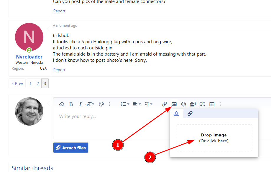

Can you post pics of the male and female connectors?
6zfshdb
It looks like a 5 pin Hailong plug with a pos and neg wire,
attached to each outside pin.
The female side is in the battery and I am afraid of messing with that part.
I don't know how to post photo's here, Sorry.
