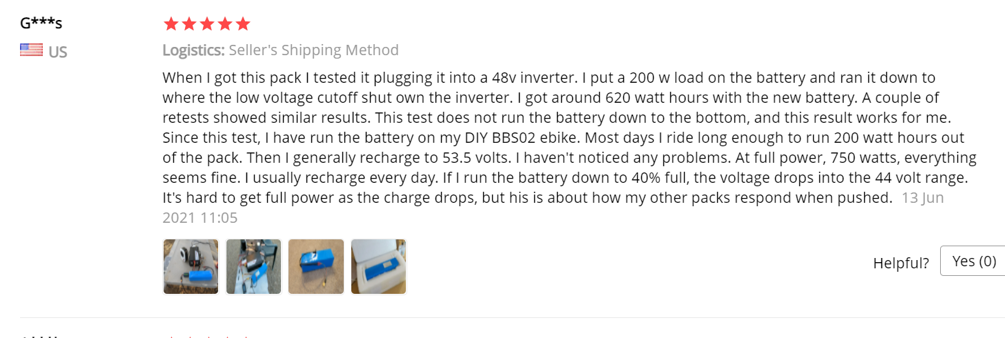

George S.
I’ve been using this battery pack on my BBS ebike, a DIY conversion, for 35 days. I haven’t encountered any issues. I’ve run it down to 40% remaining, and the voltage sags but it’s not terrible. The capacity works for me. At some point the sags at high draw trip the BMS, even if the battery is not dead or near dead.Is This Battery for Real??

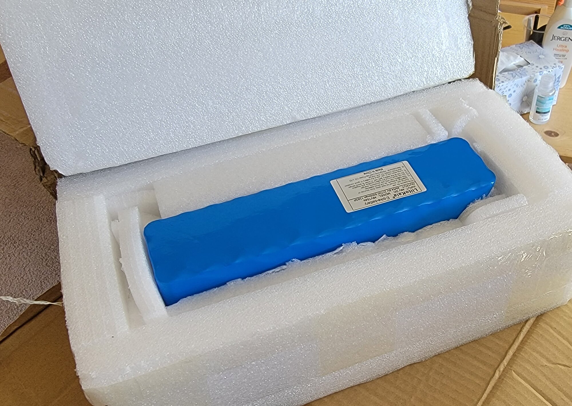

I ordered this battery the end of March. It arrived last week, around May 13th. The package simply showed up with a DHL label on it. There was never any tracking. The cost was about what the ad states, plus sales tax. I guess Ali is enough of a monster that US states make sure they pay tax.

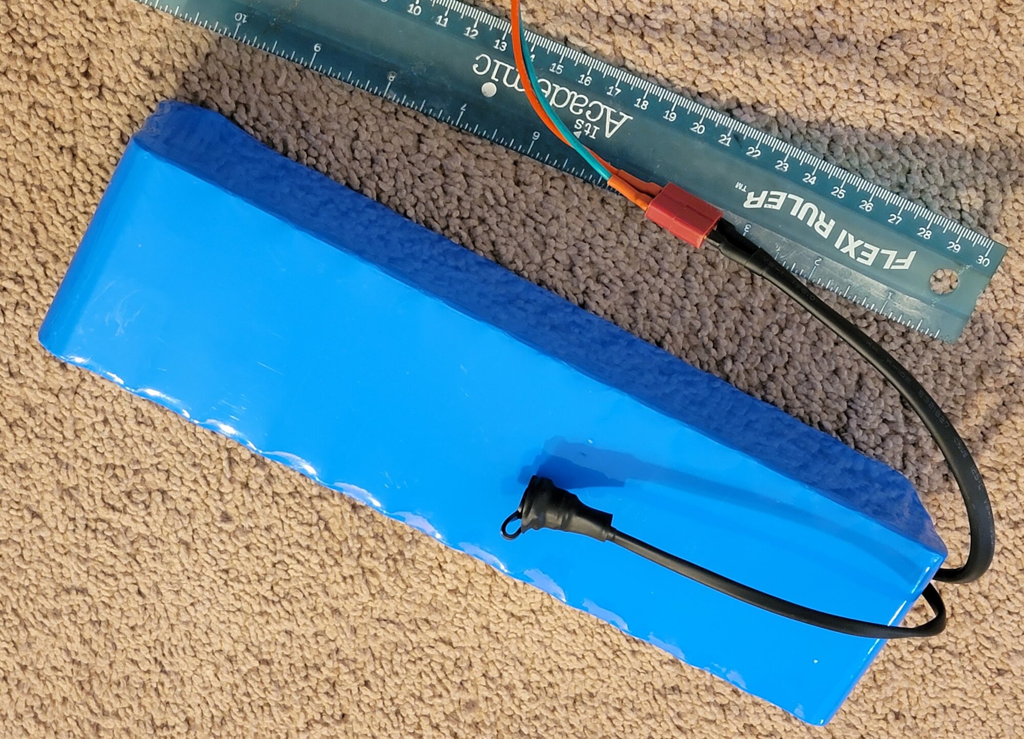

The battery pack contains 13 cells, but they are a larger 21700 cell, not the standard 18650. There are 13 cells in series and 3 in parallel. The claimed capacity of these relatively large cells is 5,000 mah, or 5 Amp. With 3 sets, this is a 48 volt and 15 AH battery. This works out to around 650 watt hours. Since 48 volts is a little high as an average useable voltage You shouldn’t just multiply amp hours by the nominal voltage. The watt hours will also depend on the low voltage cutoff point in the specific BMS you have. For the test I ran, the BMS cut at 42 volts, which is not the end of the battery, exactly. I use a watt hour meter, watt meter, and precision voltmeter on my bike. This is useful information to judge your battery as you ride.

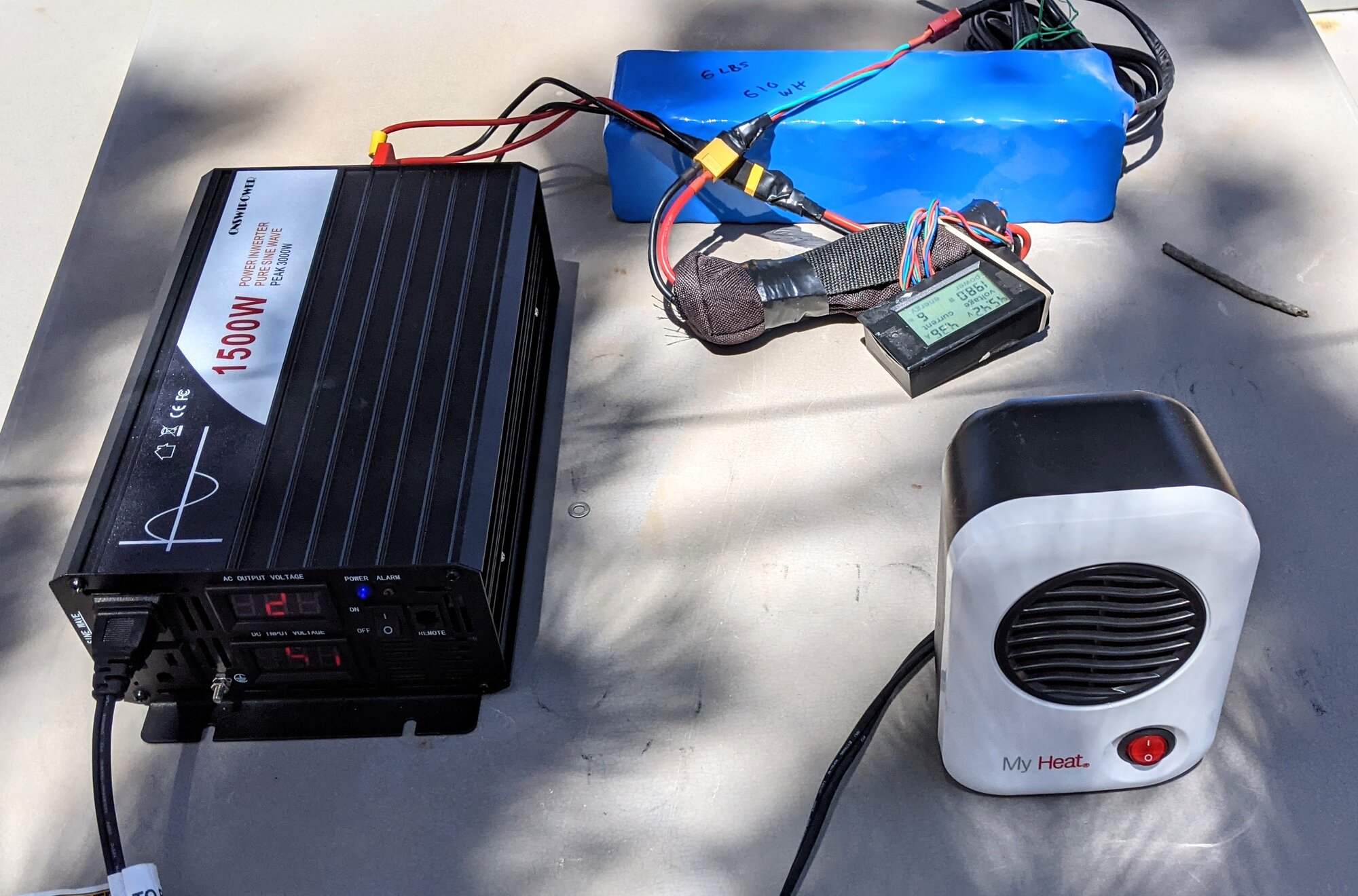

In the initial rundown test, the battery was charged to 4.2 volts per cell, which is the normal standard for this type of Lithium cell. Most chargers will list 54.6 volts as the terminal voltage for a 48 volt pack. The rundown test used a 48v inverter connected to a 200 watt load. The test ran until the LVC on the inverter shut the inverter down, around 42 volts. The total watt hours at the end of the test was 626 watt hours. The voltage recovered to 42.5 volts or so. It’s hard to get useable amounts of power as the battery drops to 43 volts or so. Worrying about these garbage watts is not worth my efforts. If you were riding an ebike you would be drawing 200 watts, a useable amount of power, until the capacity was depleted. All of this is based on a few test cycles, which were consistent. This battery could supply 700 watts, full legal power, with a fresher charge. That’s all I tested. There are a lot of nuances to using a battery on an ebike. You need a cell that can supply the legal 750 watts. As the battery depletes, you need a cell that still provide useful voltages and amps to the end, or the practical end. These cells do the job.
