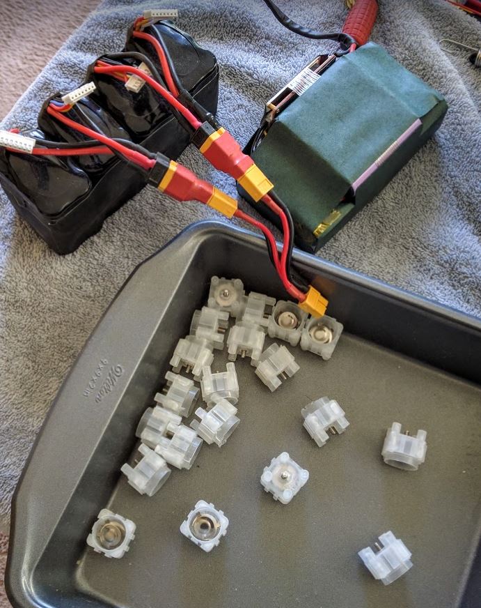

Getting back to compression packs. Vruzend seems to work, and they have had a couple of revisions. It is quite easy to check the connections on any pack with a thermal imaging camera. The hot spots are weak connections. The original Vruzend seemed to stress at 4 amps, the latest version is maybe triple that (they say). Jehu Garcia has a compression system, but it looks like the basic cell holders from China with a clean board. He had a video showing stress at 5 amps or so. Remember, you parallel cells in packs, or build voltage, so 5 amps is enough with 5 parallel sets. It’s 25 amps and at 50 volts that is 1200 watts.
AND George S. after receiving his Vruzend kit.
Scrounging like this can work out. Here are three suggestions:
1) This might be the wave of the future. It's the Vruzend system to build packs with a mechanical connection. Micah Toll has a decent video on how it works. Toll has an ebike book and an ebike battery book, both good. I have a kit and I've studied the parts. I have some other battery projects and I like to test them, so i can't handle another pack right now. They are selling some nice looking cells for around $4.50.
2) I made a video about using Titan Flight packs for an ebike battery. I made it so I could send the link to Trent, at Titan. They are kind of working on packs for ebikes, but they are swamped with order for the RC stuff.
3) There is a YouTube page with a lot of information about some hoverboard packs, sold on Ebay. There are a lot of questions, but I have some of the packs and made a 36v ebike pack, with BMS, from two of these packs.
There is a lot of information to process. It pays to learn how to charge cells, how the layout should go, stuff like that. It's better to understand packs and know how to monitor them, as opposed to paying a lot for a sealed system with no user serviceable stuff. It's understandable, but be safe.
It's always great to help someone who wants to make something.
