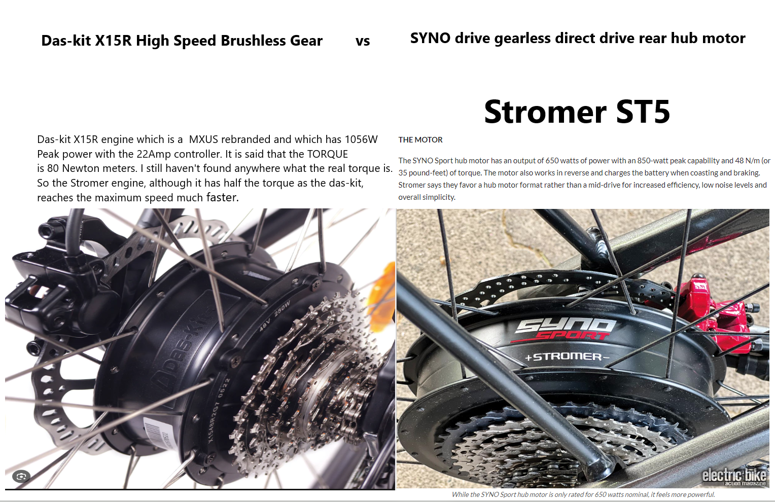

Can someone explain to me why the Stromer ebike even if the battery is half consumed can still reach the maximum speed and other ebikes such as the NCM for example, after the battery starts to consume both the maximum speed and the power decrease? What is so special to the Stromer controller? For example on my ebike when the battery is full, I reach 38-40kph, and when it is half consumed I can only reach 35-37kph with the 48v 21Ah battery.

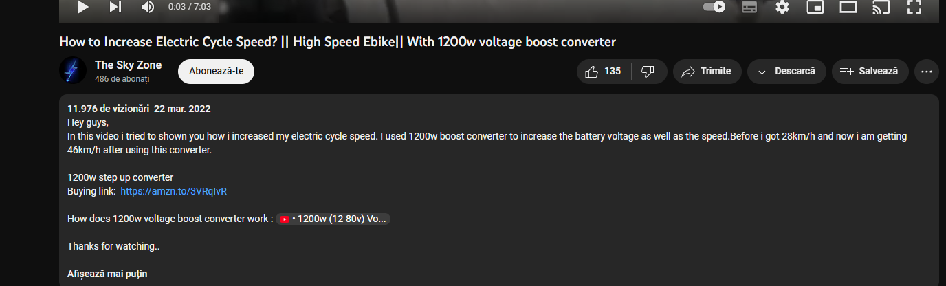

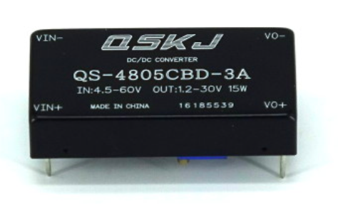

I cannot speak to your Stromer bike specifically. But a device from Amazon like this one will accomplish the goal.
This particular device is NOT a good pick but I just searched up something quick, there's versions in sealed metal boxes with air fins and such that are more suitable. As your battery voltage sags, this device will boost it and deliver full voltage to the motor as if the battery was fresh. It does this at the cost of range and has a 8-10% power loss as heat but your bike will feel snappy and full of pep right up until it stops. Make sure to spec a device that can exceed your current requirements too.

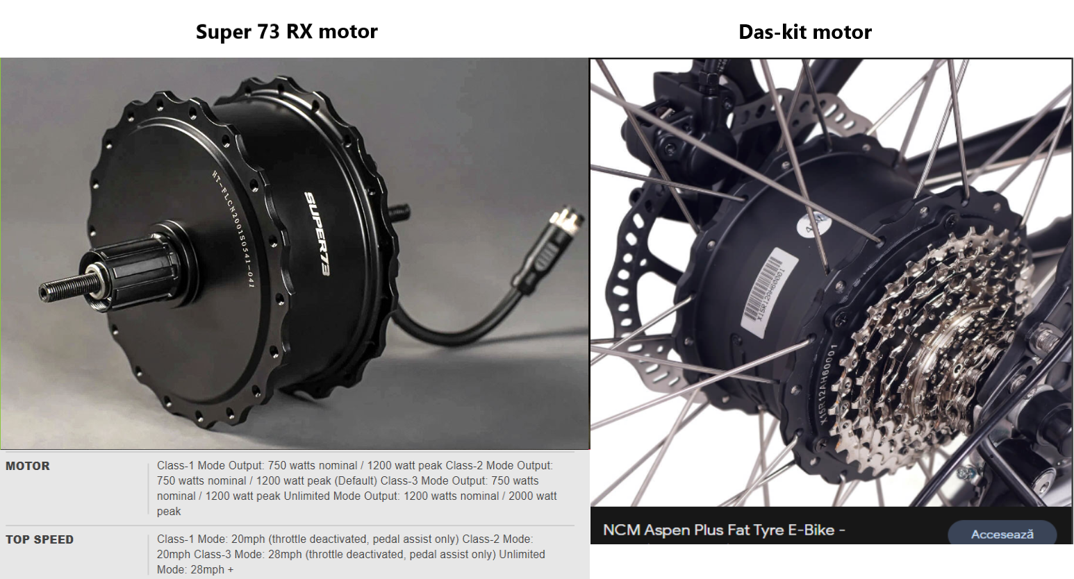

The Super 73 rx motor has the same size as the das-kit motor, only the peak power is 2000W, which tells me that it is just overvoltage. With my ebike I traveled 100km with a fairly short break in the summer when it was very hot and when I arrived home and I put my hand on the engine, it was very cold, not hot at all, and taking into account the fact that the display is unlocked and I can go 40kph. So the das-kit motor which is a rebranded MXUS is very durable and I am convinced that it can work at 2000W without any problem and without overheating. The NCM ebikes do not work with 52v batteries only because the controller does not support it, if you put them another controller can also work on 72v. And last but not least, let's not forget the fact that the stores sell us motors with a 250w label just to be legal when in fact the motors put out much more power.
So think that the Super 73 Rx has the same motor as yours that you have on the ebike but which is overloaded to 2000w peak power and has no problem. The companies are selling us bullshit, they use the same motors on different ebikes frames,and only they raise the prices very high. Just look at how much a Super 73 rx costs, almost €5k and the kit costs only a few hundred euros.

Also OVT if your boost converter looks like the one in the pic be slightly careful, that unit in the pic does not look capable of handling 1200w

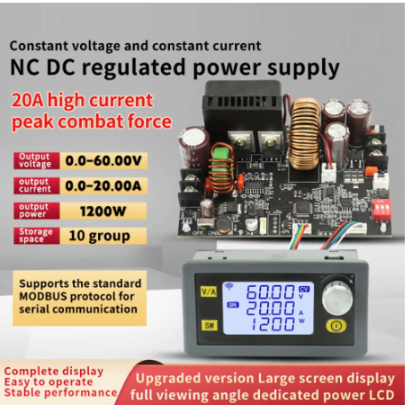

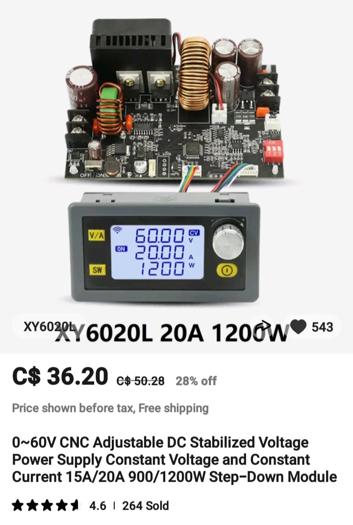

Yes, I also totally agree with you. Those who had problems were because they do not have unlocked displays and the voltage is set to 36v instead of 48v, and thank you for the answer about the DC-DC converter. https://www.aliexpress.com/item/1005005249925637.html?spm=a2g0o.cart.0.0.6fb161d7ThHYD8&mp=1 What do you say about this power supply?I think it will work well. I see that the motherboard has many chips which gives the feeling of something professional.

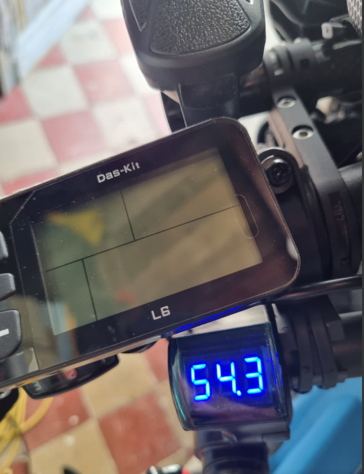

I'm interested in having 54-55v all the time, I don't want to force more. Already after about 20km the voltage reaches 50-51v and when the battery is fully charged it shows 54.3v. When two lines go from the battery and I accelerate, the voltage drops somewhere around 46.6v, and when I don't move somewhere around 48.1v after about 40 or so km.
Not to be rude...however...
Anyone with a clear understanding of what makes a quality populated PCB will tell us those cheap boards are shite!
Whenever I'm using cheap electronics, I never turn them up past half.
They tend to be over-rated and they burn out if you run them at max.

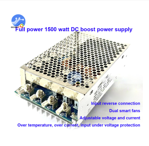

So as I see no chance to find a quality and good converter that can maintain 54-55v at 1000w.😢😢😢
