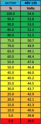

I'm attaching a table which gives a rough idea of the relationship between voltage and capacity remaining of a 48V pack. This table would suggest that at 46.8V, you have about 50% remaining....note that this is a rough estimate only.
,.. before buying this battery i would have more left on the battery after 32 miles,any advice or conversation on others experiences with the 25ah battery similar to mine id appreciate,thank you

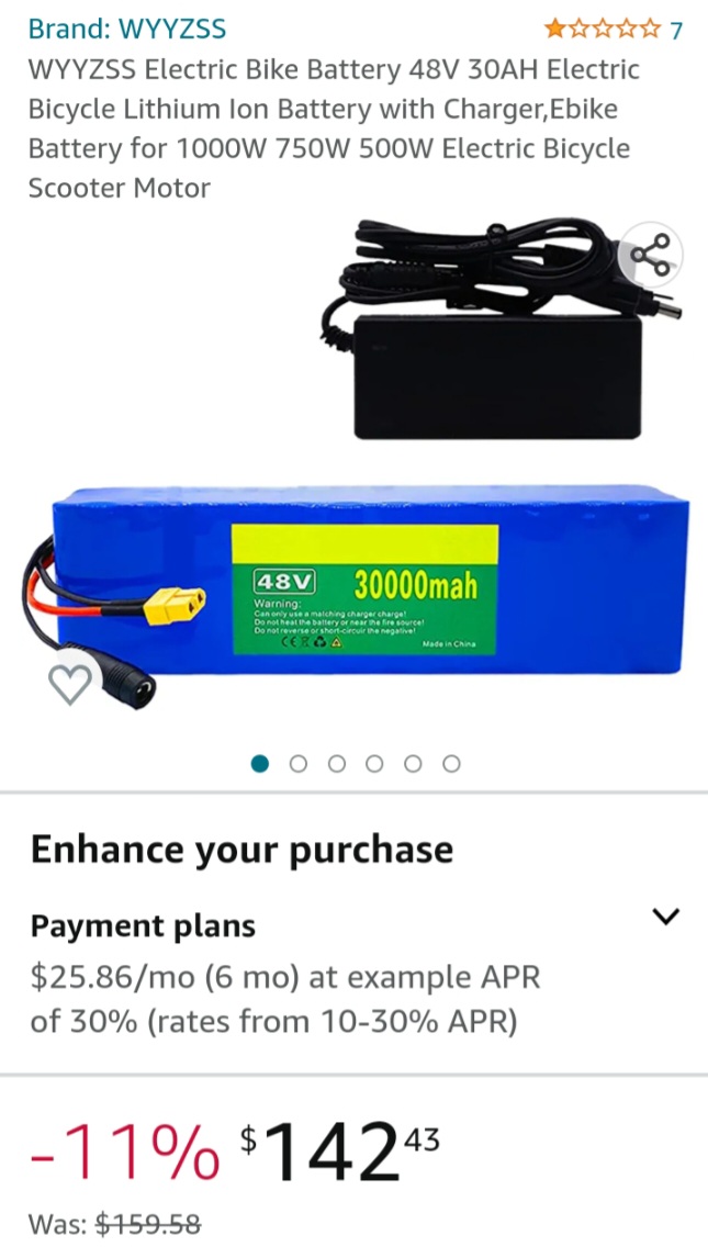

Here's a 48V 30ah lithium battery from Amazon for $142 CAD !!!

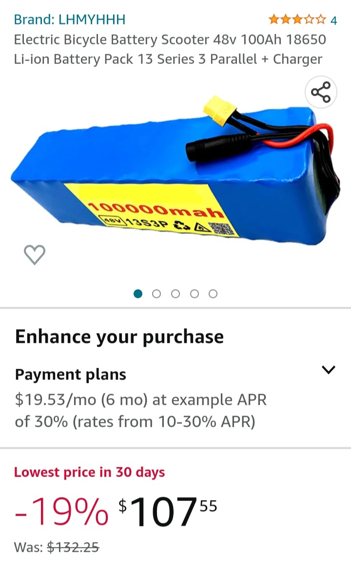

Here's an even better deal !!
48 volt 100 amp hours for $107 Canadian dollars!!! Lol
I'm sure that it's built with quality and safety in mind too !!! Lol
Agree, I think 52km with 2bars left, that is not bad. The battery cutoff voltage is about 39V. Also the discharging capacity is a bit less in low temperature riding.
In our mass production capacity testing, the 25Ah tested capacity under 10A discharging, is about 24.5Ah in Summer, and only about 23.8Ah in Winter.
