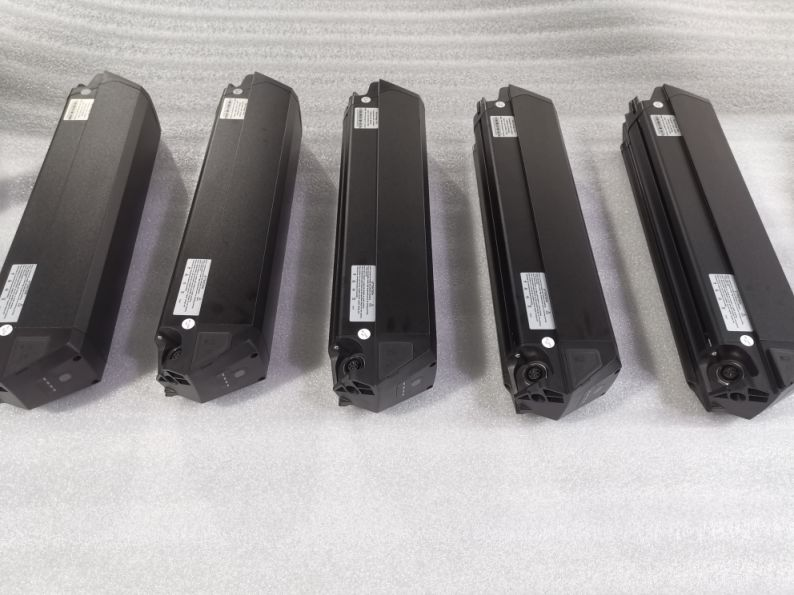

I just finished my first ride with one of these on my Magnum Ranger, amazing range.
The other 4 I ordered are for sale...
