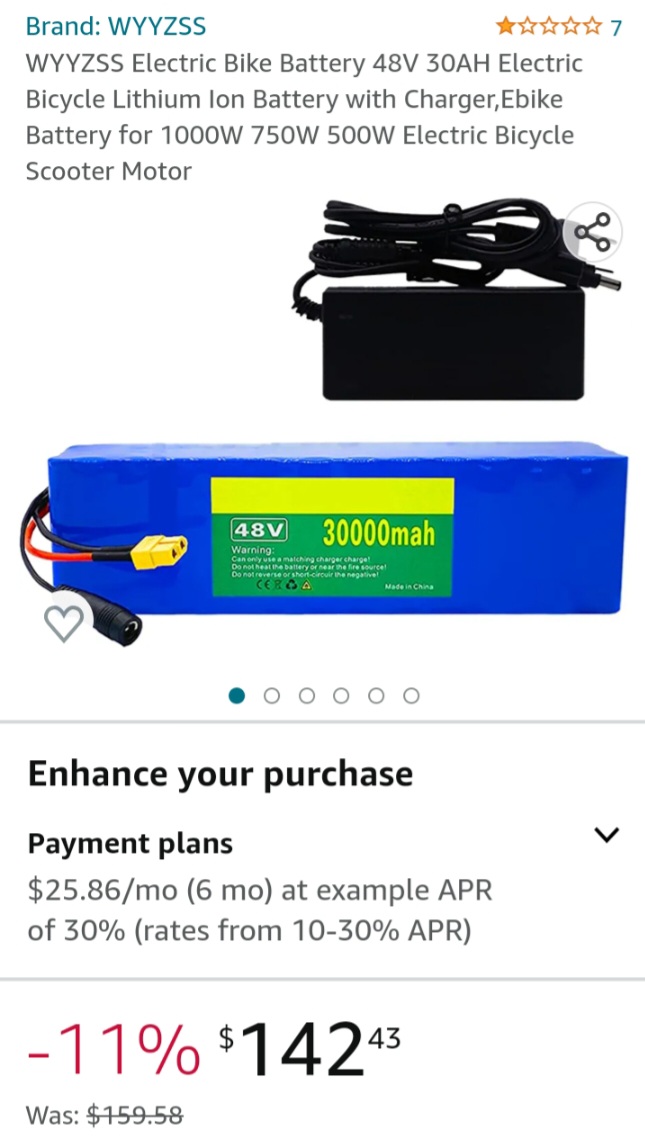

If you didn't buy your battery from @Jenny Mao then there is a really good chance that your battery labeled "25ah" is no where near actually being a 25ah battery.
Battery makers lie.
Jenny doesn't lie.
Her 25ah batteries are actually 25ah.
Here's a 48V 30ah lithium battery from Amazon for $142 CAD !!!
@Sandy77
Battery makers lie.
Jenny doesn't lie.

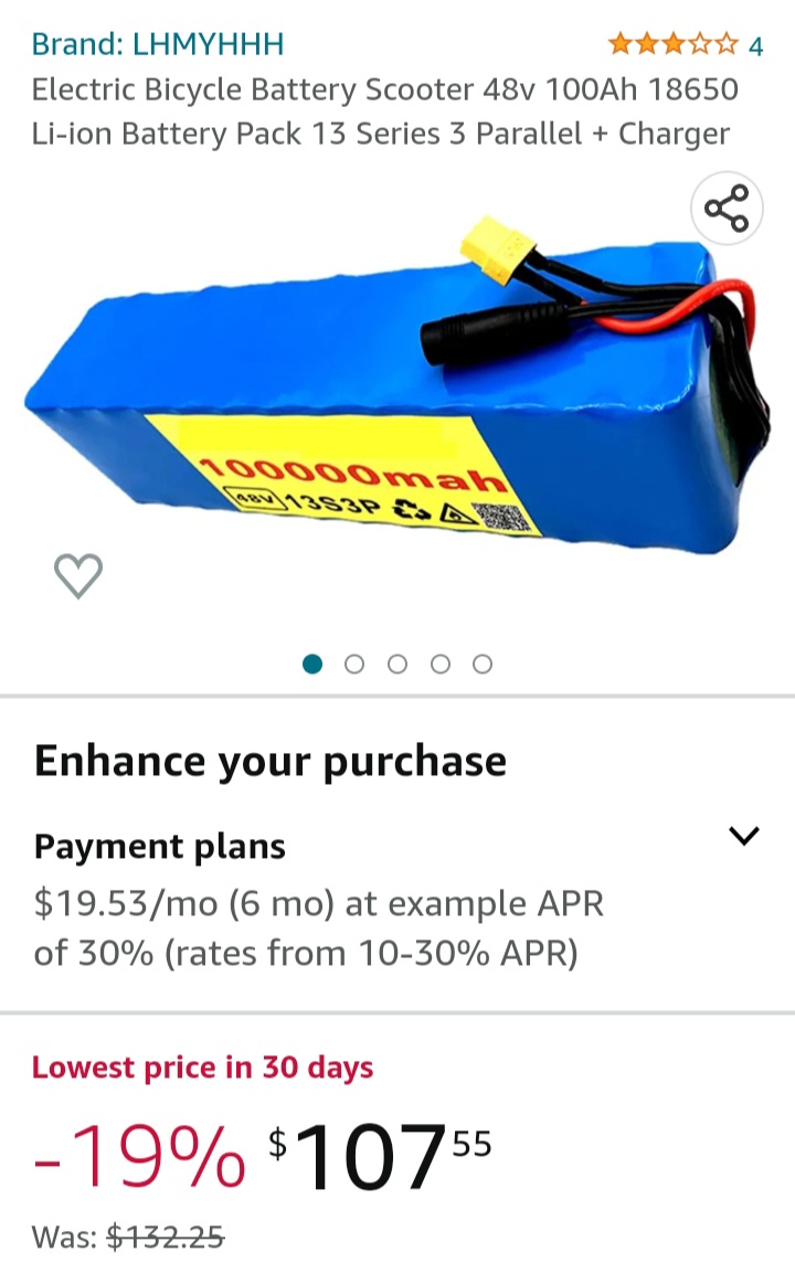

Here's an even better deal !!
48 volt 100 amp hours for $107 Canadian dollars!!! Lol
I'm sure that it's built with quality and safety in mind too !!!
I'm sure that it's built with quality and safety in mind too !!! Lol
