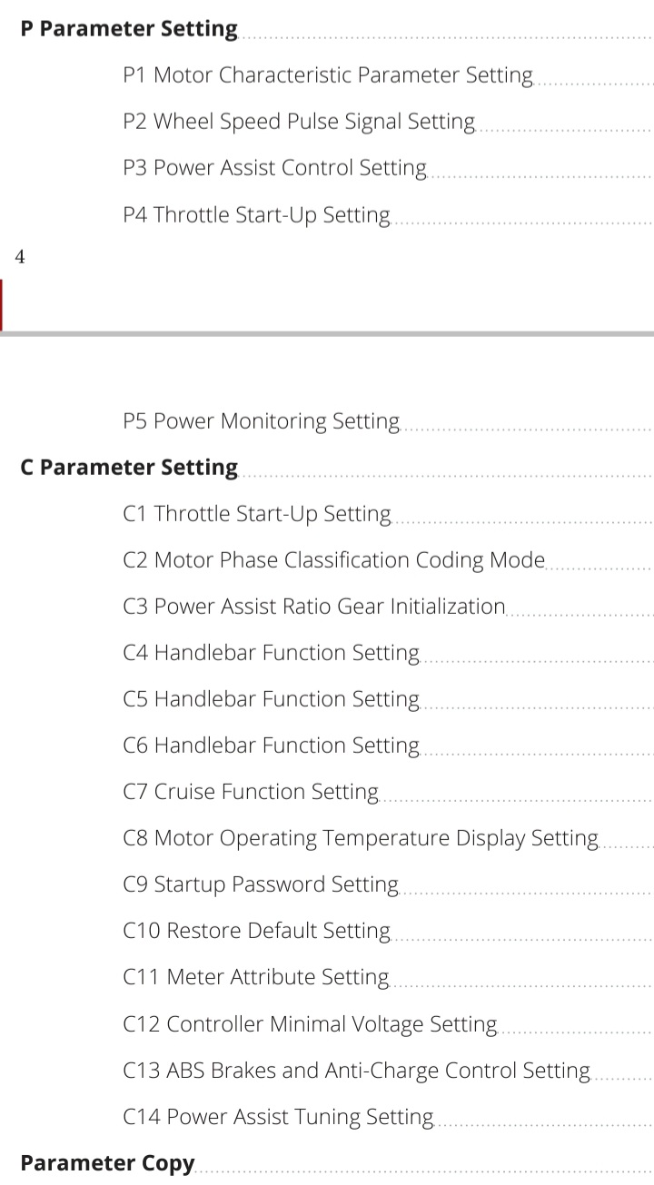

My controller allows me to set the low voltage cutoff point.
What do you suggest as a cut-off voltage?
I will have a second battery with me, so I don't mind if the battery cuts out early if there is any value in doing so.

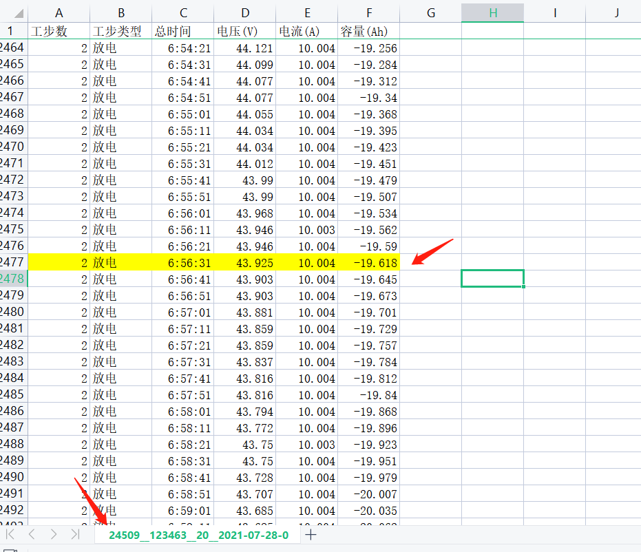

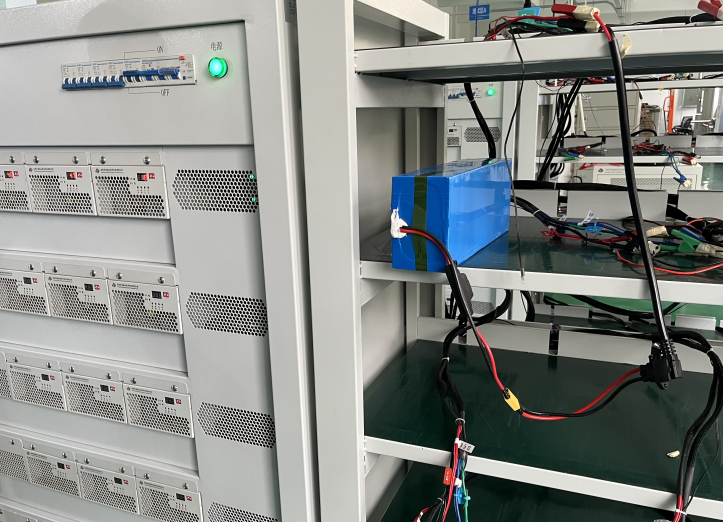

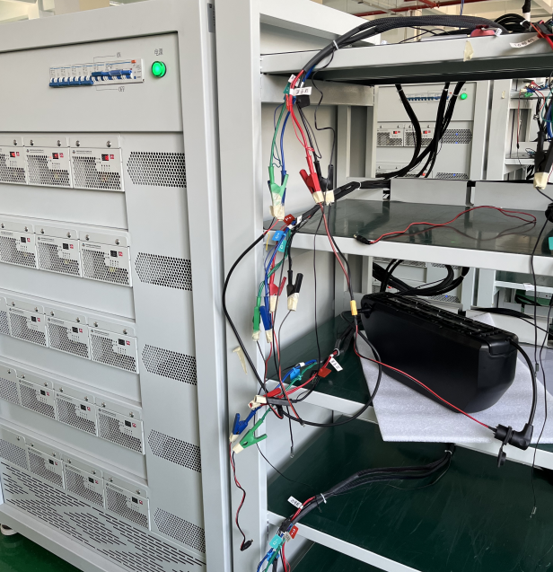

This is a Dorado 25Ah capacity testing , 24.5Ah tested, battery voltage is about 43.9V/44V when battery discharging 80%, 19.6Ah, with 20% left.
So you can set the controller cut off at about 44V.
The BMS itself cut off voltage is 35.75, cut off release votlage is about 39V.
Like most cell phones manul suggested, I believe using the lithium battery between 20%-80% is good for battery lifetime.

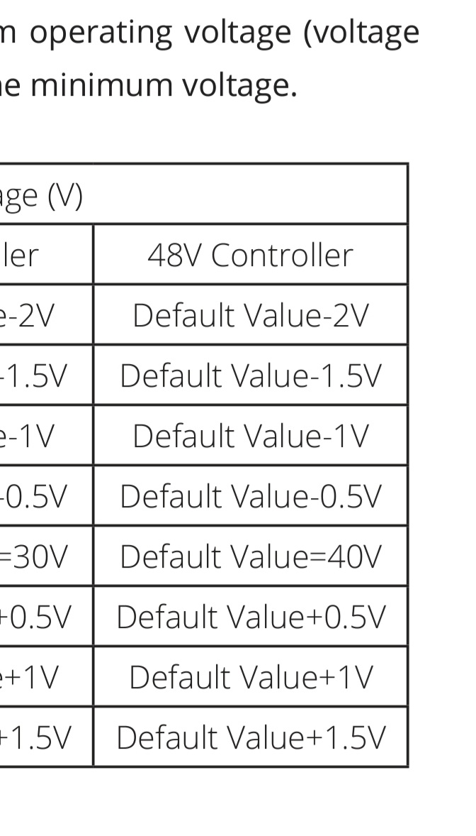

OK Thanks Jenny 😊
I will set my controller cut-off voltage to 41.5 volts (that is as high as I can set it).
That way the controller will cut out before the BMS if I do take the voltage down below ~44 volts.
I can always use my display to set the cutoff voltage lower in an emergency situation, to get the last bit of power out of the battery.
I better write down all my parameter settings and keep it on my ebike. There's a lot of them, and I'm sure that I will have lost or broken my smartphone when I really need it. 😂
