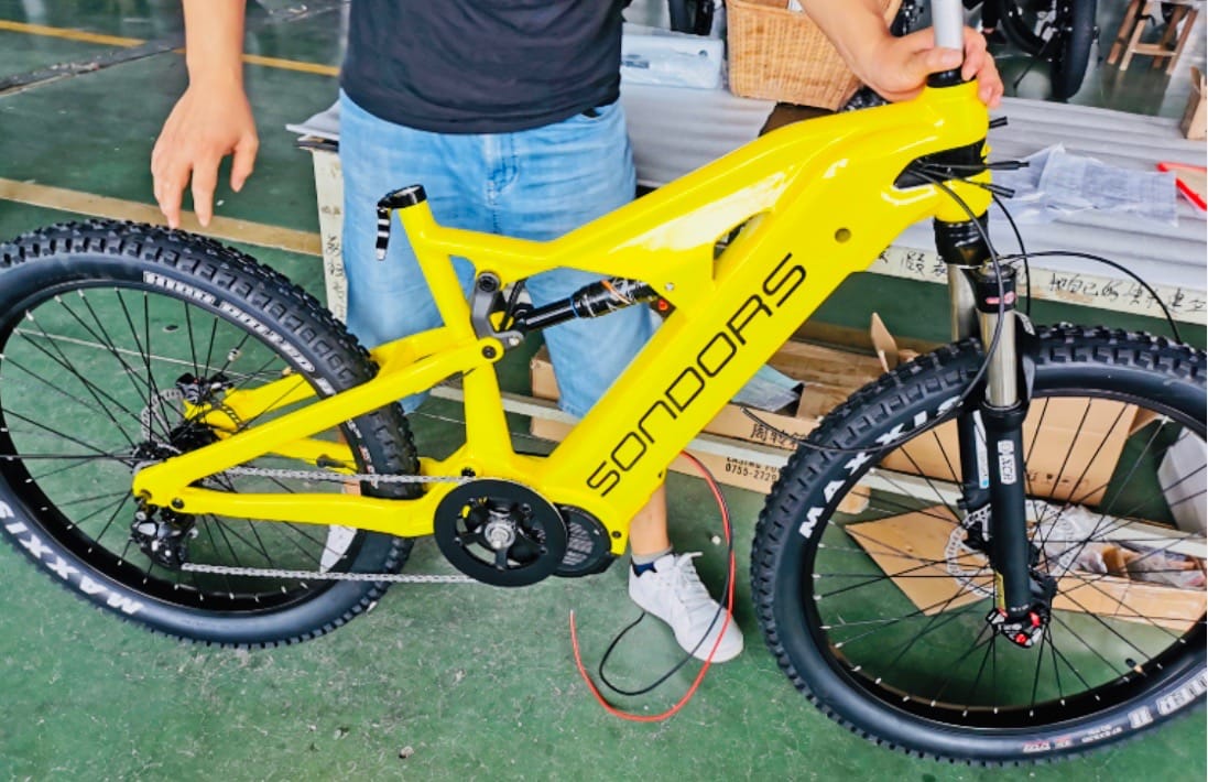

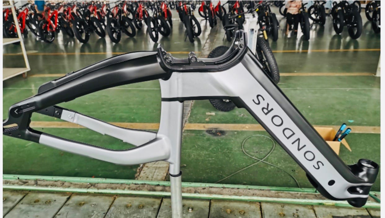

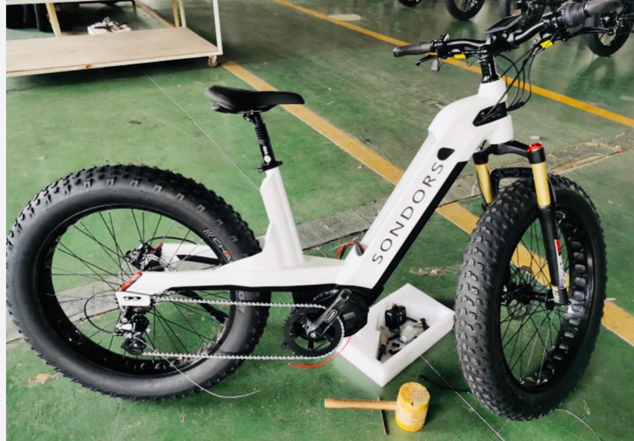

Some photos posted on Sondors Facebook page of new mid drive bikes at factory in China.
Both yellows look great to me. Seeing the actual bike is making me consider one but probably after more people actually get them.
