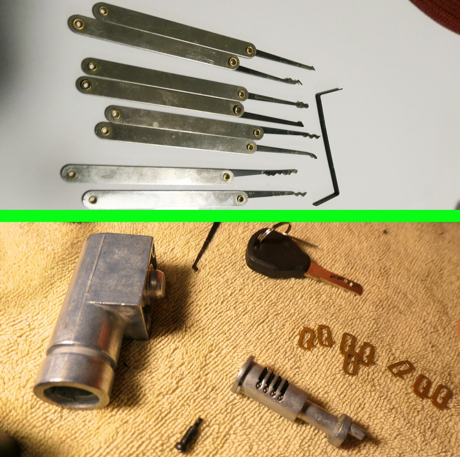

Well, with some fortitude, problem solved (no locksmith involved).
1. Bought a lockpick set for around $15 on Amazon.
2. Watched a few Youtube vids.
3. 20 minutes to fumble around picking the barrel lock.
4. Success! Then, removed the integrated battery!
5. Removed the lock assembly from the ebike (from inside the bike frame battery compartment).
6. Removed the core from the lock.
7. Removed the "wafers" from the core (the little metal rectangles in the pic which stick up out of the core and prevent the key from turning if it is the wrong one).
8. Using a key I had for another ebike (same model), fitted it into the core, replaced the "wafers" by shuffling them around at random until they mostly fit (flattened) with the wrong key, allowing the key to turn (mostly). Youtube told me this process is apparently called "re-keying."
9. Filed down a few edges on the wafers that were still sticking up and preventing the key from turning smoothy.
10. Success! Now it opens with the key that also opens the other bike. Two bikes, one key.
11. Send hate mail to the company who sold me an ebike without a damn key.
But no hate mail here! THANKS for everyone's suggestions!
Those look the same as the set I have,although I can't find them now, just like the lost keys that caused me to buy the picks in the first place. If I recall correctly I mostly used the second one from the bottom in your picture to rake the pins while turning the lock with the dedicated turning tool.
Good job!
You got all Lock Picking Lawyer on that battery lock and won! Nice outcome!
View attachment 167922Well, with some fortitude, problem solved (no locksmith involved).
