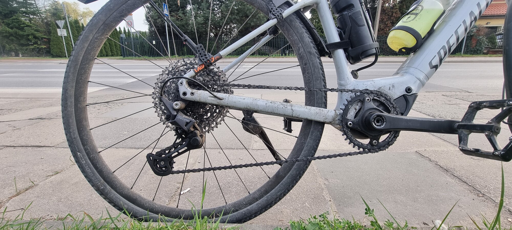

you'll see that most have chainrings larger than any of their stock cassette cogs
Most e-MTBs and gravel e-bikes have their chainrings smaller then their big cassette gears for the pure virtue of amplifying the torque at the rear wheel.
What can you see here?
You see big chainrings and smaller cassettes on your typical commuter mid-drive e-bikes for high speed as the sacrifice for their climbing capability. Still a good mid-drive e-bike will offset the gearing with its high peak power.
